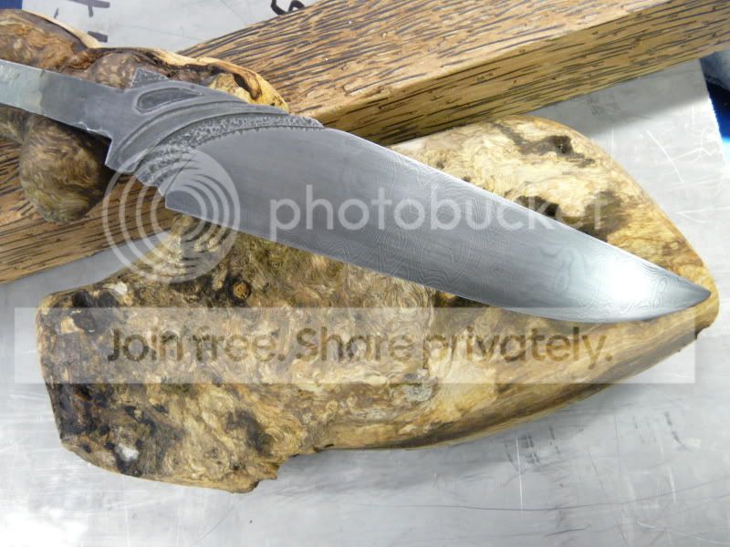

Unfortunately, i do not have a stamp or an etching machine. Mine will be carved into the spine somehow. I can still draw a few designs for it :) Ok, so i finally quit the burl hunting for a few days and got to get into the shop. It is still pretty rough, but i wanted to etch it to see if i was getting a good pattern in the carving or not....Don't laugh.

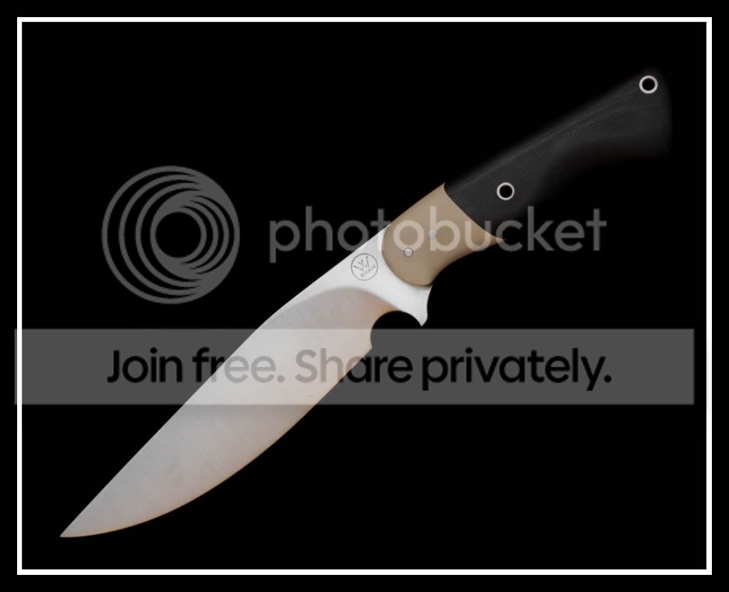

I have one almost finished up, needs final edge and a Sheath. I thought I would post a progress photo:
Nice work, Ryan; I can't believe you are already done! Great job on the sweeping plunge line, too.
What do you have planned for the sheath?
Mike, the engraving rocks!!! Looking forward to the finished product!
Thanks Paul I am going to go with Leather, I haven't taken on the kydex beast yet. We will see how it goes.
