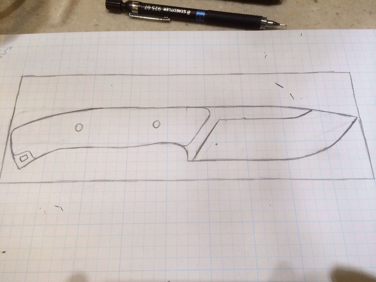

Ok on to number two. Going back to basics on form and ready for criticism.
I like the overall shape, though I'd probably round over the point at the lanyard hole just a little, and being a member of the "simple is usually better" club, I'd probably swap your square lanyard hole for a round one. That's more of a personal taste issue, however.
