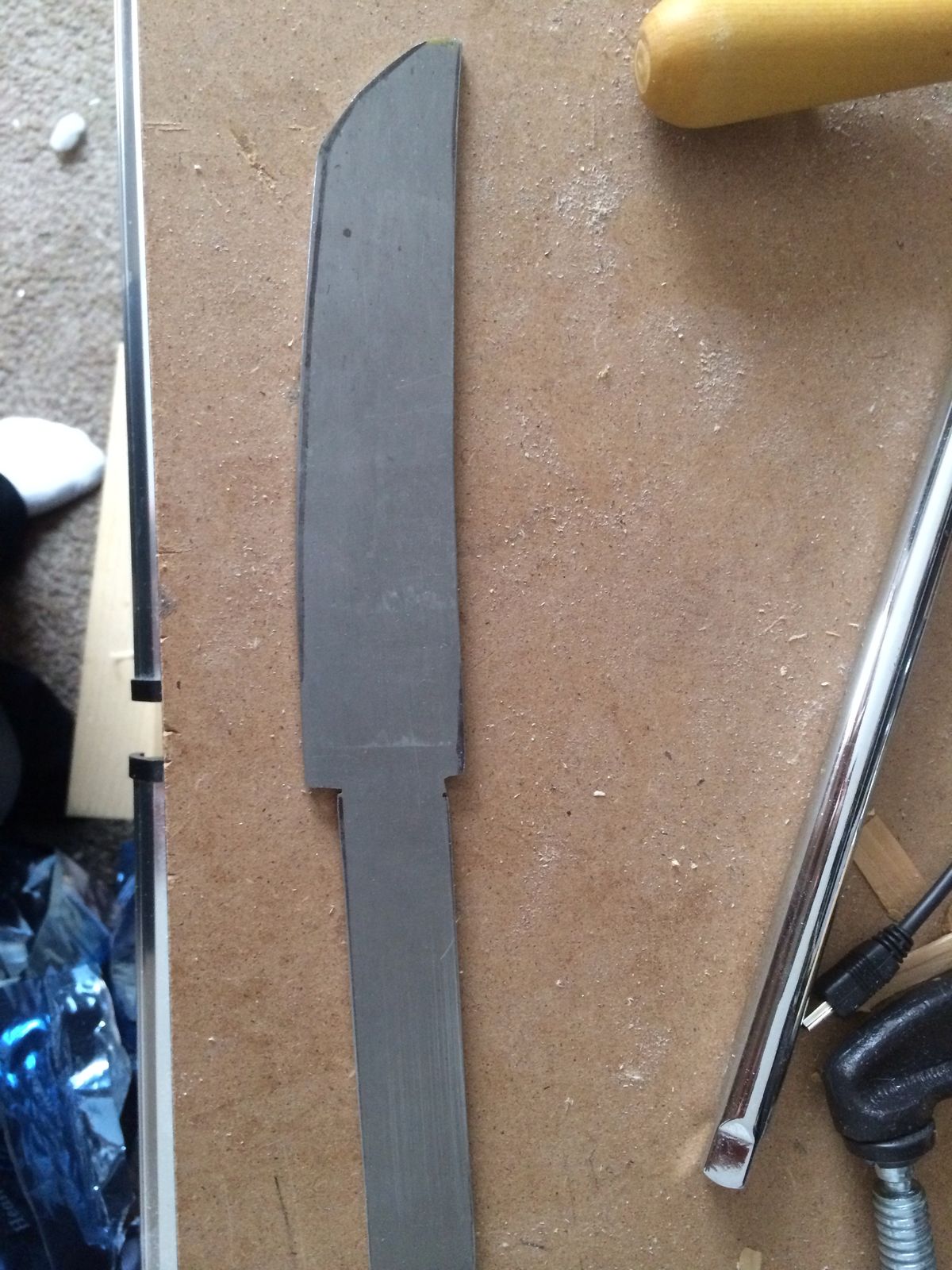

Should be done profiling the blade and have some kind of dent done in the edge by later today. I'll post a pic when I get there. Also is it possible to overheat the blade with hand tools? It's gotten a little warm and just want to make sure I'm not messing with the annealed state it's in before ht.
although I guess it could be possible I wouldn't worry about it. it still has to be heat treated after all.

Taking a break to run some errands I'll be bringing the handle down a little thinner to allow for a pinned hidden tang and fixing the curve of the blade a bit till I can't feel anymore bumps and it slides smooth.
Edit: doing it all by hand definitely gives a good feel for the progress and pressure but after this it's all power tools.
You might want to round out the transition between the tang and the ricasso, square corners lead to stress fractures...
Ditto.
Those overcuts into the tang and 90 degree angles will be places the blade can easily break. File the tang back to remove the overcuts, and try and made the transition from tang to shoulder rounded.

And to answer the other question. No, you can't overheat it and mess with the annealed state using hand tools. The steel would have to be red hot for you to be near any change in the steel. You ended up with 1095 right? To reach hardening temps (1475°f) it would take a friction saw, torch, plasma cutter or something similar. Even then, those tools will only cause the very edge of the cut to harden. Holes can still be drilled in the tang and so forth...
The thing we are really concerned with heat wise when using power tools is the post HT grinding. After HT it is possible to get into temps that will pooch your HT by getting hot enough to temper it back. After HT we are talking temps of 400-500° f instead of 1400°+. That is doable just by making repeated passes on a fast belt without cooling.

Thanks for the advice. Just rounded out that area now just working the handle flush then a few slight tweaks to the blades shape and it's edge time. And thanks for the heads up on the pferd file will definitely be picking one up, didn't know files went that coarse.

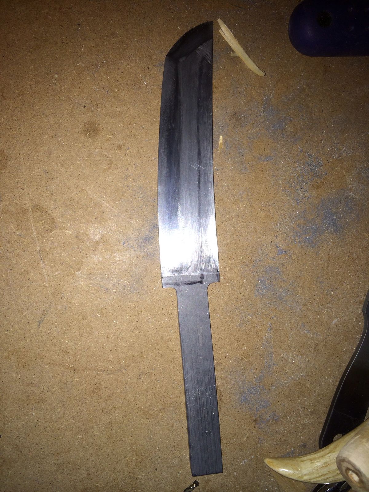

Finally started putting the blade on it before work today will post a picture when I get home and get the first side almost completely done. Since I'm a little short on funds I just used a sharpie on the soon to be cutting edge then ran it across the point of a 1/8" drill bit on one side, flipped and again on the second side. Hopefully I've been filing right I'm keeping the file almost flat to the blade as I work to give it a thin edge. I may have made the curve at the point the tang meets the blade a little too rounded but I'll let you guys bd the judge if that once I get a picture. Thanks as always

Looking good. Don't move your bevel back to the sharpie line, you want a little wiggle room ricasso wise.
The biggest thing is to make sure the shoulders are square with each other, and that they are perpendicular to the plane of the blade. In other words, the blade comes off the guard at this point, so you don't want it pointing in some weird angle that makes everything look like it's leaning.
The curves into the shoulder could be closed up some. They aren't bad right there, and can be worked into. You are going to be slowly fitting your guard anyway, and finally forcing it up onto the tang and square against those shoulders. The curve honestly doesn't need to be very large. You just don't want a 90 degree break there. I have a small needle file that I use to put the tiniest radius on 90 degree unions. It is simply a method to reduce stress risers.
Tapering your tang in both directions can make hogging out a hole to fit just a tad easier.
