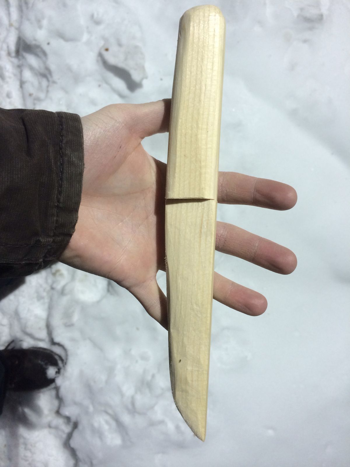

What about doing a more block like sheath out of wood with a nylon retaining strap to keep the blade in place when not in use? Two main reasons I'm wanting to stay away from leather and kydex is price and comfort of use for my knife. I can work wood like nothing and have messed around with a wood sheath for an old knife I had. That and I know it's ridiculous but I am extremely OCD about my outer gear matching color wise and know if I made it out of leather I'd probably leave it at home. Another question about the hidden tang. Are you talking about a more pin like handle or just slimming up the original design to allow more wood around the edges but still pin it? Thank you again for the advice bladsmth.

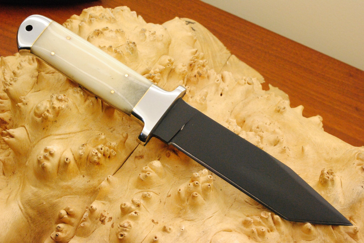

This is the shape for a quasi-tanto that would work well as a fighter or edc type blade IMHO. Look at the blade shape, and disregard the bolsters and handle a bit. They look great but for EDC purposes would get in the way a bit I think. For a pure fighter this is an excellent design.
I see what your saying with the leather. My only thought is wood seems a little easier to work to me. And yeah for the camp knife I'm thinking along the lines of the one you posted still keeping the design of the original somewhat but making it a little wider and aiming for 8-10 range. Might end up making the blade flat for the most part as it will just end up as a wood splitter for the most part. Figuring a light weight saw would be my best bet for cutting in the woods. I think the biggest help would be more so why not to go with wood.

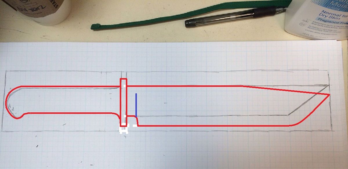

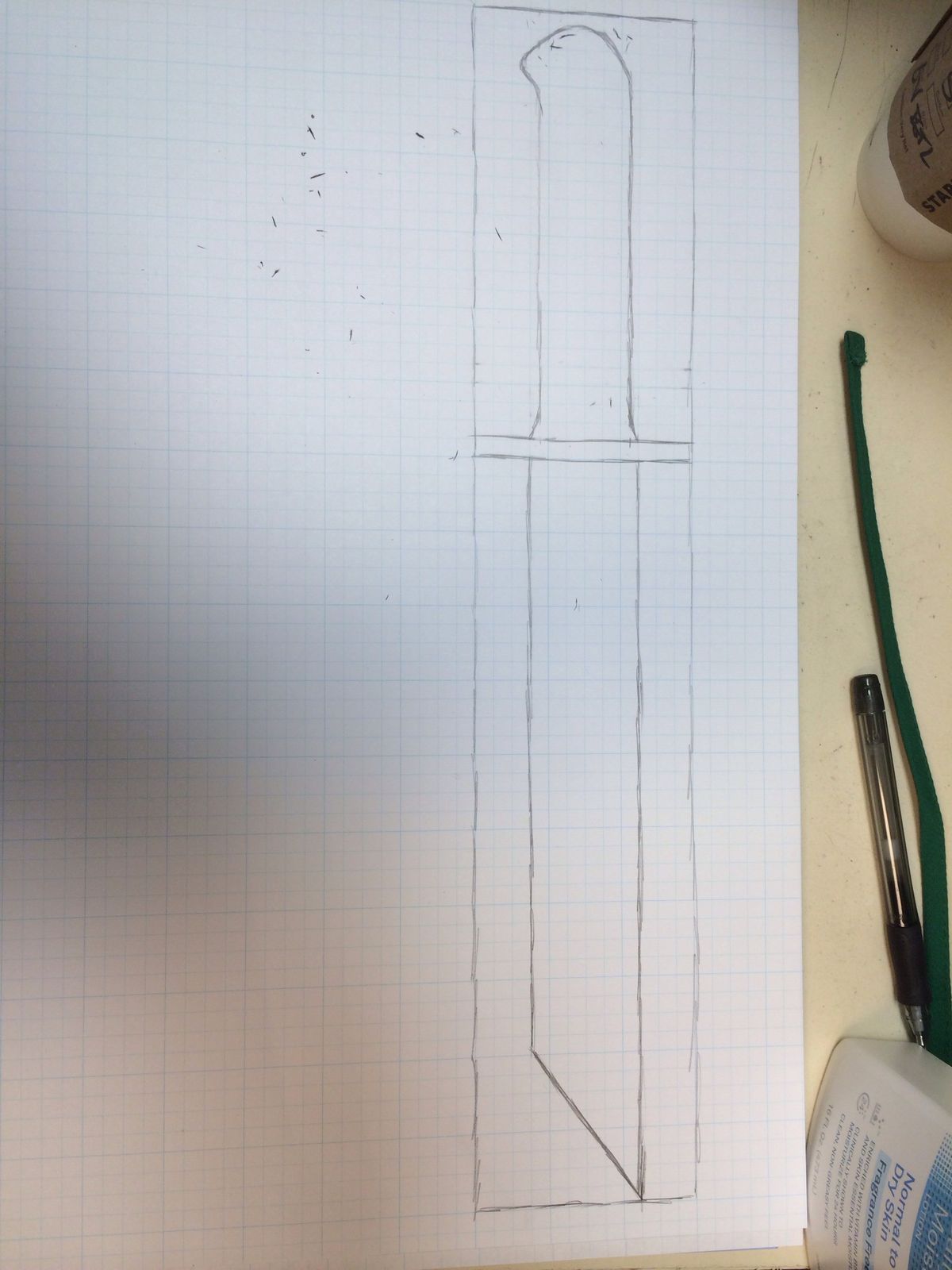

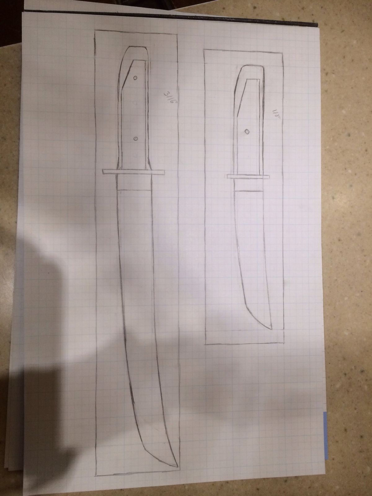

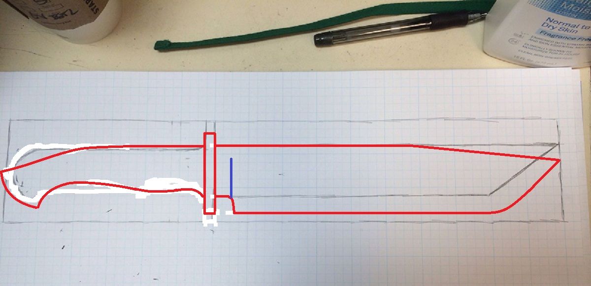

Steel will be here tomorrow so it's time for a last poll. I will be doing the smaller knife from beginning to ht before I start the second one so I'm not sending out twice. First picture is the mock up for the small one, the second right is the same one but with the curve extended upward a little more. The second left is the match to the utility just a bit bigger to allow for splitting and the final picture is the chopper/camp knife with a straight blade. Thanks again guys
and any tweaks to improve a design are more than welcome :smile:
For a camp/outdoor type knife, I like a wide blade with a long, as close to full as possible, flat grind. Usually I am near 1.5" in width on that sort of knife. It allows the spine to remain thick, while still having a slicer of a thin edge. If using for any food prep, it works a lot like a kitchen knife. If pressed into skinning or filleting fish, the thin edge glides between layers. Width can allow you to scoop with the blade as well, whatever material you are cutting...
Since you are going with a tanto profile, I made the following changes. I hope you don't mind. With this, the bevels would begin on the front edge of the ricasso where the blue line is. This allows the blade to be used on a flat surface, as well as not degrading past the lower line of the ricasso after repeated sharpening. I shortened the guard, as a long guard looks great and has a place on a dedicated fighter, but just gets in the way on any knife that will be used a lot. If it is left at, or preferably higher than the blade edge, it again facilitates the blade being used on a flat surface. With a long flat edge like that, making any long straight cut is as easy as setting the blade down and dragging along the line of the edge. I also made the level of the backstrap and the top of the blade the same. This is just an aesthetics thing with me, whether hidden tang or full, I prefer if they match... With a bit of a clip point it reduces the amount of flat you have at the front of the blade. A long flat nose, even when at an angle and coming to a tip, is fairly useless IMHO. A bit of belly, (the curved Japanese style of tanto etc) I find far more useful for making cuts than a long flat. It allows pressure to be concentrated on one spot, rather than spread out. Any curve in a blade allows the cut to have some lateral pressure as well as direct pressure to make the cut. Thus, the blade goes through the material in a progressive manner, rather than all at once. In other words, it cuts faster and smoother. A bit of point never hurt either, just in case the occasional feral pig decides to visit your shins... :)
Please excuse the crudeness, and the rather odd butt on the knife. MS paint wasn't cooperating with me this evening...

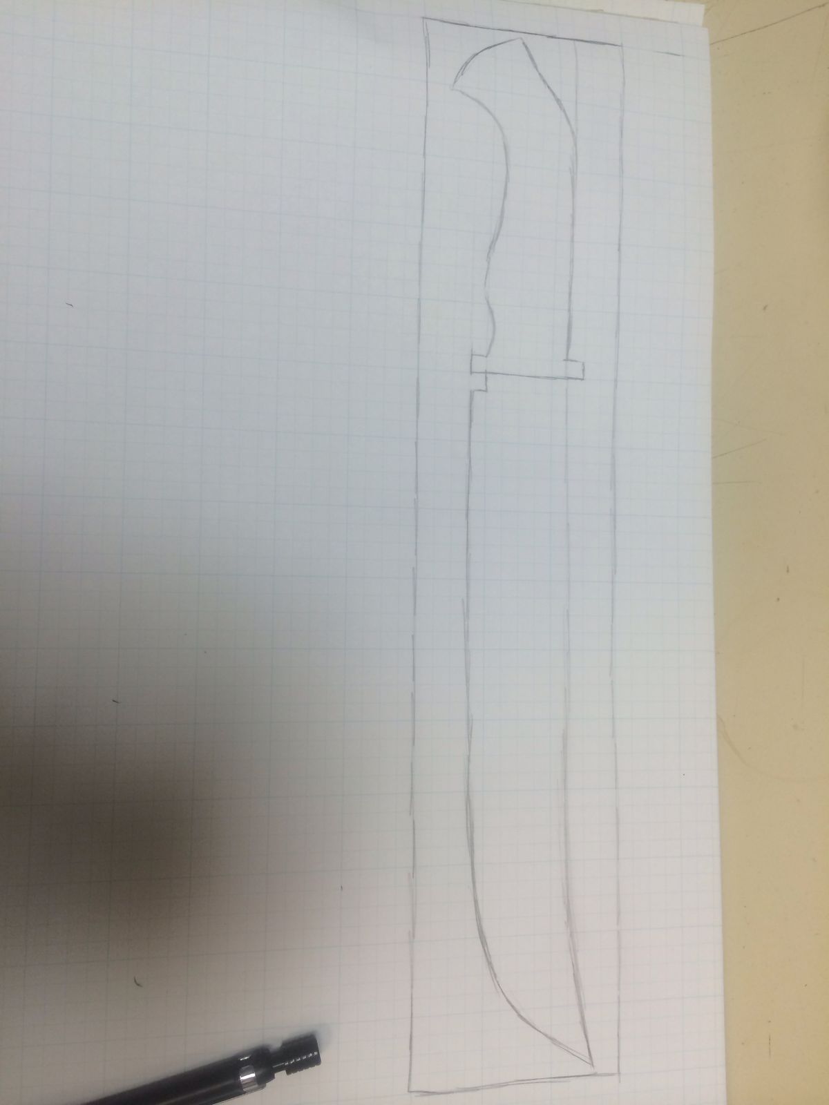

Now, bear with me on this... It is a bit odd... But I would truly like to see something like this below. I can't quite get the curves on the finger side of the handle right with MS Paint, but just imagine a more classic bowie style handle. Flared at the rear, thin near the ring and pinky fingers, wide on the middle finger and flat sided into the guard with just enough curve for the forefinger to sit in. I don't know that I have seen a larger tanto style blade with this ricasso to blade, guard and handle treatment. It is leaning into more of a classic fighter than a camp knife, but I still think it could be cool. If you don't go that way, I might just steal it if that's ok...

So if I'm understanding you correctly the curve of the mockup is what I should aim for on the chopper as well? Sorry if that's not what you meant I think I'm hitting my overload point trying to absorb everything I'm learning and design the blade lol:hypnotysed::hypnotysed:

What about something like this? To still kind of keep with the matched idea. Or taking the original match and giving it the more Bowie handle?
. Or I've completely lost it and should take a break from this for a couple days.
If you continued the curve as a gentle long curve along the length of the blade rather than just the tip that would look pretty darn cool. As for usefulness in the woods, I honestly don't know. The only blade I've had in the woods rhat had any kinda back sweep to it was a fillet knife. It looks like it would work pretty well...

My only concern with the curve is if battoning would put uneven pressure on it and snap it.
Edit: back to the drawing board.

Don't worry about the curvature and tip when it comes to batoning. Steel is much stronger than we give it credit for. Go for a full HT, and temper a little high and it will be plenty strong.
