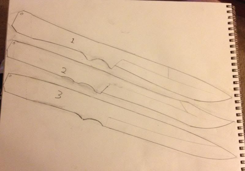

Hey fellow (i hope to be a fellow) knife makers.
well i am just starting getting into this and have read and watched a ton. it doesnt seem too hard, but i just wanted to post a couple ideas of mine. i am not a slouch when it comes to working things by hand. i have been brazing and soldering my hole life, and building custom remote control scale trucks for years. so most metal work is easy to me when it comes to a grinder, file, and hacksaw. just havent had much experience heat treating and such.
I am planning to make a knife file out of an old file i found in my poppop's tool box. it says "gold Medal USA" stamped into the handle. and i am not sure of what type of metal it is. but it will at least give me a solid practice knife for my first go around. its around 12" useable surface area. and about 1 3/16" in width. it should make a really good base. i have been drawing some designs tonight. but wanted some opinions on my designs.
so actually gonna be using some 1084 now.

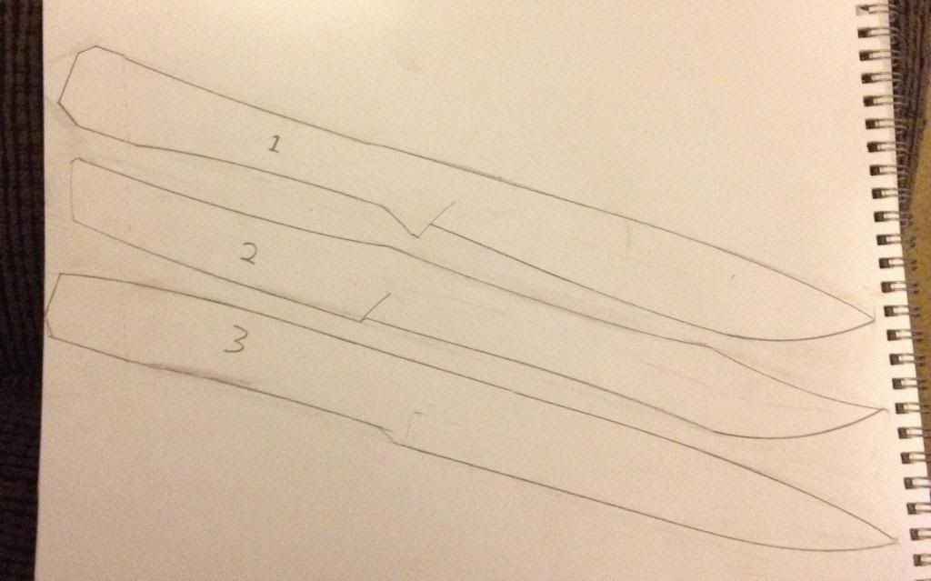

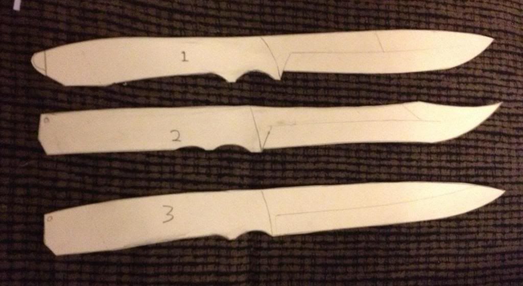

let me know what you guys think on them. personally i like #1 the most. but am open to you opinions. you can also notice the change from finger grooves from one pic to the next. let me know what you think. and just cuz i'm new to this forum, please dont think i am a newbie. been around the interwebs for a long time and just looking for some good ole good guy advice here.
#3....but you will be FAR better off buying a piece of 1084. That file can be used to file the knife to shape.
#1 and #2 are not good shapes.
I would suggest you round off the butt of #3, as there is no good reason to have the sharp corners. They won't be hand friendly.

thanks for the pointers.
ok, so blade three would is the best design. the corners can easily be rounded on the pommel as well.

I think knife #1 will look good, too, if you turn the handle down into a curve like knife 3. Maybe pull the edge down near the ricasso, or make it a recurve so it lines up visually with the handle once it's curved.
thanks man. i was thinking the same thing. i could get rid of that unsightly hard corner, and just fillet the blade edge to the ricasso. i think with that being the case #1 would have the strength of #3, but just have a slightly better drop point. i just kinda dig the leaf/spear tip shape of #1
