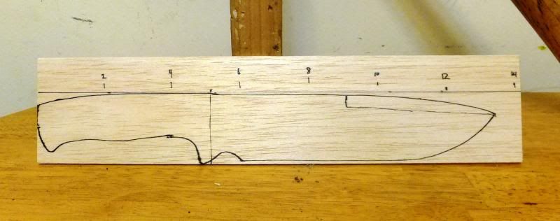

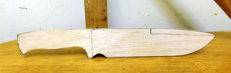

hey guys, heres a sketch for a balsa wood prototype. dont get too wound up on the details for the ricaso area. i am still figuring that out. but this is at least a small brainstorm.
its a rough shape. the handle could use a little bit of refining too. looks a little too beefy. and the whole thing looks like a kitchen knife, which i wasnt really going for either. ugh.
HELP

got it cut out. still a little worries about the spine near the hilt/shoulder area. and the ricasso.
but here it a first draft balsa wood prototype.

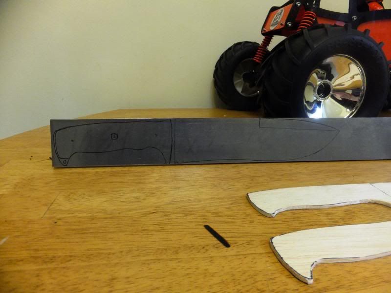

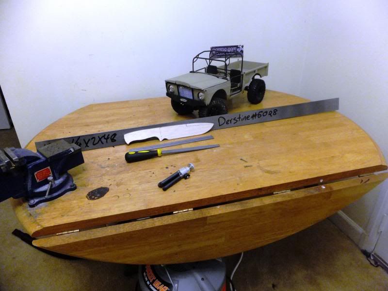

got my steel. need my new file. gonna start drawing on this stuff tonight. sharpie is gonna get worn out.
sorry. little excited here.
Man, it's good to see someone else filing away on an old table in a spare room, on carpet, no less. :D Nice Jeep, btw. :thumbup: Knife on.
Man, it's good to see someone else filing away on an old table in a spare room, on carpet, no less. :D Nice truck, btw. :thumbup: Knife on.

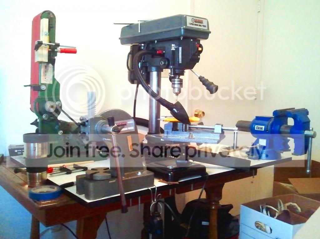

heck yeah man. funny thing. i live in a condo here in Arlington VA. bout 3 miles from the pentagon. anyway...
i have a drill press just like that in my bedroom, a bench grinder in the closet i take out when i need it. and i am debating on wether or not to bite the bullet and the the Grizzly Knife Belt Sander. would love to have something like that!, but would have to put it on the balcony when i use it.
anyway. i cut metal, braze, solder, paint, screw, drill, saw, file... just about everything. i make Custom remote control scale trucks for my other hobby. they take about 6 months to get one done, so i am thinking a knife, done right, will take about the same amount of time.

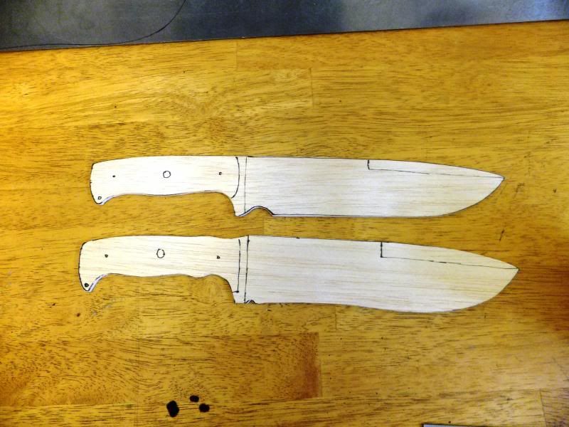

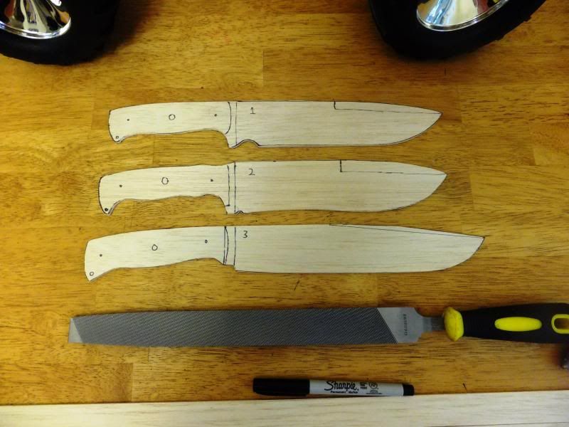

Overall, pretty good.
I think the top knife has too big of a choil, but the basic shape and lines are good. The bottom of the ricasso should not drop lower than the blade edge.
The bottom one isn't my thing, with that recurve, but if you like the look, it seems fine....except the handle. Take the bump out of the top, the extra finger groove out of the bottom, and make the handle look like the first one.
If yo move the choil back a tad, where it is bisected by the plunge line, it will look and work better.
thanks for the pointers stacey. your help has been
thanks for the pointers stacey. your help is greatly appreciated. I will make some modifications to the templates tomorrow. overall i think both blades are a little tall from edge to spine, but i can reduce that some. i'll take some material off with the sanding block and see how it looks.
that ricasso and choil area of the first one really doesnt look good at all. i need to do a little work there.
the humps in the handle on the second dont line up too well with what i had drawn originally on the paper template. i either cut them a little off, or it just didnt translate well. going back to the drawing board for the handle. i think since the first handle looks and feels pretty good i'll stick with that design for both of them.

time to start cutting. drew a 3rd design. more of a bowie style, and not such a tall blade.

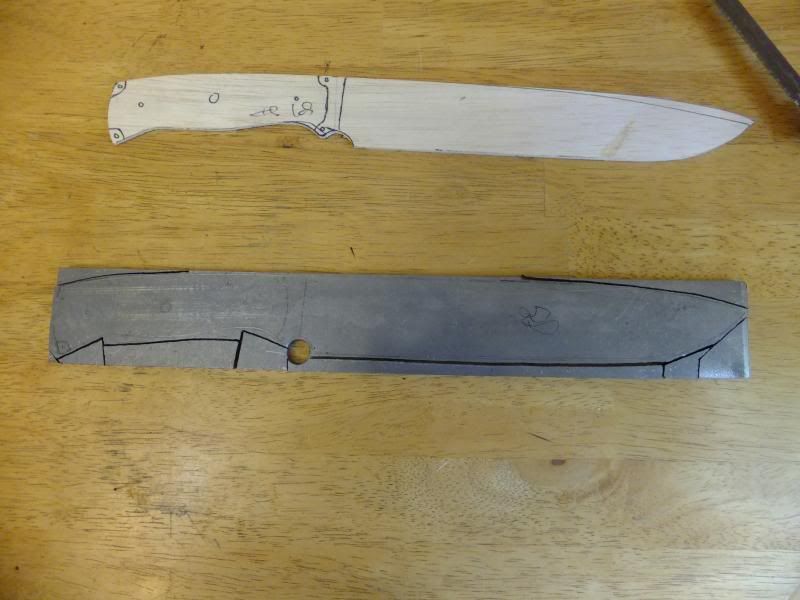

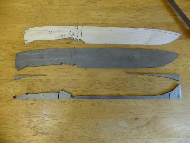

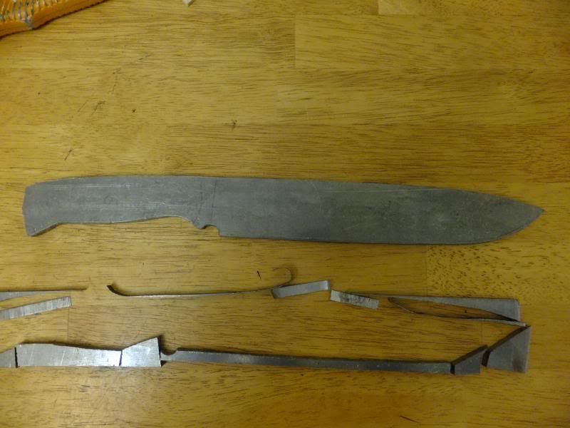

after a week of vacation and thinking about what to do i decided to simplify the design a little. got the basic shape hacksawed up, and time to start filing the basic shape. lots of work left to do.
getting closer. just need to to tidy some things up on the finger side of the handle. and also on the pommel area. then just drill the holes for a lanyard and the scales, and its ready to start taking some edge.

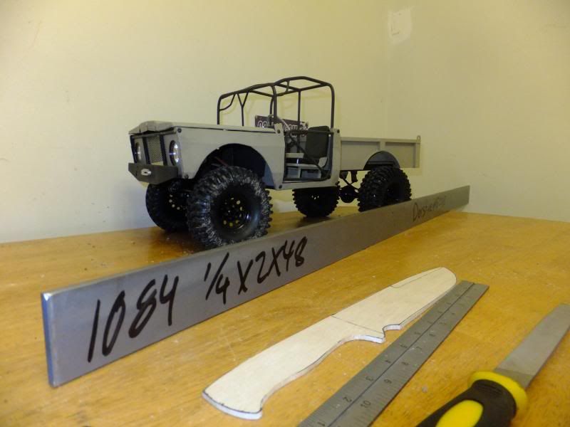

Man 1/4" is pretty thick, guess you got determination knocked out. Just curious any reason you went with such thick stock.
