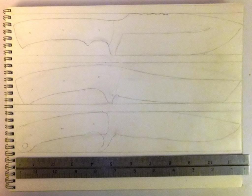

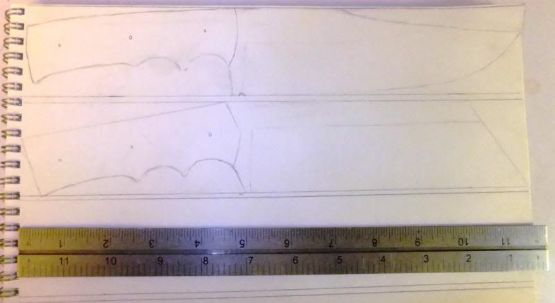

out of these 5 which do you think would be best to start with for him? gonna be doing it by hand, but i do have enough files around to get the job done. hope you guys have some opinions for me. i know sketches arent that cool to look at!
oh and the length of these is around 11.5" but i can make any length i want. however the height is fixed at the 2" that i drew for guide lines for each sketch. if you have ideas on stretching a certain aspect of something i am open to hear them.
#3 is the one that will work best as a knife.
#4's blade would work, but won't be hand friendly.
The others are terrible.
On #3, you need to get rid of that talon sticking out from the blade. Just bring the bottom straight forward from the handle scale to the choil. Deepen the finger notch just a bit and bring it back in a smooth curve to make a slight palm swell.
thanks for the insight man. i like the curt response. makes it easier to understand.
def. gotta KISS this time around.

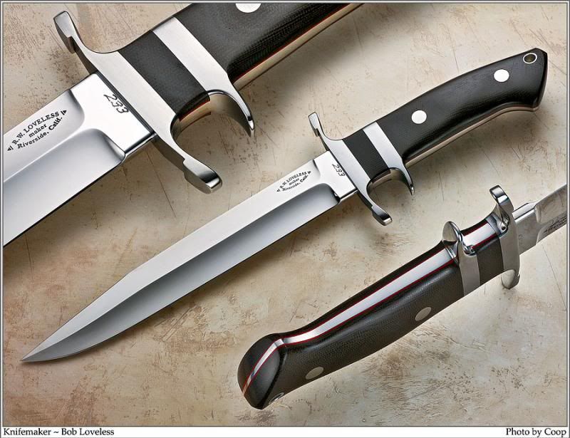

Hey Chris,
thanks for this advice. to tell the truth i have been looking at knives and getting ideas from the ones that i like. I am def gonna keep this simple. I am just gonna use some easy scales for the handle, no real hilt or anything either. a nice flat grind from hand should do the trick as well. Something like these two are pretty much what i am looking for. maybe the blade from this knife first and a handle made of some sandwiched micarta or kirinite. anyway. i should have the 1084 in hand Tuesday, so i can start planning the first cuts.
Holy Cow!, you really must hate yourself. To attempt a double hollow ground Loveless sub-hilt fighter without a lot of experience and some pretty sophisticated equipment is a fools errand.
I would guess that 95% of the guys on this forum would run from such a task. and probably only 1% of them could pull it off with any real success.
If you like a Loveless knife, how about a small, simple, and thin one first?
Stacy Sir, I think perhaps you didnt read my post clearly. or maybe i didnt write it clearly, which is probably the case. Or I am not quite familiar with your sense of humor. (probably the case) Of course i am not going to attempt a double hollow ground Loveless sub-hilt fighter. But i love the profile of the blade.

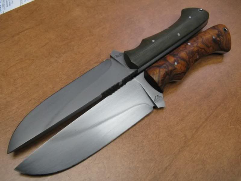

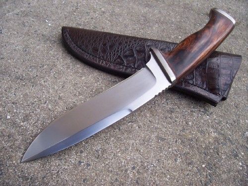

so here are some more ideas that i really like. and these have at least what i can tell a single bevel.
and just want to say props to the makers of these knives. i hope they dont mind me getting some ideas.
the first one has a pretty complicated butt, and hilt area. however i dig the curve and the bevel on the spine
i like the second from the top here. but probably mady longer like the top one. also looks like a simple handle i could get close to with scales
these two just look awesome. kinda almost the exact look i am going for here. even has the handle scales. just pretty sure i can't do the thumb grip on the spine
I'm usually not a fan of these big choppers, but those two mirrored like that, are striking.
Who is the maker?
i like that one. i'd have to order some 1/8" 1084 from somewhere. an NJsteelbaron is all out of that right now. where else has it in stock?
Who is the maker?
the last pic? yeah they are pretty sweet. i actually cant remember where i found the pic now... anyone else know?
