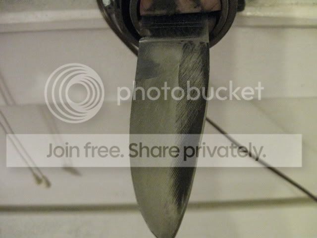

One thing I noticed is that, as drawn, you have a lot of blade ABOVE the tang. Looking around at the various pictures on this site, I'm seeing most stick tang knives have very little of the blade above the handle.
Figure that you're finished handle is probably about 1.250" in diameter at the hilt. That means you would have approximately .625" sticking above the center-line of the tang. Will that look "right"?

Don't fret. It might just be the angle of the photos, or seeing my gaff in your work.
What I was trying to say is that you need to pay attention to the distance from the spine of the blade to the center-line of the tang. While you don't want a skinny tang butting up to a fat blade for the sake of strength, you also want to make sure that the handle material is sufficiently large enough in diameter to fill the distance between the two parts of the blade.
Does that make sense? In other words, you can grind the antler down to size, but you can't grind it up to size! :D
I think what VaughnT is trying to say is that it looks like the base of your blade is going to be wider than the end of the grip which will be fitted up against it. If this is the case you want the grip to be offset so that it fits flush or nearly so on the spine side and the edge side of the blade stands proud of it. To do this you want the stick tang offset towards the spine.
If the blade is wider than the forward end of the grip and grip is centered it never looks right, this is a common mistake that beginners make on stick tang knives. I have done it myself.

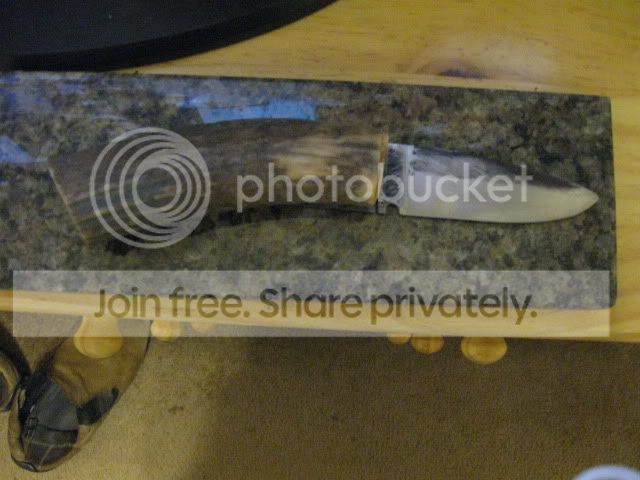

I haven't done any filing yet today, but here are a couple of pictures of the knife with the stag handle. It seems that the stag thickness seems to be the same as that of the blade.
Hey Fletch,
Do you think that this handle matches size wise pretty well with the blade? I rely on you to be honest and frank like in the past, so tell me what you think.

I'm always ready to offer an unsolicited (but constructive, I hope) opinion. If it were my project, I would really consider saving that nice piece of stag for my second knife and going a different route for this one.
The handle is way too big, in my opinion. You've got plenty of tang to do a nice wooden handle--either hidden or full tang and still have it come out looking nice. It's the perfect size for a neck or EDC knife.
I still want to put a guard on it though and the more I think about it, the more I think you might be right. I just need to figure out how I'm going to incorporate a guard and a handle with scales or a block.

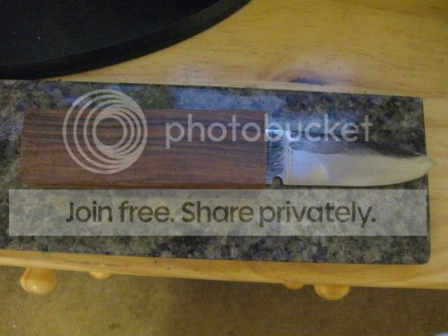

How about using this fine piece of wood for the handle instead of the stag?
One possibility is to cut the tang down a bit, but leave it wider than you were going to. That will let you slide a guard over it and let it butt up against the ricasso like you want.
Then you can do a rabbet tang--take two slabs and route out a space for the tang--one half the thickness from each slab. Sand them perfectly flat and epoxy and pin them together. I am doing a re-handle on a Cold Steel Trailmaster this way right now.
You beat me to the post--that is EXACTLY what I'm talking about--I think that looks much nicer and in proportion.
I still have to extend the tang though, it comes up short on the back end. Should I still do what you explained in the above post with this block?
