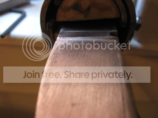

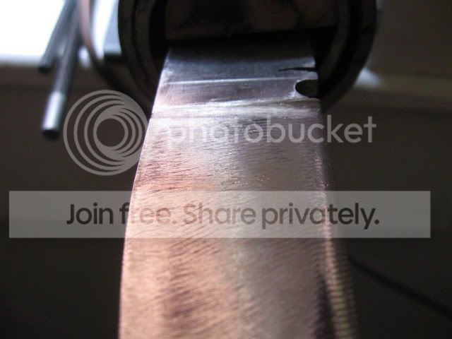

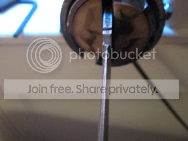

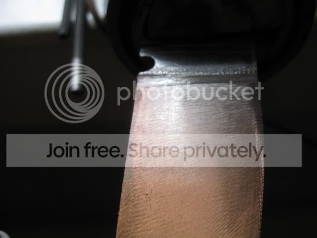

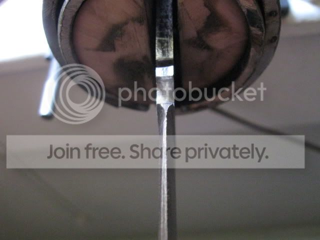

Okay I have issue's!!! Besides my personal one's I mean. I'm afraid my plunge cut's are going awry because I have no file guide anymore. I am also worried about how thin the metal is where the plunge cuts meet. Am I alright the way I'm going or is there something I need to do to avert going beyond a recoverable situation? Advise me please:D:D:D Pics below:

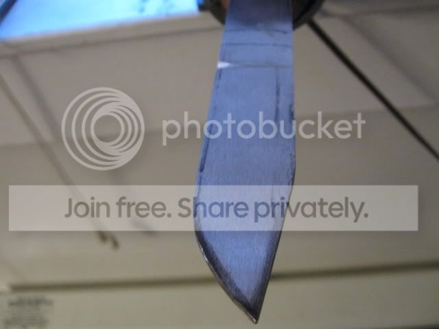

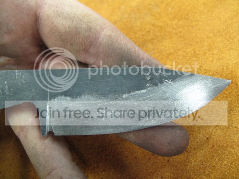

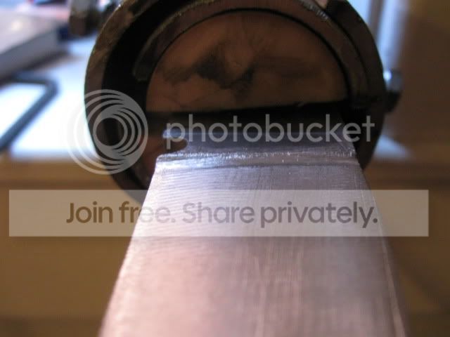

After a total of 4 hours today, starting at 9 this morning, I think I might have put a little dent in the convex areas of the blade. The metal where the plunges meet is getting a little too thin. I also think without a file guide, I may have hosed up the symmetry of the plunge lines. I was hoping to get a few opinions on where I stand. Here are the pics of where I'm at as of 1344 EST. Thank you Everyone for your input and advice and just for viewing!!!
Jeff
If you get a little too thin in the edge you can always file/sand it down a bit.I don't understand how you got teh metal so thin at the plunge area and nowhere else on the edge. Were you just doing the plunge independently from the rest of the blade? You want to try and do everything as equal as possible whenever your doing anything. Sand one spot too much and you'll get a low spot which you'll pull your hair out trying to even out, same applies to filing only you're removing even more metal. At some point you're going to have to try and get the rest of the blade as thin as the plunge area. Not sure what the best way to go about that is. I'm guessing you can get the rest of the blade that thin then file the edge down a bit to thicken it up. Or I guess you can thicken it all up now and go from there. At some point you have to try and the thickness of the edge fairly uniform regardless.
Hopefully someone with a bit more experience than me will chime in here on the best course of action from here.

Jeff, what did you fail at? Did you throw the blank away?
From the looks of the pic, your plunge line was a bit forward of the notch thing where the edge stops and the ricasso starts. A whole lot of knives have the plunge line bisecting this notch, and it looks good, so you have a ton of room to move the plunge line back. Saves the whole piece.
As for plunging all the way to the spine, I wouldn't worry too much about that. I did the same thing to my first and second and third blades, but it all worked out when I sanded the ricasso flat. Completely eliminated the upper end of the plunge cut, giving me something of a professional look.

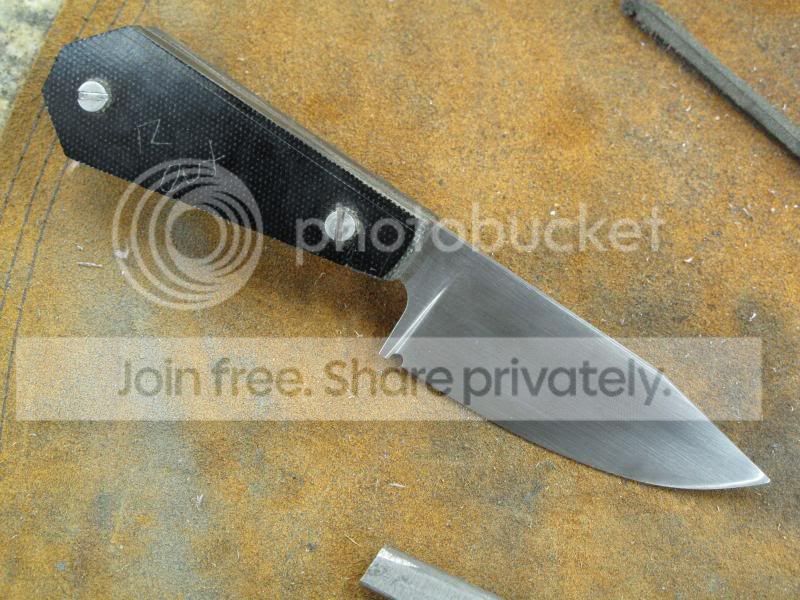

The scratch line on this blade (below) was soon followed by a small file. Big mistake, I thought, but I kept going figuring I would at least learn a bit from the whole mess. Turned out alright, in the end, though.

No, I didn't throw the blank away, I put too many hours into it. Right now, the issue with the plunge line is that there is a razor of metal where both plunges meet. The way it sits now, it's not recoverable. I talked to BillT last night and he thought that I could cut out a semi-circle in the chiol area, where the plunges meet, and that could get me back to a decent thickness to rework. I think it was the fact that I ground away 3 day's of work because my plunge hit the spine and then found no metal to work with that got me frustrated enough to not even think outside the box. The next day is a new day, and I'm going to take a few to think this through. I would really like to get a file guide before I start again, because even with the new knife, I started going off the reservation rather quickly, but stopped before I hit another crisis.

I have tried to do plunges with a chainsaw file, and have had more failure than success. I managed to save them in some instances but the only way I get decent results with this method is to do it before I have started the bevels.
That thing I showed you with the granite I think would have worked better in your situation because you already had the bevels done, trying to use a file at that point is much more difficult because you only have the one side of the cut to guide you. The trick to using a chainsaw file is to cut the plunge before you have started the bevels, that way you have metal on both sides of the cut to keep your file straight. If you do it this way and are careful you should have enough control to get decent plunges without even using a guide, once you have enough of a groove cut this will guide the file. The hard part then is trying to keep the same angle so that the bottom of the cut stays flat, and a file guide can't help you with this anyway. The trouble with doing it this way is that after you get the plunges done, you have to worry about keeping your square-edged file off of them while you do the bevels. All in all I have found the granite-lapping method to be the easiest and most consistent. I do the bevels and just get the plunges as straight as I can, leaving them square-edged from the grinder (or file, in your case). I leave them about 1/16" further away from the ricasso area than I want them to be when finished. Then once the bevels are 95% done, I do like I showed you in the pics I emailed. If you have your bevels nice and flat and have something to guide you along the edge of the granite it works like a charm.
Since you were doing well on this one until you got to the plunges I would humbly suggest that you experiment and practice on this blade a little more, so you have a better idea what to do on the next one.

The blade you're working on is just calling for a similar treatment. File down a bit on the ricasso and you'll see that plunge line smooth out and start looking entirely too sexy for its own good.
