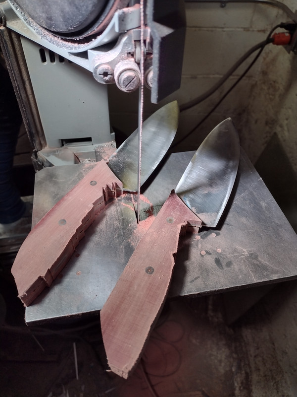

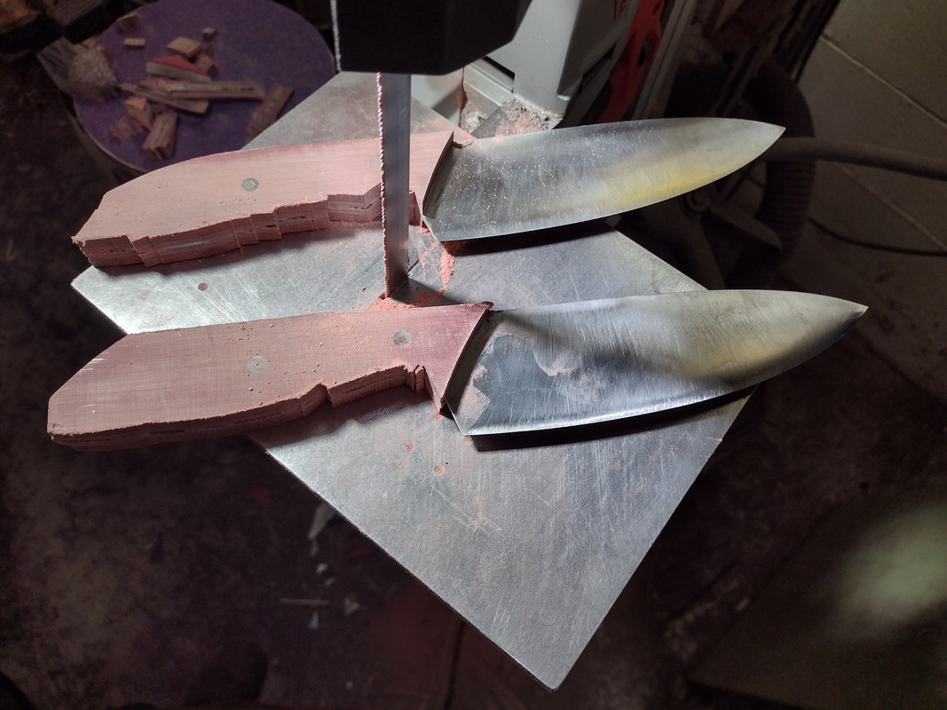

Micarta is my guess.What's the wood on that, sir?
It is Ultrex from Norplex.Micarta is my guess.
Cool.It is Ultrex from Norplex.
It's supposedly Really good. My mentor swears by it.... I think it's the first time I've used it?
I think it's made in Iowa.
What I do know is that for modern age Micarta, it's made in America. And it's expensive, relatively
I got it specially because of the shade of red, and the fact it's made in America
Cool.
Are the fronts of the scales finished? I was taught to give that area the treatment you want the whole handle to have before gluing since you can’t get to it after. They look just knocked off flat?
You are quite Correct, in both accounts.
Generally.
I've noticed that I like a little more registration at the front of my handles in pinch grip. I feel that when I prematurely face my scales (like we all would normally do) and I also do on non kitchen knives. It doesn't give me enough to press against.
So the last couple I machine square on my big wheel. I have a slight radius at that surface.
Then later I shape them to be comfortable.
So, to answer your question......I'm still working on it. I know what I don't like, but I still iron out a few things as I go.
I'm self taught.
I'm argumentative.
I think most YouTubers are Nuts, so I don't watch them.
My wife says I have delusions of grandeur....I don't listen to people. I'm a contrarian. So alot of stuff I do don't make sense to "normal people"..... ironically, My friends think I should have a podcast......
Ahhh, that clears it up succinctly.

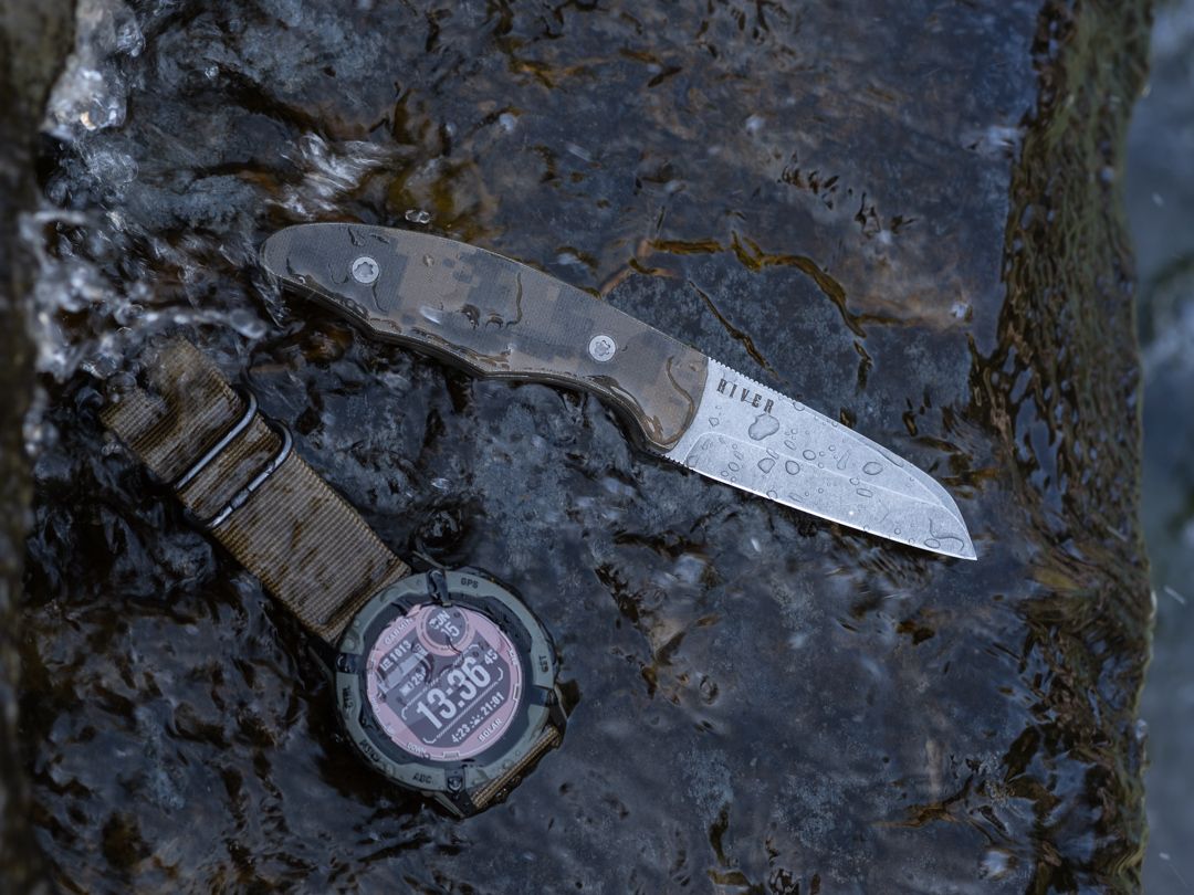

RIMG0167 by https://www.flickr.com/photos/153108294@N08/, on Flickr

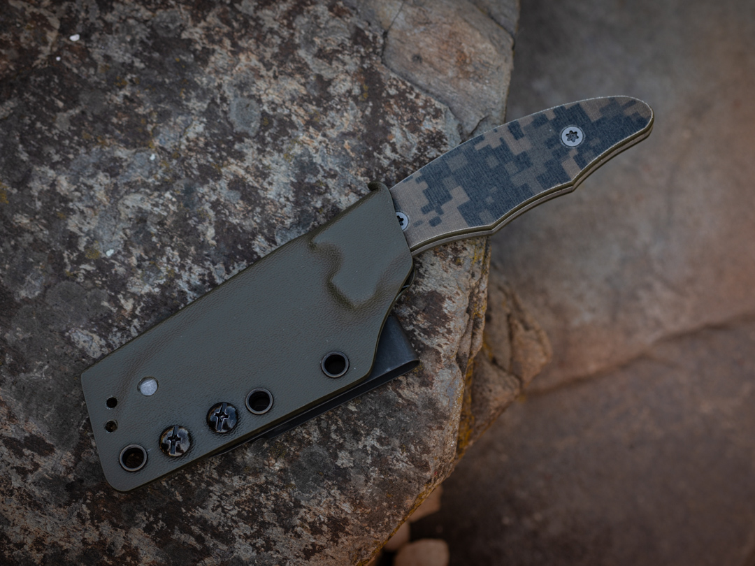

RIMG0165 by https://www.flickr.com/photos/153108294@N08/, on Flickr
Gorgeous knife, cool photo, too. What are we looking at, G^2 ?
