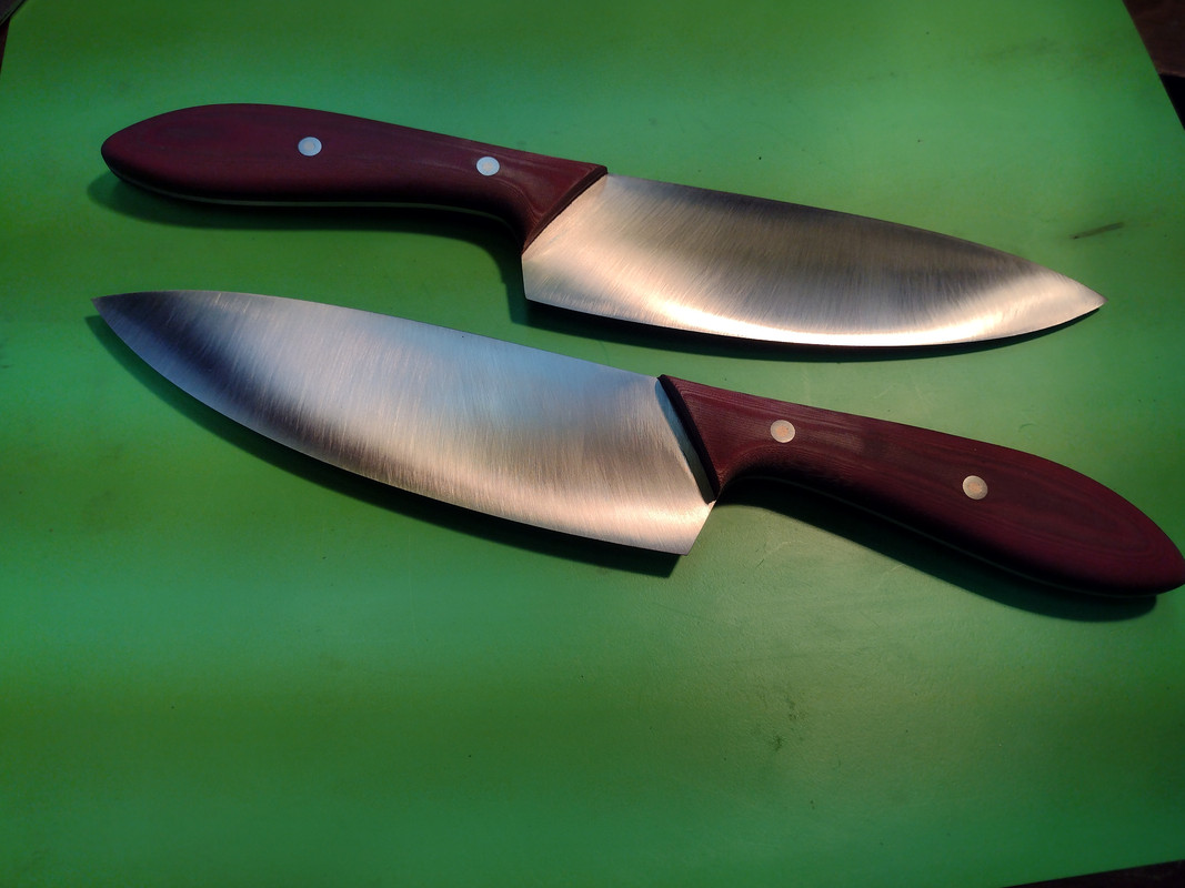

Current favorite EDC fixed blade

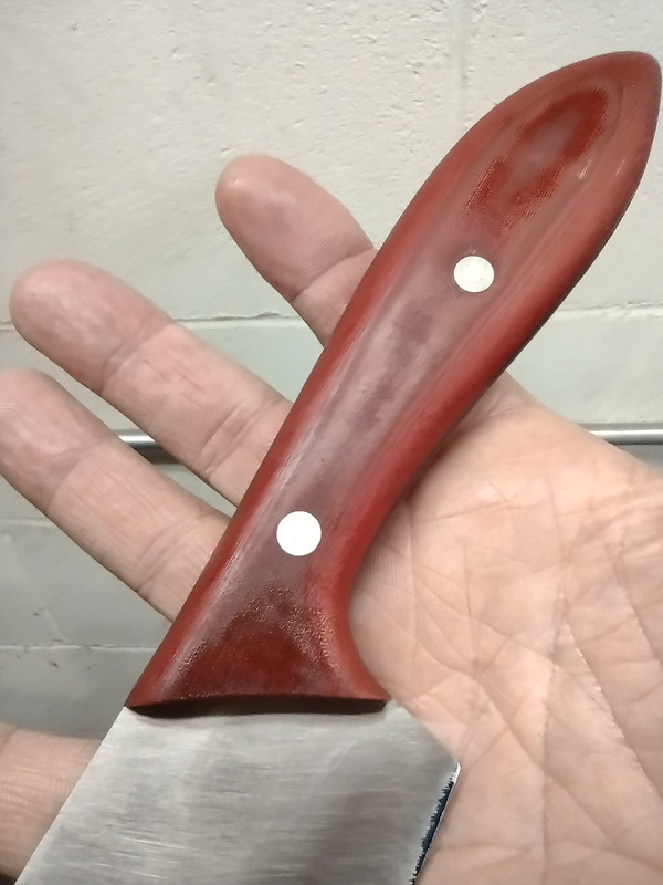

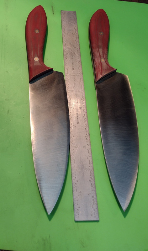

Are the fronts of the scales finished? I was taught to give that area the treatment you want the whole handle to have before gluing since you can’t get to it after.
100%.
Then later I shape them to be comfortable.
I used to do it like that. It made life harder, not easier.
I didn't think anyone would call me out on that...haha
I noticed it as soon as I saw your pic. Wouldn't have said anything but Antdog did first so he gets to be the badguy and I'll just be his minion. ;)
But seriously, it's much easier to finish the front of the scales first. Easier as in less time consuming, and easier to get the finished product looking nice.
100%.
Yup....I just think you(all) are wrong in this one instance.....
*I Used to completely finish my kitchen knives like you suggested. With an angle/forward slope. I don't think I'm going to be doing that anymore (for my kitchen designs)
Also, I think you are thinking my fronts are less finished than they really are...?

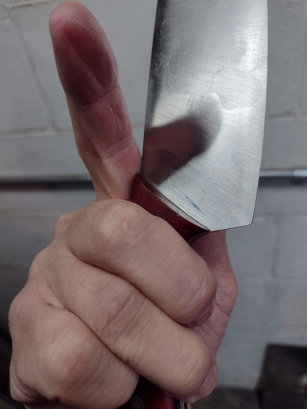

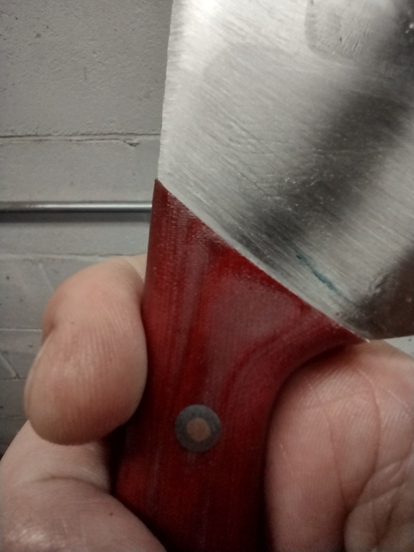

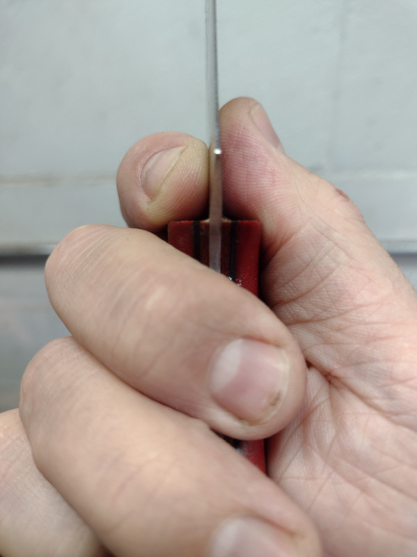

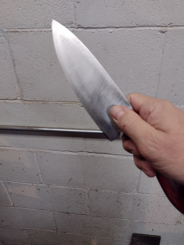

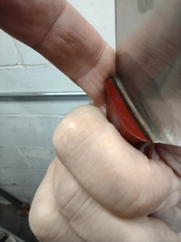

Let me try to explain with a pic or two.
-im still Not done shaping my scales, but I'm working on them now.

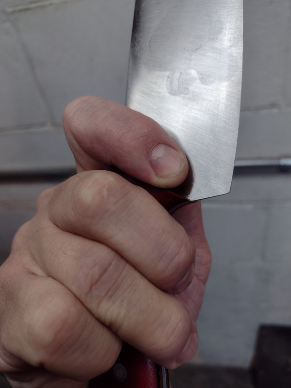

Pinch grip on a chef's knife
Trying to show all angles.
When I lift my index finger see that nice, large shelf I'm able to register against.
That is a Large radius, not a flat. It pulls the finger in comfortably. I will break that corner a little bit later once I'm done, but not much.
This is a Super Comfortable handle!
I really believe I'm making some of the Best handles available today.
Yes, I think and do things differently
I have Lots of opinions on what I want handles to be....haha
These are good questions, I believe good design should be critical.

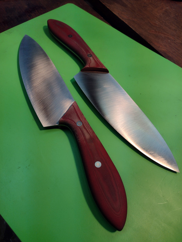

Where my progress stops today....
Still need final clean up on handle, blade, and edge....and probably some kydex
Idk if I'm doing anything tomorrow?
I'm just happy that at the end of the week it looks like a knife(s)
Those handles look great! neutral, comfortable and practical. Nice blade profiles as well.
