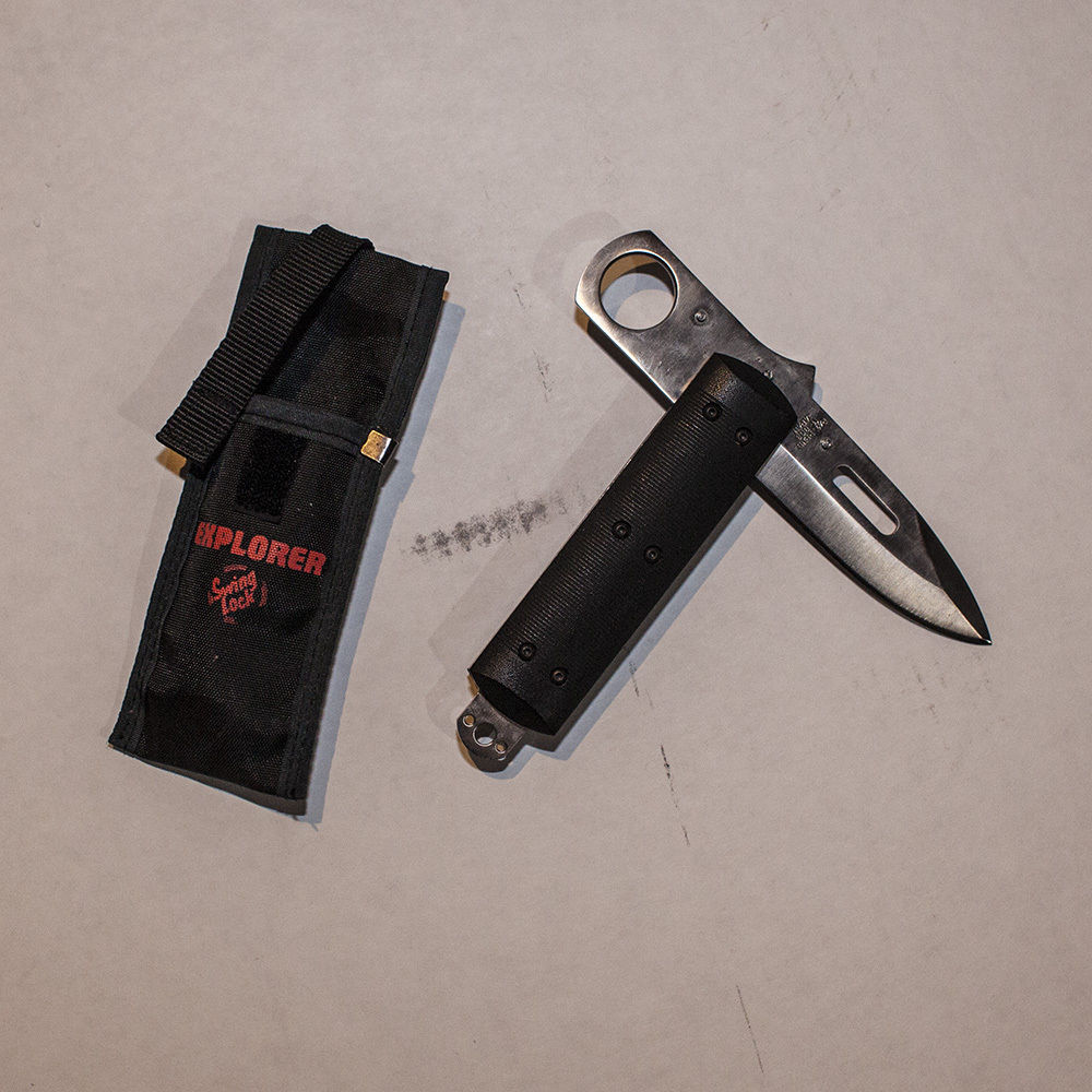

Mike do you think your concept is stronger than this, especially when it comes to lateral stress, personally I think this is closer to a fixed blade than your design and this came out in the 80s.
Not only do I believe it's stronger but also way cheaper to make, you could make one with some pretty basic materials and equipment.
I think your argument is no longer valid based on this knife alone.
T. Eldelyi,
I'm familiar with the swing concept.....Revolver, Explorer. I think it is laterally stronger to have some extended tang braced inside handle/liner. I don't
like the appearance of it, but agree that it adds lateral strength.
