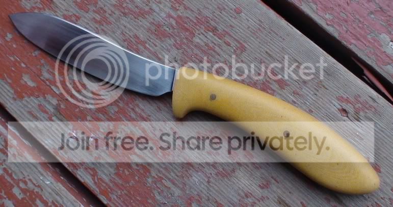

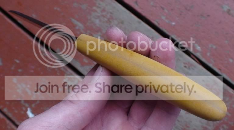

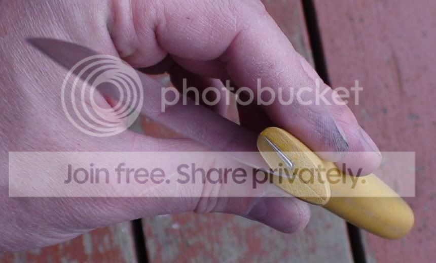

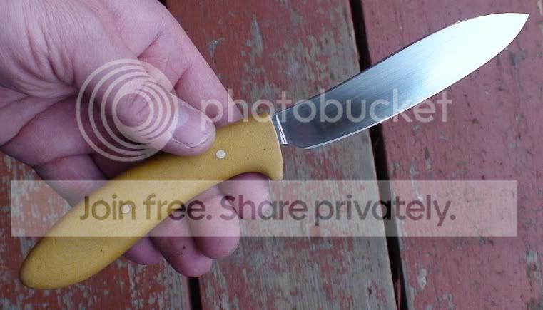

Here's what I ended up with...Better later than sorry :o
First forged blade (spring steel), under the guidance of Robert Mayo. Robert also inspired me for the handle construction (kind of hidden tang?).
I know, it's kinda ugly, but man! is the handle comfortable or what? :D The linen micarta was really easy to work with; buttery smooth.
This little ugly will stay with me, doing kitchen duty. With spring steel, hopefully the wife doesn't forget it wet in the kitchen sink for three days :eek:
Thanks a bunch Tracy; not only for the free micarta, but for the fast and accurate shipment :thumbup:
Did you put micarta filings where the tang is, to give a hidden tang appearance? I think it looks good!

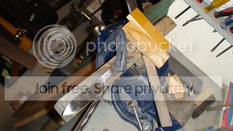

Hey Mike!
Here's a WIP picture so I don't confuse myself more in knifemaking terms:
I guess it's a half-hidden tang :confused:
You basically dig the tang profile in the micarta scale and you sandwich the whole thing with plenty of epoxy :D
Thanks anyhow :o
Mike,
I believe this is called a "Mortised Tang" If you search and you'll find some threads specifically about this if your interested in learning more on this type of construction. Hope this helps
