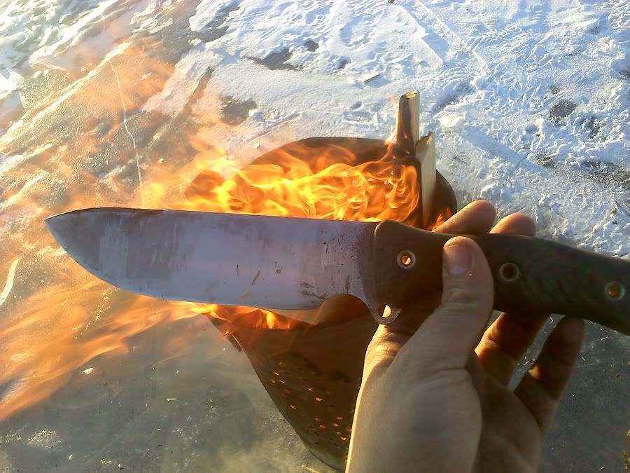

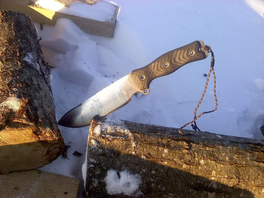

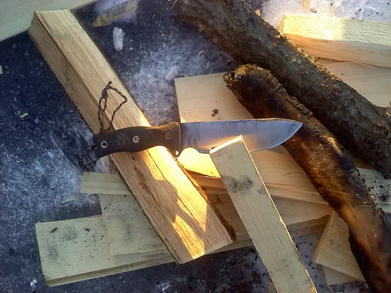

This knife was frozen, several times during the trip. It was dunked in freezing water to clear out holes and had been frozen over several times as well. Honestly, all went well for a while when going through soft wood, both chopping and batoning. It all went bad when I got to some hard frozen stuff. Sure you could say I should have brought a tougher knife for frozen wood, but I didn't intend on cutting up frozen stuff, and I wasn't going to lug out an NMFBM along with all my other gear a mile on to a glare ice covered lake.
I started to sharpen some of this out, to be honest though, I was up all night and in freezing weather all day, so i'm aggravated enough right now to just use it as a serrated bread knife.
Here are some pics.
Going good -
...and it all went to hell, this is after trying to clean it up some...
No nails, no imaginary blown temper from grinding it at 1000000000 rpm with a 2 grit belt, just a thin edged knife vs some hard frozen wood.

Not that it will make you happy but that sort of damage is something I would expect to see on a thin edged blade chopping frozen wood with a lot of ice/sap in the wood. I grew up cutting firewood and the season extended into the frozen months. Axes, knives, and even the Stihl chainsaw all suffered from frozen wood. We're not talking just cold wood but the stuff that is moisture rich. It beats tools like you are chopping blocks of glass. A thourough sharpening and maybe give the edge a slightly thicker profile will help avoid this in the future.

You should have seen it before I started to fix it, it was a hacksaw, very bad chipping and denting both. I rolled out what I could with a steel, but it was futile because a lot of the metal is just flat out gone.
