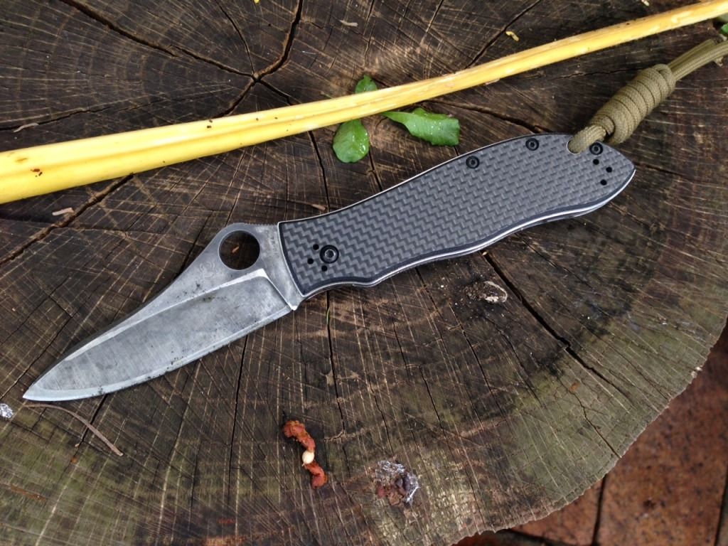

Thanks guys,
Bill, I cannot tell the difference from the original scales, if anything it's more comfortable as there's no sharp edges from the proud liners, the scales have a light sandblasted finish so still have a bit of grip
and the opened lockbar cutout makes it a lot easier for OCD openers and closers
Here's a pics as compared to a para2 for handle size

I love the patina of Rusty351's knife - the mods are really nice too but for now I'll be happy with the cf.
In case Rusty doesn't see your post. I would suggest vinegar warmed up to about 100* F. You might want to remove the blade to do the patina so you get a even finish on the whole blade. Also, wash the blade very well first to remove any oils to achieve a more even finish.Rusty,
How did you get that beautiful patina on your Bradley?
