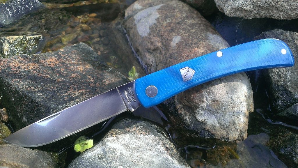

Thanks guys. I'm happily carrying and enjoying the knife now. It looks alright too, considering. Still need to mirror the face on the blade but it's getting there uploadfromtaptalk1411774153160.jpguploadfromtaptalk1411774165294.jpg
