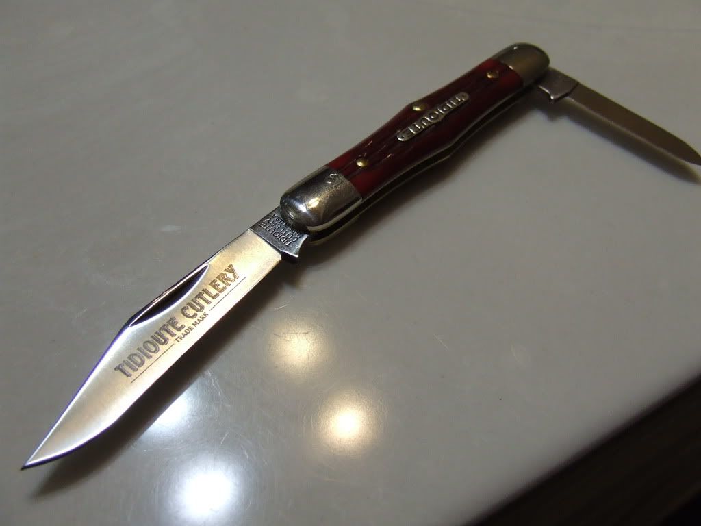

got this apple red jigged bone conductor today, very nice knife and my first one from GEC! the only thing i dont really like about it is it doesnt have much of a "snap" when you open the blades.

Nice lookin' knife, bladeblabber. I've got one just like it and the pen blade is a little light on the opening snap. I've flushed it out with WD40 or Hoppe's no.9, and oiled it good afterwards and that helped some. On mine anyway I tend to think the bolsters & liners got squeezed just a little too tight from the factory. (I have no idea if that's the real issue or not; just a theory that sounds reasonable to me). It got better after a few months of use, too.
Your picture does an excellent job of pointing out two things I really love about these Conductors: The nice deep nail nick, and the needle-point tip on the clip blade.

thank you, I put some oil in the joints and i think it is getting a little bit better already. I have a case pen knife and i like the blades on the conductor more, like you said they are needle sharp.

If yours are like mine, the issue isn't so much in the joint. The spring on mine barely moves when I open and close the secondary blade on mine. It does shut on its own, but barely. I think they took just a scoche too much material off when they formed the tang. But since it does have (a little) snap, and will hopefully not get any worse as the joint frees up from use, I am not worried about it.

I think you probably nailed it there, Stu. I just compared the secondary blade on my apple red to my natural bone and the backspring isn't raised nearly as much (on the apple red) when in the half open position. Secondary blade snaps like normal on the natural bone. Your explanation makes a lot more sense than mine - thanks! :thumbup:
