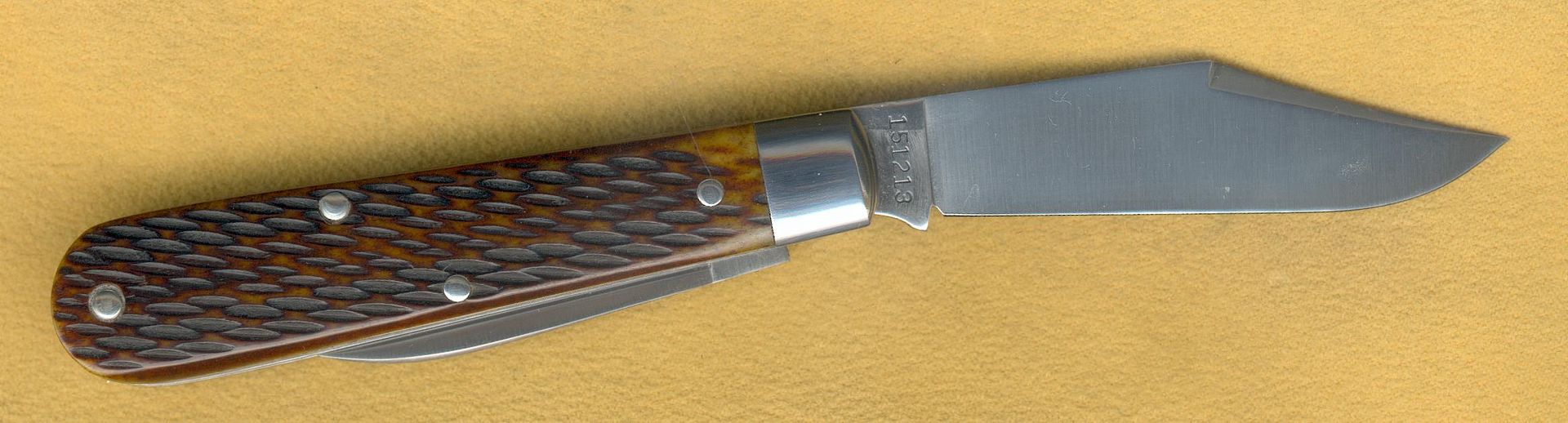

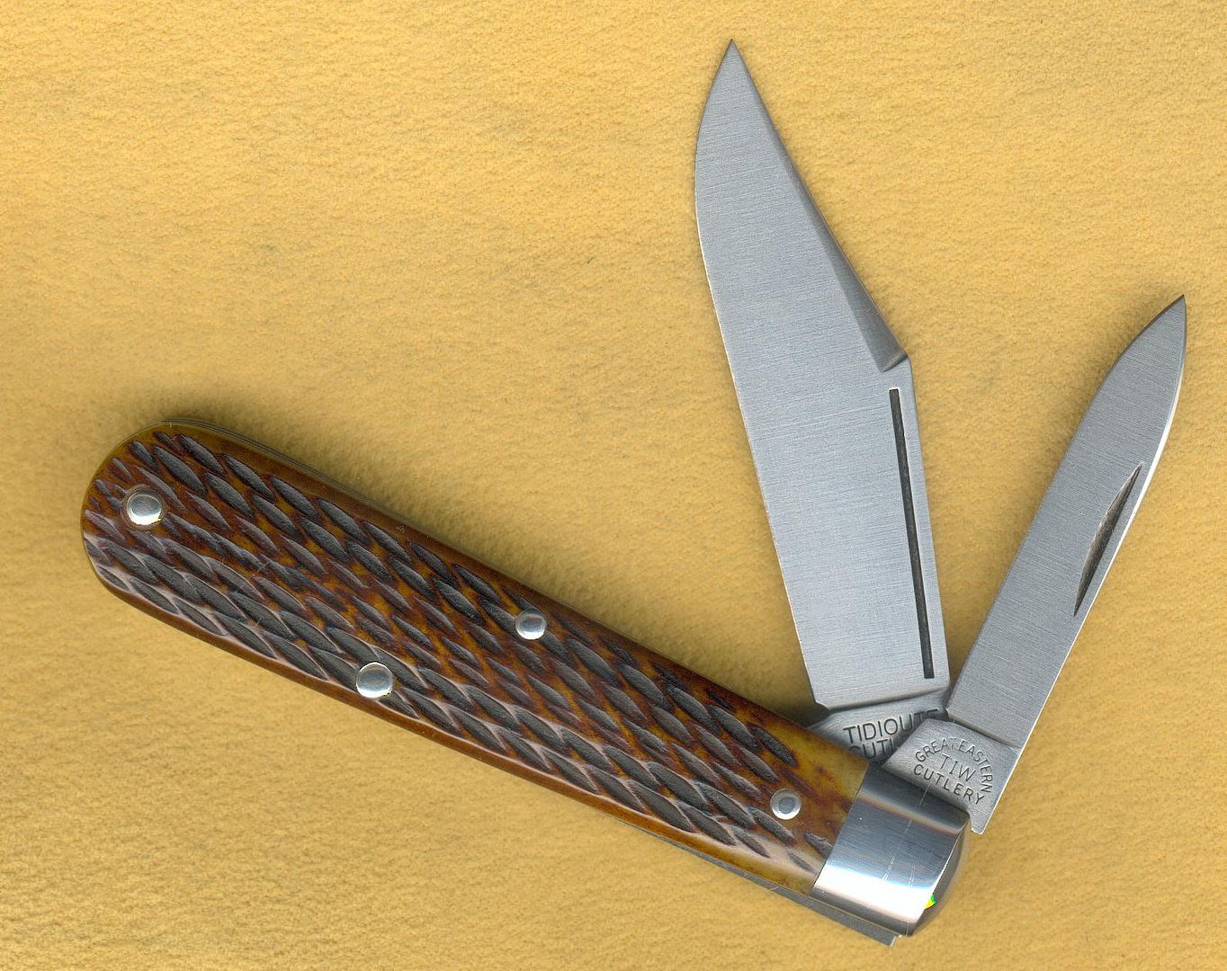

After seeing Barry's jigged handles (a page or two back) I had to see one up close.
Fine looking knife! Looks and feels like 80 years ago!!
I love my #15 barehead in red jigged, but that antique yellow ^ is really sweet. :thumbup:

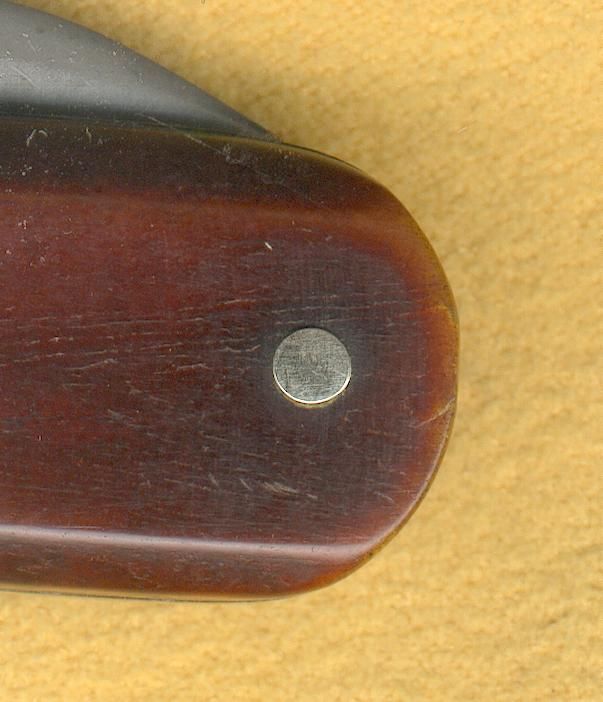

Funny that you should come along now Charlie. I had a conversation yesterday with Sarah about how GEC rounds/flairs their end caps while leaving their barehead covers nice and crisp and sharp-edged.
I came back this morning to show Sarah how many of us (including you) will sometimes break that crisp and sharp-edged barehead cover to make the knife easier on the hand, etc. while carrying. As I recall you did it too your 2012 Forum Knife.
Sarah - Here's my Boys Knife with rounded barehead cover.
As you can see, I broke the sharp edged of the cover. Nice and smooth in the hand now.

You are right Ed, I often smooth the handle of a knife I decide to carry. The cutleries are careful not to soften that barehead end too much, as it can get that "scalped" look, where the jigging and dye are buffed off.
The downside of leaving it square, beside the comfort aspect, is it chips more easily if dropped.

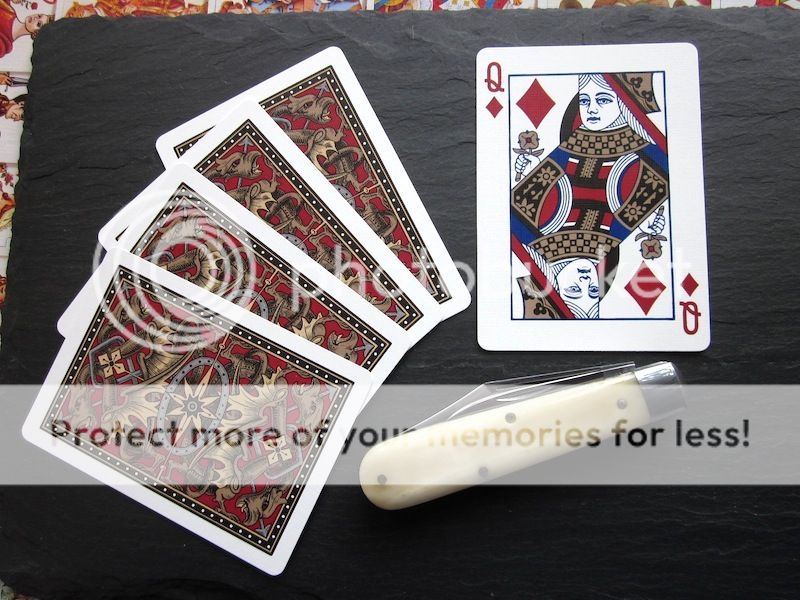

To remain en pointe: this is my favorite picture to date of my Boys Knife in smooth white bone, which proved irresistible-- especially after gunstockjack's picture earlier in this thread. I've posted it elsewhere, but not yet in this thread:
IMG_0175.jpg~original
~ P.
I use a flat piece of 220-grit sand paper, cup it in my hand to curl it to the approximate radius of the cover, determine the angle I want, and then stroke the cover's edge against the sand paper until I get the result I want. Much easier to do than described.

Sarah, my weapon of choice for the edge dulling of the bone is a 50¢ plastic handled, pot metal emery board I use to smooth my fingernails after clipping. For the blade spine I use my 600 grit diamond sharpening stone. I don't want to round it, just de-sharpen it.
I have used emery boards for shaping the bone slightly, then gone to finer sandpaper to erase the scratches. The nice thing about pocketing the knife after is, in a year or two it will be pocket-polished anyway! Patience is everything!:D
