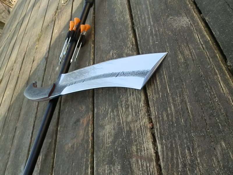

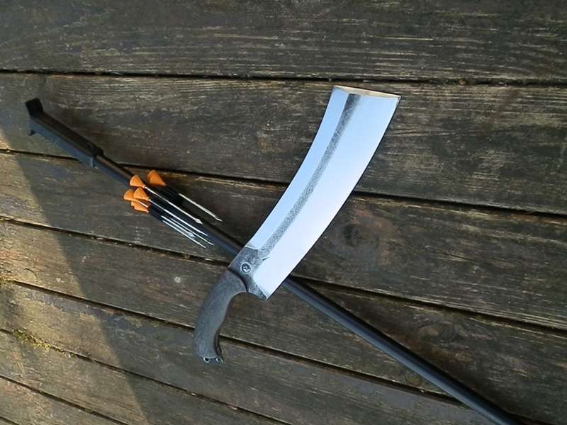

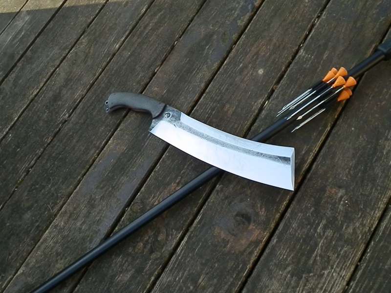

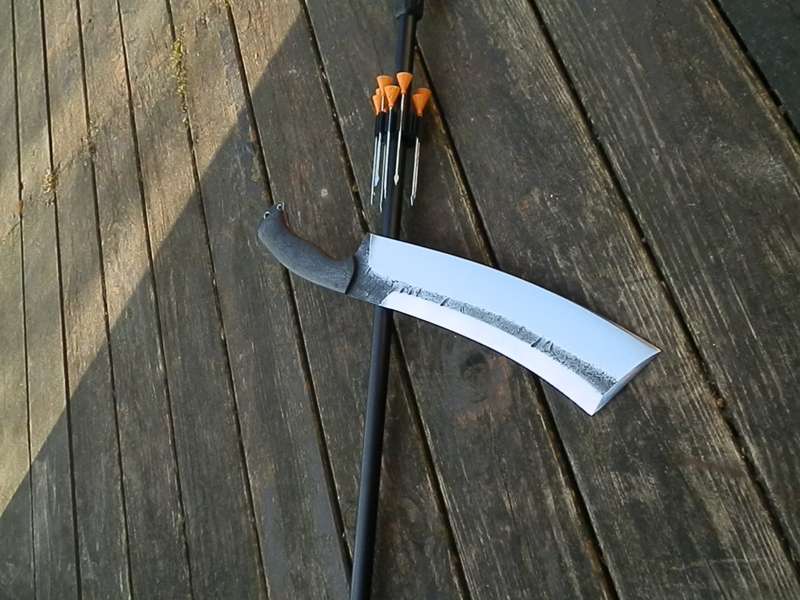

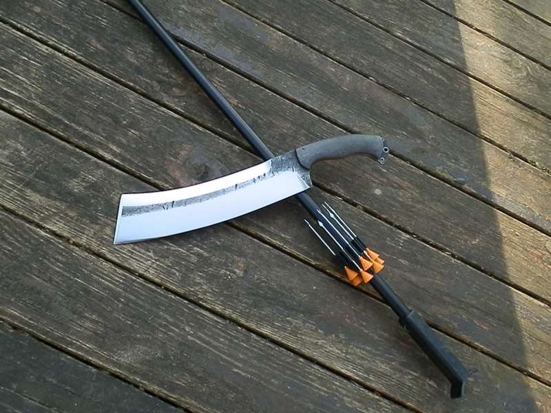

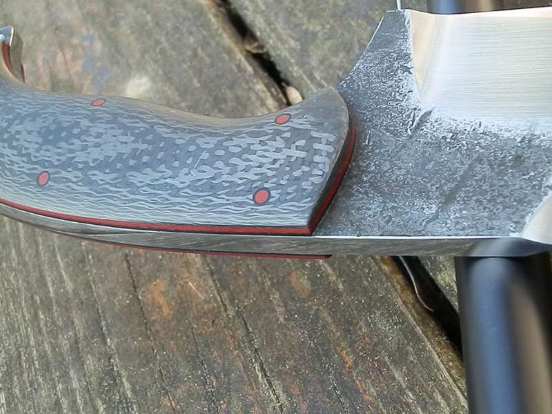

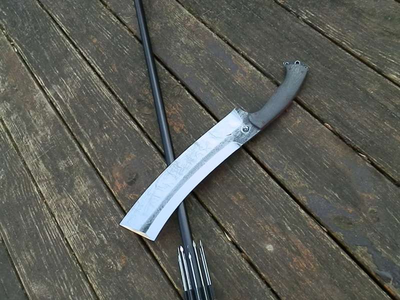

And another Cleaver:

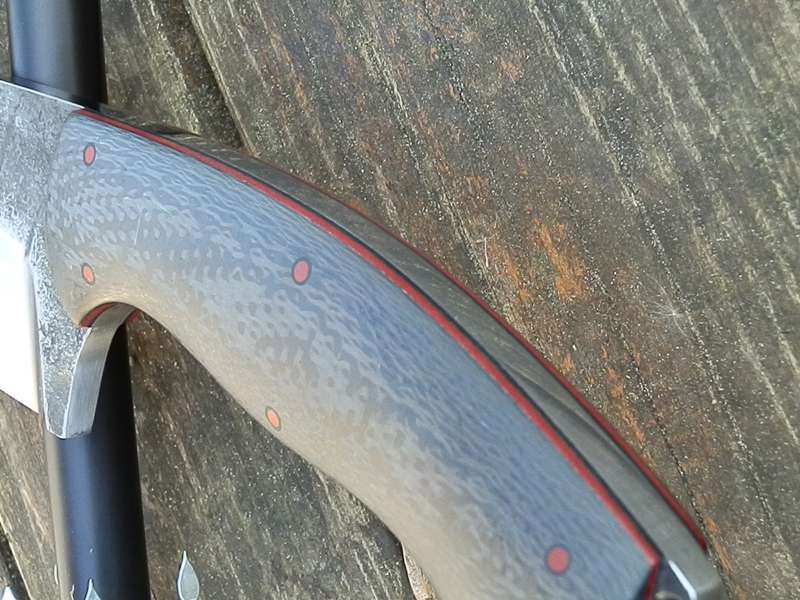

Excellent job on all of them!! I Love how the handle came out on the new cleaver too. Very creative way to do the pins.
Thank You Worldwood. Pins are carbon fiber tubes filled with red resin. Although i thought that the contrast would be more visible:) Should have taken bigger pins:) I will use the same pins for smaller fighter with G10 scales i plan to make in the future as i have few left and maybe with smaller handle and darker black G10 scales i will be more satisfied:)
Regards
Giedymin
I really like the size pins you used, it doesnt take away from the nice carbon fiber scales and matches the liners great.
Im sure ill be getting another knife from you in the future, it will be hard to pick between a cleaver like this or the Raven 2 bowie.
You keep on impressing me more and more man. I like big knives and you make some big sexy blades.
I cant wait until my chopper gets here, once i get it i can post some pictures of it in use here in your thread if you would like.

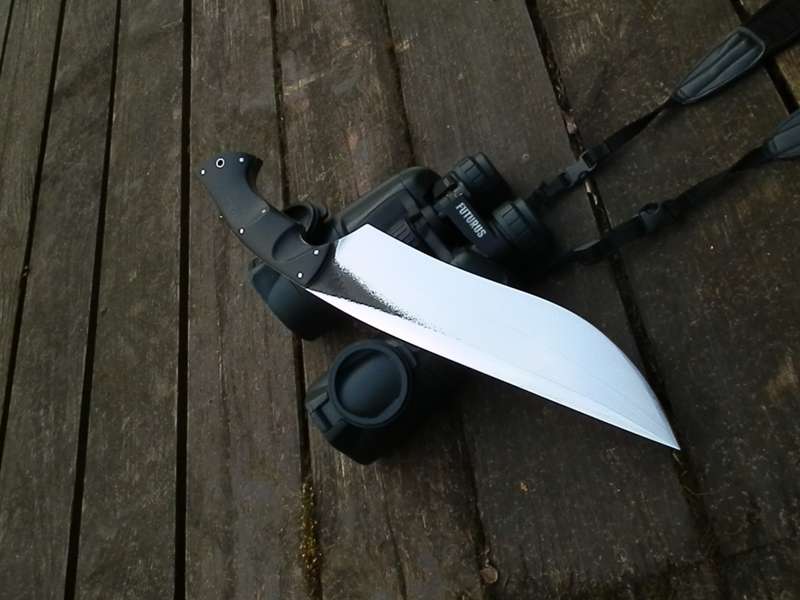

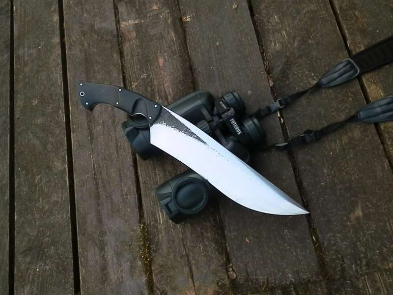

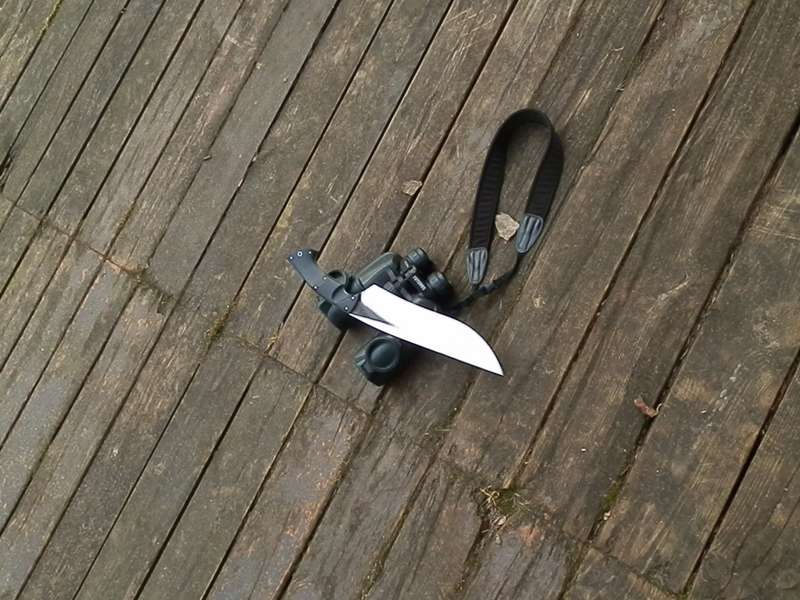

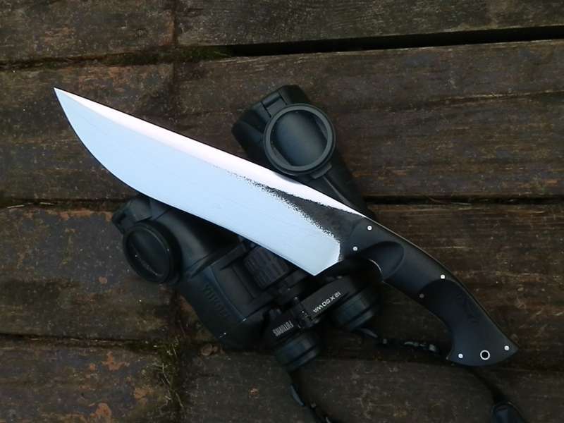

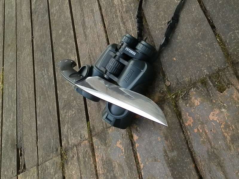

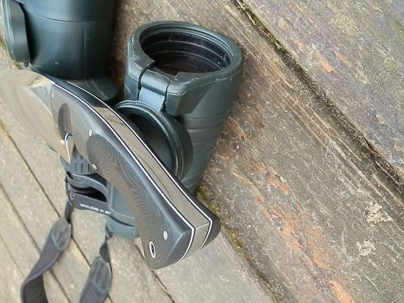

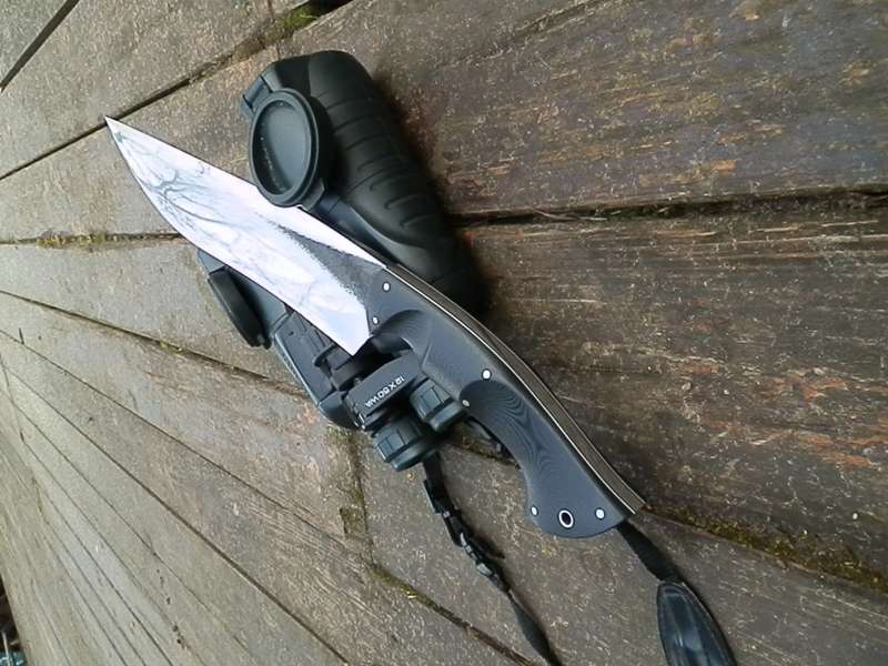

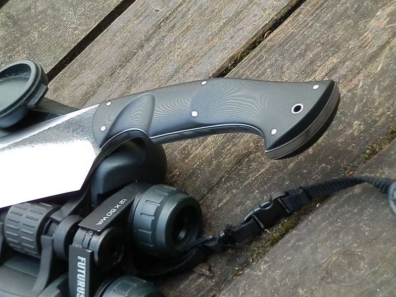

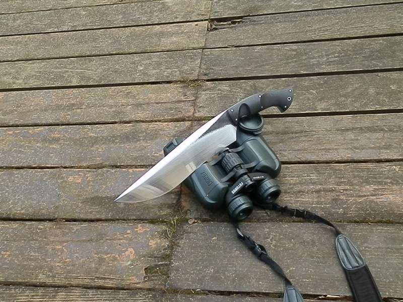

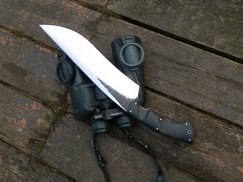

I've just finished new "fighter" blade.
G10 scales with black and white vulcanized fiber liners.
About .250 inch O2 edge quenched.
9.500"blade.
Hand rubbed to 1500 on the bevels and polished handle, spine and belly.

Awesome knife, i love the shaping on the handle!! Looks really comfortable.
great job again man, I love seeing your new knives, keep up the excellent job!!
I really like what you are doing with the blade profiles lately. The more graceful curve in the belly up to the tip is a more pleasing line than some of your earlier ones with an abrupt curve. Super stuff.
Gorgeous knives sir! If you tapered the tang on some of them it would put them over the top IMHO.
Keep up the fine work! :thumbup:
Thank you very much:) I try to do my best and i appreciate those kind words a lot. Especially from great makers like you guys.
Best regards
I also think tapered tangs would take them to the next level, and they are already exceptional.
