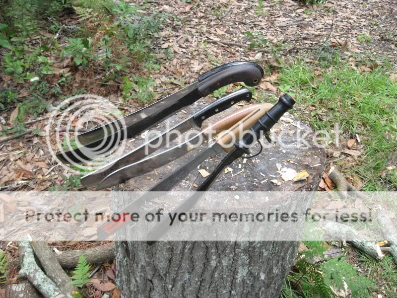

Here it is, the big golok comparison I've been working on. I have assembled six of the best known goloks to compare their performance. Left to right:
David Farmer's Dangerous Curves, Hopkinson Special Forces, Bark River, Martindale #2, Valiant Survival, and Condor.
When I unsheathed them, it was obvious that these blades have different shapes. We have two styles here: The Parang style of the Martindale, Farmer, and Hopkinson, and the traditional Borneo stye of the Condor, Bark River, and Valiant Survival.

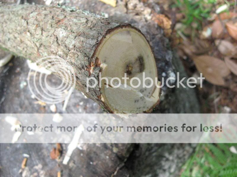

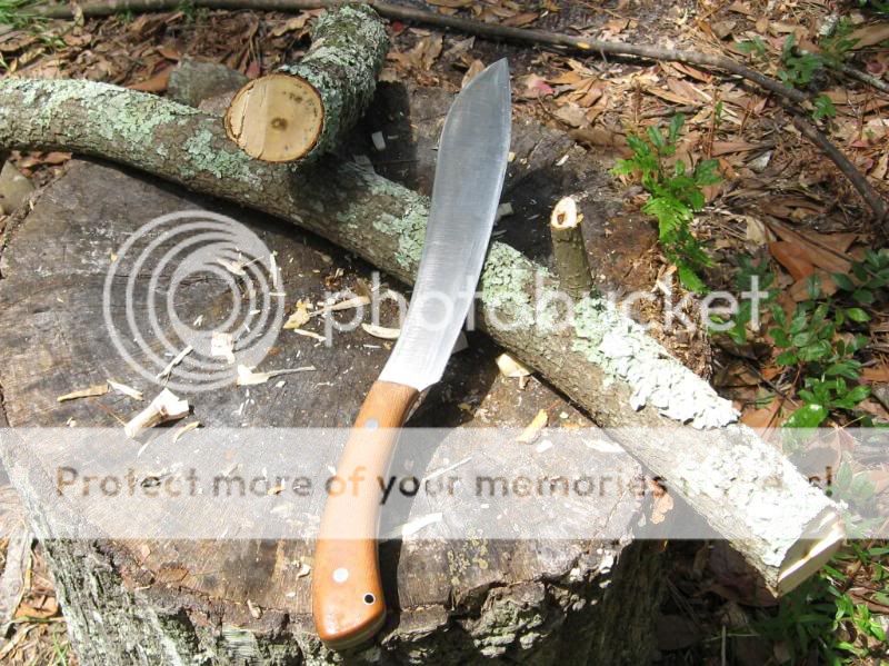

Sorry to do it this way, but this comparison has lots of pictures, so I'll have to break it up into about five sections. I took the little Farmer golok out and chopped some Red Bay to use in my testing. This little knife can chop. It bites deep with each swing, much like a very sharp camp machete.

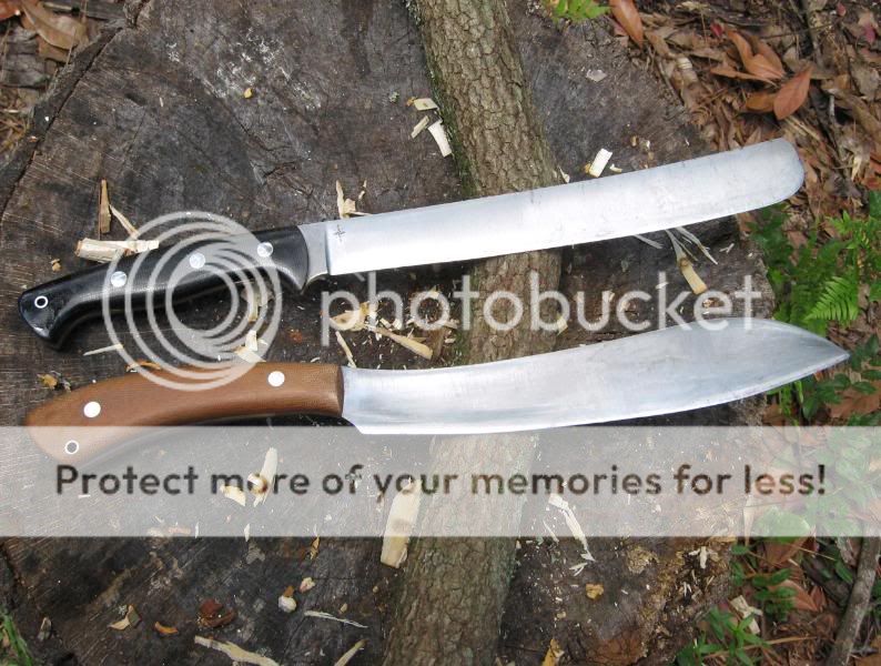

With some wood gathered, I compared the Farmer with the Martindale and the Hopkinson.
All three chopped well. The Martindale was the least comfortable to chop with, and the Farmer the most comfortable. Despite the extra weight of the Hopkinson and a very nice convex edge, the Farmer did as well. The Farmer is a pure joy to use. The Martindale chopped fine, but was really hard on my hand with the most shock and vibration of the three.
I love my Bark River golok. I compared it with the Farmer. Both are light and fast in the hand. Both slashed light vegetation well. Both weigh about the same. And guess what? Both chopped about the same as well. But as my hands grew sweaty, I was wishing for that traditional golok shape of the Condor and Valiant handles. But the micarta scales stayed grippy and I did not lose either golok during extended chopping in the South Georgia heat.
So which do I prefer? In all honesty, I don't know. They were about dead even in chopping and comfort. These are both a cut above the Martindale and Hopkinson, and they should be for the price. I think I like the BRKT just a bit better, but that may be because I am used to it. Both of these would be great for hikers and backpakers. They are light, fast and sharp.

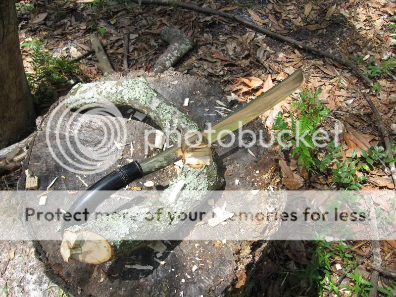

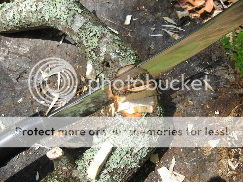

Time to take out the big boys for some serious chopping. The Condor is a chopping beast. I have taken down full grown trees with it. The Valiant is brand new. Thankfully, it came very sharp. No touch up needed on this convex beauty. Both of these goloks chopped well, but the Condor repeatedly chopped through in less chops.

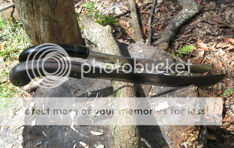

I ran out of wood and used to the Valiant to get some more.

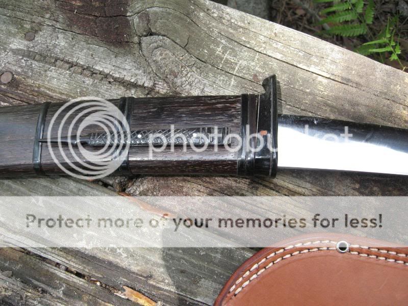

The valiant has the most comfortable handle of all the goloks here, but its slick surface does not provide as good a grip as the Condor.
The Valiant really slashed vegetation well, a bit better than the heavier Condor, but the Condor out chops it.
At this point, some will want to know which golok is the best chopper overall. After a few hours use, I can say that it is the Condor. The big handle lets me put some serious muscle into each blow, and the long heavy blade just does more work with less effort than any of the others.

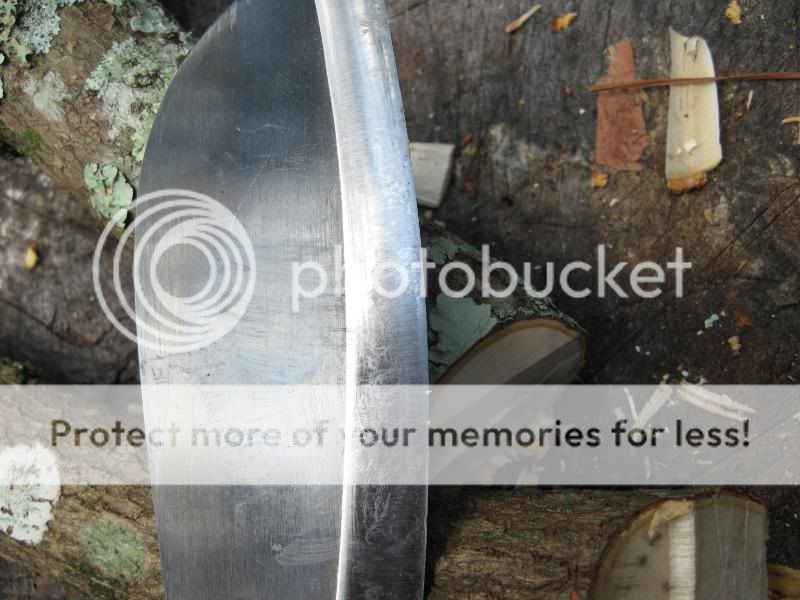

The Martindale and the Hopkinson are about even. Both are good, inexpensive tools. But both required extensive reprofiling of the edges to make them chop well. The Farmer is a surprise. It is lighter and shorter than either the Martindale or the Hopkinson, and can out chop them both. The Farmer is the equal of my much loved Bark River golok. The one I used today belongs to TonyM and came with a nice leather sheath and baldric. I did not use the baldric today and wouldn't with such a light knife.

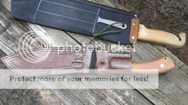

Fanciest sheath prize goes to the Valiant's wood and horn sheath. Just don't turn it upside down or the golok will fall out.
The BRKT came with a nice leather Sharpshooter sheath.
The Condor did not come with a sheath, but fits in my Martindale bolo machete sheath.

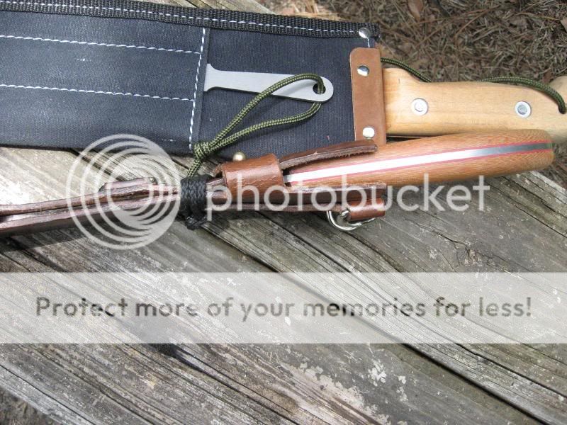

The Martindale came with a canvass sheath with a pouch and file. Not bad.
And the Hopkinson golok sheath is really an old RTAK sheath I had. It did not fit the sheath that came with it.

Valiant: Wow. I am impressed. I can see now why Mike Stewart used this design in his golok blade. It came with a super sharp edge, and that handle is the most comfortable one to chop with. It slashes vegetation very well, like the Bark River, and is second only to the Condor in pure chopping power. The workmanship is very fine. I need to figure out some way to retain the knife in the sheath. It is a very loose fit and the knife falls out easily.

Farmer: This is an amazing performer for its size and weight. This would be a good choice for hiking and backpacking. I didn't try it, but I would imagine one could even skin animals with this golok. It is the most versatile knife in this review. What a superb camp knife this would make. I went on the Farmer website and this golok with a sheath is priced comparably to the Bark River. Not bad for a custom.
