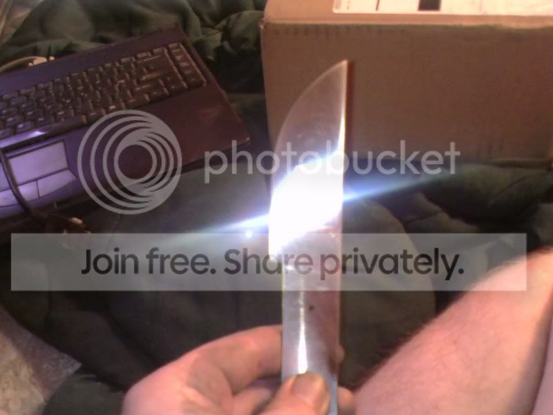

got my steel in today and started working on my FIRTS KNIFE!!!!!
it may be just how i'm looking at it, but your transition from tang to blade seems kinda sharp, might be a possible stress riser. looks good though!

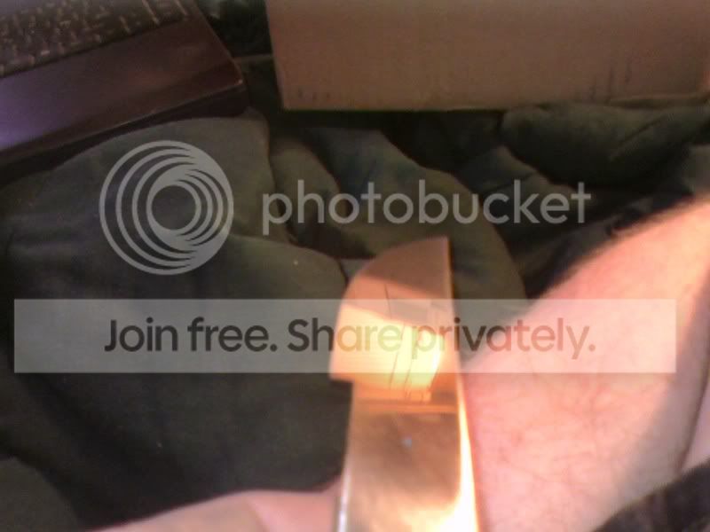

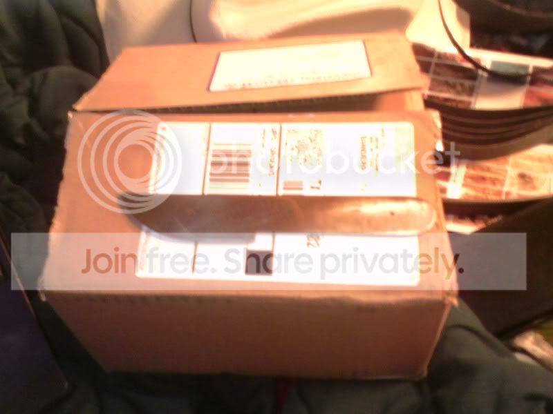

new pics!!!! i havent finished sanding it to 600 yet but here is the lastest updates of it. these pics show the pin holes drilled in the tang.
so hows it looking so far?
