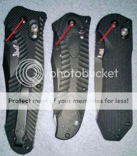

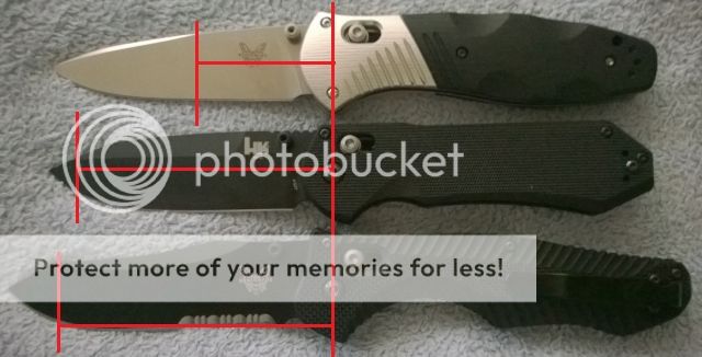

I have noticed slight awkward feel I have in opening the knife with HK14715 when I compare with Contego810 side by side. (Yeah, double fisted.. ;) ) Here is the radius distance from pivot pin to the thumb stud.
HK AXIS 14715: 0.82"
Rift 950: 0.99"
Contego 810: 0.94"
So, diameter difference between 14715 vs. 950 is 0.36" Given that HK14715 is heavier blade, I think it would be easier if the thumb stud is placed a little bit more toward the tip. of cause your mileage may vary for some of you who enjoy opening Adamas 375.

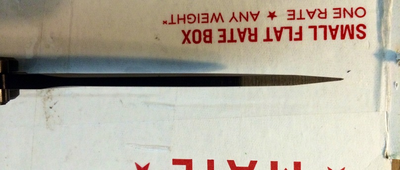

Benefit of keeping Blade thickness:
The HK AXIS 14715 shape is a bit odd shaped modified drop point. I think it is because it meant to keeps blade thickness more to the tip.
Here is the measurement of blade thickness.
HK AXIS 14815 0.146" (D2)
Barrage 581 0.121" (M390)
Contego 810 0.156" (CPM-M4)

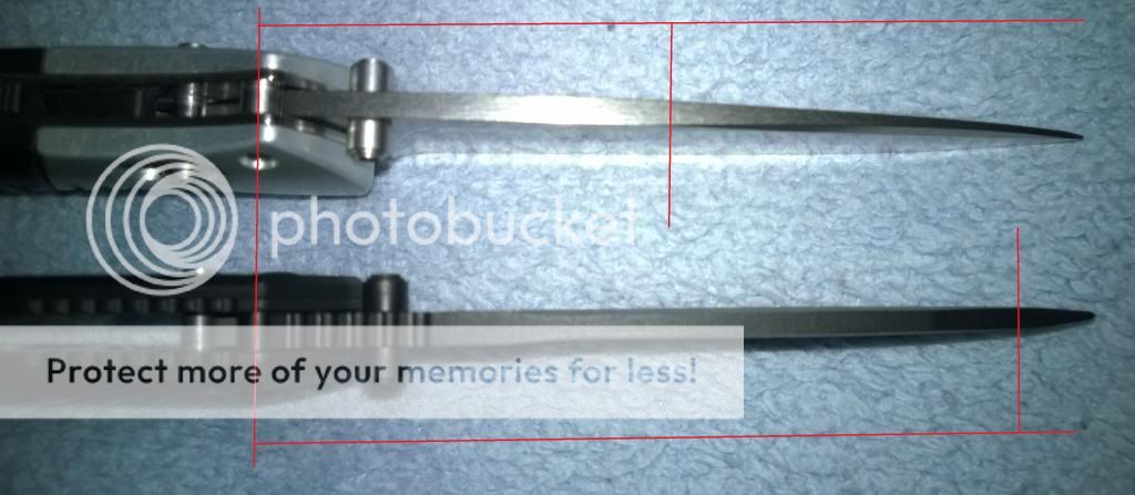

Here is side view of 581, 14715 and 810 (950 is very similar)
Barrage 581, HK AXIS 14715, and Contego 810:
The length of redline is how long each blade keeps same thickness.
Barrage 581 2.34"
HK AXIS 14715 3.79"
Contego 810 3.87"
I must say that both Osborne Tanto (Modified reverse American Tanto) design keeps thickness of the blade toward very tip with .25" of
triangular tip.
I feel that a knife intended to have steady thrust cut, this would allow more rigidness of the blade. For the shape of 14715, it may be
BKC 's fusion of Modified drop point without sacrificing blade rigidity.

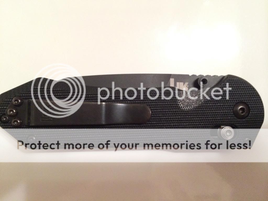

My Combo Edge model came with a much finer/weaker tip. I'm not sure if mine was just overground or if they changed the geometry, so back it went. Curious though...
LOL. I hope this is a joke. If not, and you're worried about breaking that tip, you need to stop using a knife for non knife tasks. That is a stout tip bro.
I prefer a stouter tip, to each his own... But the point is, that there appears to be a fair bit of variance from one 14715 to the next. I find that curious.
