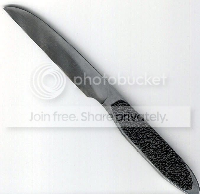

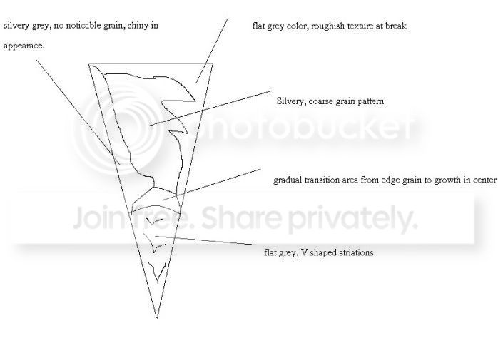

A nicely done zone hardened blade with a hamon is a fantastic thing. It may indicate a superb heat treat and blade with excellent performance, but there are BAD heat treats that look very similar to a hamon yet perform about as well as a lump of mild steel at home depot. I've had a few of the latter a few years ago when trying to harden and quench using an undersized oxy-mapp gas torch on 1095. The very edge of that blade hardened and performed well, and something that looked like a hamon formed after etching(even though no clay was used and no differential hardening techniques were employed). The knife cut well and the edge didn't chip out, and regular use didn't show any notable performance issues. Looking at the grain structure after breaking it with a couple 90 degree bends showed that there were about half a dozen distinct structures present, so just looking nice won't tell the whole story. It was also a wet noodle, with what seemed like less resistance to bending than an unhardened blank of similar shape did. I still have no idea what my edge structure was at that point, instead of being a clean satin grain it was flat in texture with chevron shaped striations pointing towards the edge.
Kind of like V shapes, reminded me of a tractor tire almost. Right above that was a small transition area, above that and in the core of the blade an area of huge crystaline grains... I drew a picture back when It happened cuz I couldn't get a good photo of it... lemme find it.
aaaaand here it is along with a scan of the knife before I popped it into the vise. Circa 2002-2003
I have never seen anything like that, and cannot offer any suggestions as to how it happened. Most of my experience is with jd5160 52100. I only edge quench using a slow oil, Texaco type A, on straight blades and always have pyramid structures in the cross section, you can see the influence of these structures reflected in the etch on the surface.
Thanks for the drawing, it is interesting to see.
I learned a few important things from that one, #1 being that heat treating with a torch ain't as easy as you make it look. 2nd one being that a normalizing cycle on admiral steel's 1095 would probably be helpful. That was the last time I tried my own hand at heat treating, kind of fell out of knifemaking as a hobby back then. Next time I get the itch I'll be building a small furnace instead of trying to use a torch.
