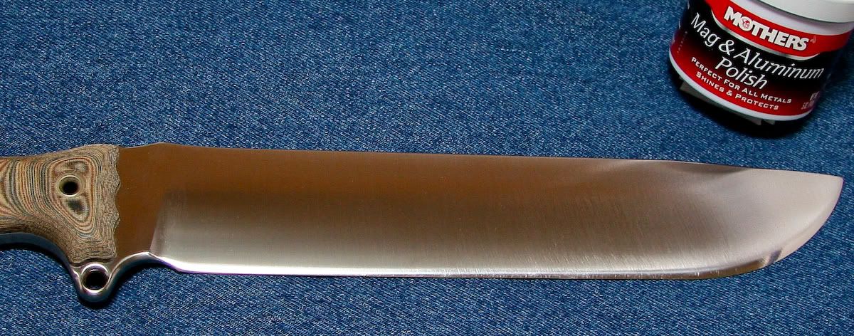

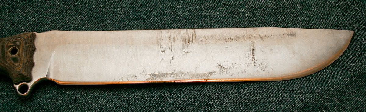

Although INFI is not a stainless steel, it is the most stain & rust resistant non-stainless steel I've yet to personally encounter. And, although I have seen rust on one or 2 of mine from time to time (mainly due to my carelessness), it has always been just light surface oxidation/rust, and never has pitted the steel. I wouldn't worry about scratching the coating, but if you do, then just use a but of mineral oil in those areas between uses and you'll probably never see any at all...unless you dive with it in salt water and forget to rinse it down. :)
Here's what I mean by my carelessness... A satin finished Busse not cleaned well, and put back into its cardboard sheath still wet...for amost a year! (most cardboard does have a bit of acidic properties, which doesn't help when wet objects are in contact.) A little TLC with 'Mother', and back to new looking!!!
Before:
After:
...INFI is very forgiving! :) Enjoy that BOSS Jack and don't spend your time worrying about the little things (scratches, etc.). :thumbup:
Wow, that did clean up nice!
