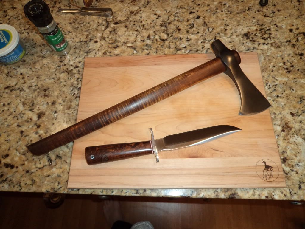

Butches forge hawk and bark river model A1

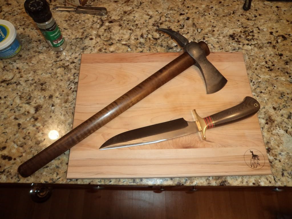

Stuart willis spike hawk and large bark river bowie

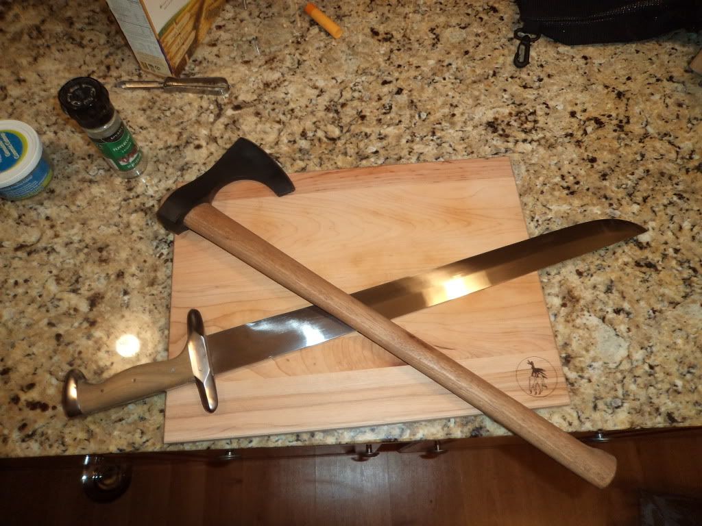

A nordland Axe and a messier from arms and armour

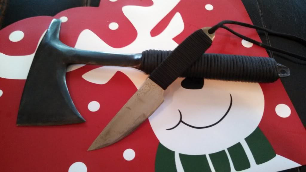

Detail on that duo? Especially the knife. Me gusta!
Hi Scouter27!
I think you already know about the Tomahawk. (Estwing Carpenters Hatchet I modified)
The knife is a nice little piece. I made it from 0-1 steel. I kept it thin and light. I made it with a chisel grind on the right side of the blade. It cuts pretty darn well (slimy stuff sometimes sticks to the smooth sides) it is 1/8th inch thick 4 inch blade 8 1/4 inch overall length at 1 1/2 inches wide. I like it. I have been in a paracord kick lately. I think this blade with a normal flat V grind and textured flats will really make a great little user. Thanks for the kind words. Cheers.
