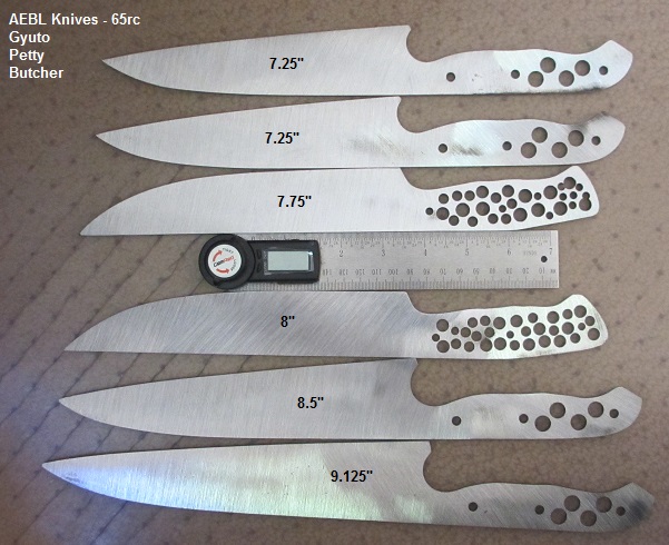

CWF HT aeb-l (as an example) - Step 0 to 7
s0: aust blade at 1950-1975F for 10 minutes
s1: quench blade to 450-465F oil bath, slice around for 10 seconds, then stir around for 1 minutes
s2: Cover the oil bath with a lid or aluminum foil.
s3: 1 hr later - remove lid/cover.
s4: When oil temperature falls below 200-180F (take around 2-3 hrs depend on oil volume), air cool the blade to near room temp (~70-90F)
s5: Wash/clean blade. Straightening if needed and easy because the blade is still highly ductile(very high RA%) at this point
s6: Cryo (subzero should be ok for many steels) for 3-4 minutes, take out, wash
s7: Soak blade in 275F oil for 5 minutes. Take out & wash.
Done.

So aside from being slightly different from someone elses HT, where is the crystal weaving function of this HT. I don't see this being anything wildly different. Just wondering
Differences:
1. quench to ~Ms. (call it marquench if you like)
2. 1F per minute uniform continuous cooling (thus hot oil bath). I called this - Weaving.
3. get peak hardness by 275F activation temperature. IF temper directly to 350F, peak hardness wouldn't materialize and blade would be much softer than activated+cool-to-room, then temper
Or maybe no diff, it's just mumbo jumbo.
