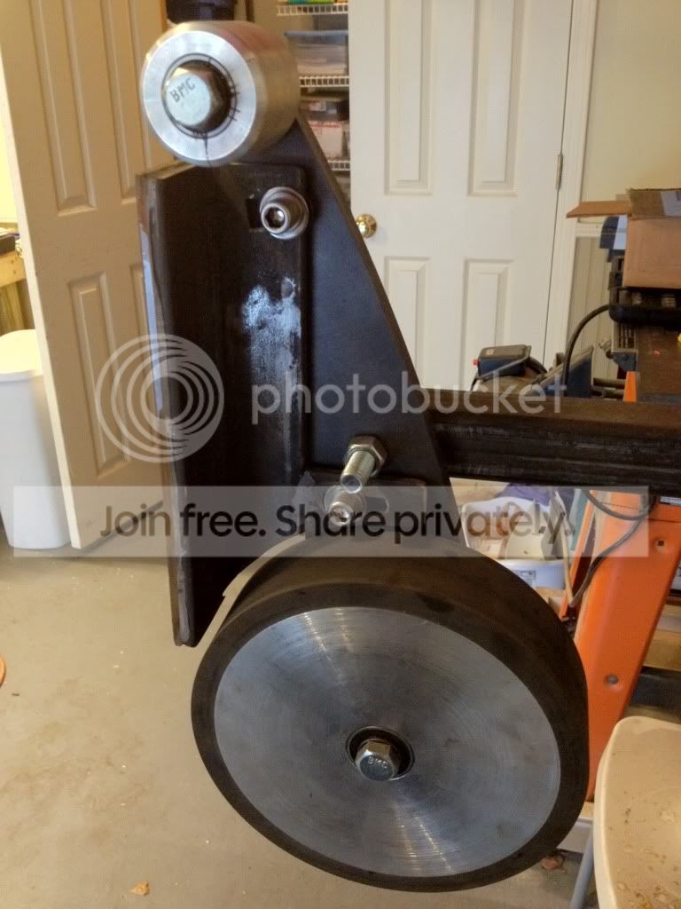

I have USAknifemaker wheels. I pressed out the bearings on my 2" contact wheels and added a spacer between the bearings. The reason I would not buy them again is when you tighten the nuts to hold the wheels in place they sideload the bearings and cause drag. Beaumont's wheels cone with a small spacer inside the wheels that prevents that problem.
Another issue with using this wheels for me.
My 56c motor only has a 5/8"x1-7/8" shaft. I ran my drive wheel out as far as possible and was still on the edge of getting my wheels aligned because I had to use a 1/2" nut on each side of the wheels to lock them in place. If I used Beaumont wheels it would've save me 1/2" of adjustment.
I had my tracking wheel mount slip in the drill press vise when I was drilling. A C Richards milled me a new one and it was all the difference for my tracking. Even drilled straight, I'd consider small spacers to prevent slop. Chuck modified mine when he made it to eliminate the slop. (I'll add pics if you want when I'm on my laptop.)
I bought an 8" and 4" wheel from USAKnifemaker and because of the spacer issue struggled with alignment.

I did. I bought 2 packs from the beginning. I eventually bought 2 Redhead 1/2" concrete anchors and used the sleeve as an inside bushing. That reduced the sideload plenty.
The biggest problem is the alignment issues I had when trying to lock the wheels in place with a nut. If you use a pillow block set up you can use a longer shaft and no problem.
I honestly could be over thinking all this as a total noob.
My only Point of reference is my friends Bader wheels. They spin forever with zero slop side to side whereas my wheels spin for 1 second when tightened to eliminate all slop.
Well, the idler tracking wheel from USAKnifemaker has an inside sleeve, and spins forever too.
The alignment problem with the 8" is easily solved by putting it on the tool arm without the platen. But, it doesn't allow you to adjust the wheels height with the platen to your particular desire for hollow grinding.

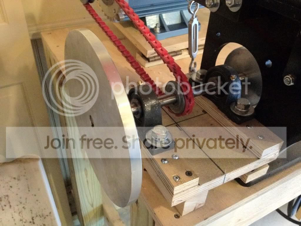

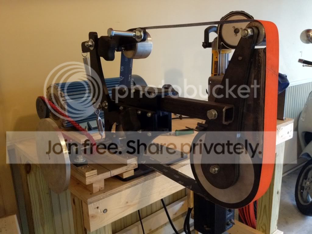

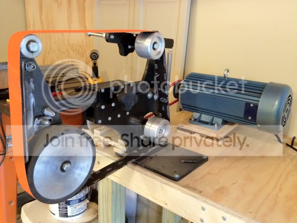

Medicevans, my multi platen is set up like (I think) you want yours set up - 2" and 10" wheel (I know you said you're thinking of the 8", which will also work) with the flat platen in-between. I can easily rotate it 180 degrees to get slack belt, or I can just remove the flat platen, which is a bit more PITA.
I also did the disc sander on the other end of the dive shaft. Here are a few pics:
That is exactly what I needed to see! That is sharp!

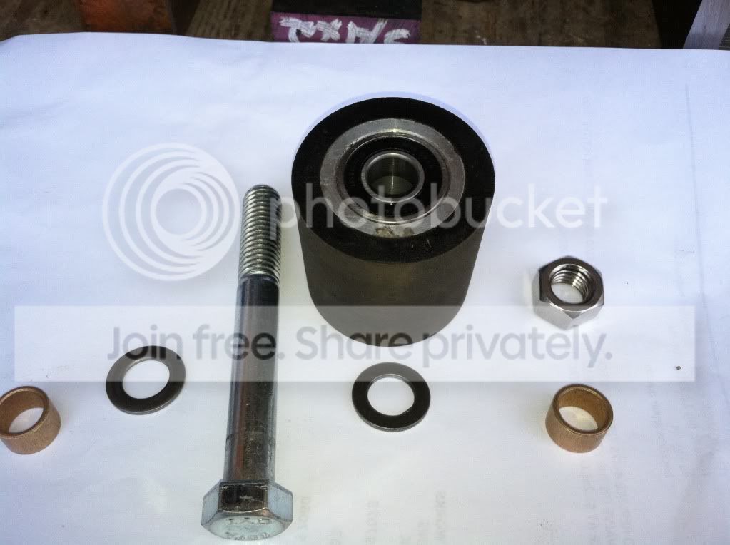

Here is one option I tried. I got some bronze spacers for inside the bearings, but they were too hard to align trying to get the bolt through as I pressed the bearing in first.(doh)...

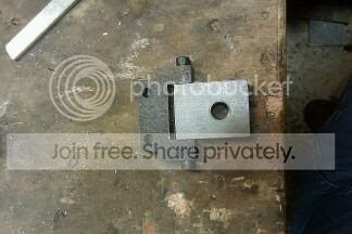

Here is my tracking part Chuck Richards made for me... It really helped improve the tracking.
I'm contemplating reworking the tracking arm like Ed Caffrey did. He redrills the pivot to the back, then changes the spring to a KMG type spring. He's ground a "few" more blades than I have so it seems like it would work.

I went to the store and bought shouldered 1/2" bolts in many lengths. I was able to get enough lengths that the ones I used had a full shoulder all through the wheels to help limit "wobble" like you get with threaded bolts..
