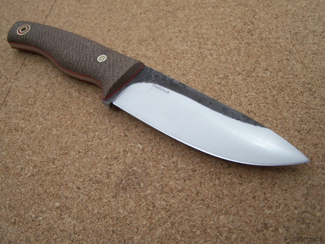

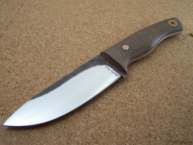

OK. Here's what I got. Its my Hunter model. The steel is 01 toolsteel. The Hunter is a wide bladed knife. Its 9.5" OAL with a 5" handle. This one wears custom burlap micarta from Shadetree (Fod). Its also got red liners, a brass and red bullseye tube, and a brass mosaic pin with red filler. All pins made in house. The grind is the convex sabregrind. No flat platten involved! A leather JRE sheath is provided.
I made a camp knife thats carryable, yet able to handle common camp chores. Camp kitchen work, batonning firewood, cleaning fish, and bushcraft chores, and even self defense are a few examples. It will be able to do light chopping, but isn't intended as a chopper at all. At camp, you'd probably have a heavier tool for your chopping fun.

I can't wait! I love this knife!!!
This turned out great Andy! I love the handles :cool:
