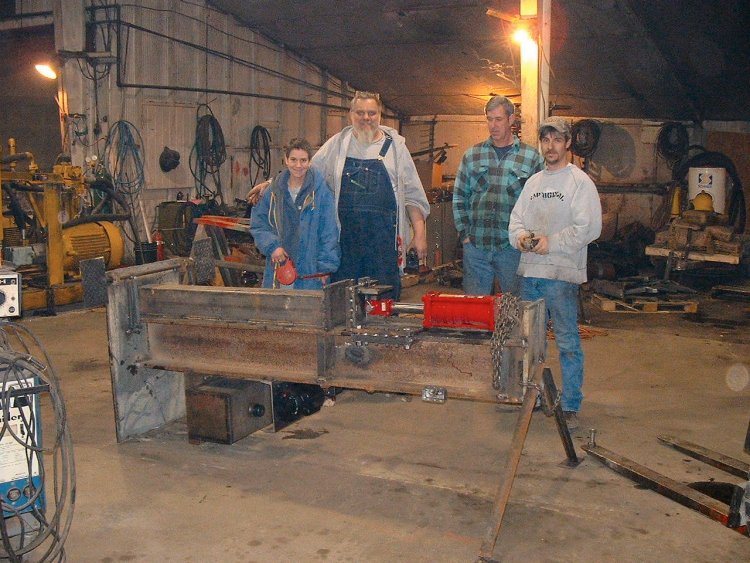

Those are some NICE photos of BIG presses.
Is the max pressure rating of 1500 psi labeled on the cylinder? OR, is that just the working pressure you it set at?
I'd be concerned with water in the oil.What are the chances the pump, cylinder, motor, and control valve all still work?Guess I'll find out... This is exciting...
I'm disappointed how this press' life went... I barely used the thing once I got it together and then it was just neglected!! If I could talk to it I'd say "don't worry buddy.... we're going to get you all dialed up!"

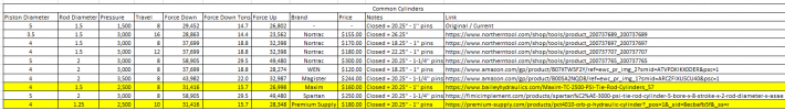

Remember, you can run a 3000PSI cylinder on 2400{SI, just not the other way around. Also, get the biggest rod size for a press. The 4"X2"X3000PSI cylinder would be my choice for your build ... and it is cheaper. If you upgrade your pump, the cylinder can handle it.
