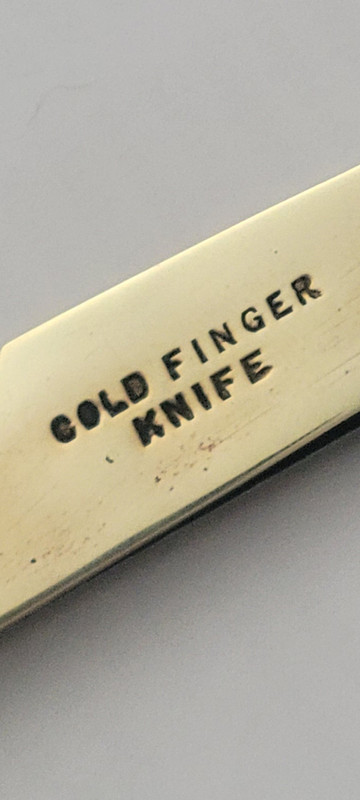

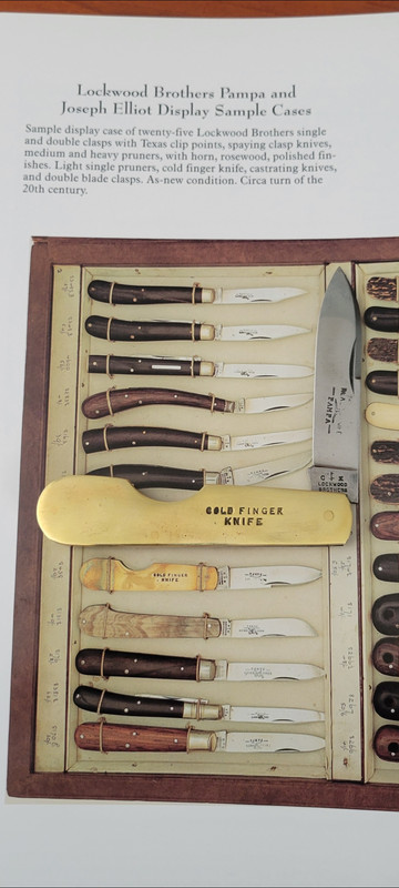

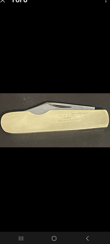

I've came across quite a few Lockwood Bro's. fakes on ebay. Here's a Fake vs. Original Lockwood comparison. Pay close attention to the mechanically engraved blade stamp. It's almost comical.
Fake:
Original:
