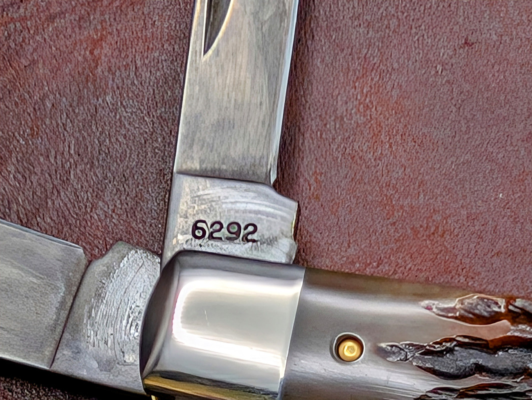

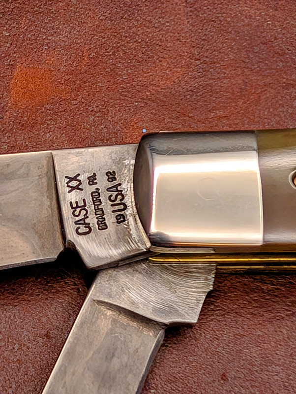

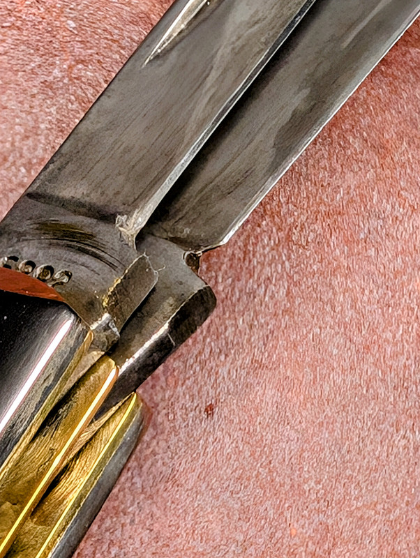

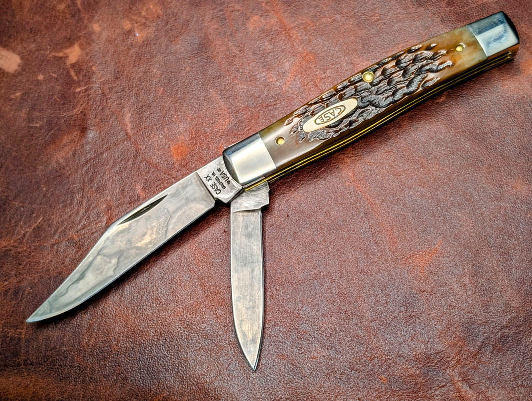

Looks like it may have been cleaned, but the tang stamp seems OK to me, don't see any weld linesHere's one for you. Auction is about to end, we will see how long the pictures remain. A few obvious issues:
Tang stamps are worn, blades are not
Pivot pin obvious, with grind marks over it - this has been apart
Pile side of master clearly shows weld line for the replacement welded blade
Mark side of pen has a funny plunge line with an angle in it, I have never seen one like that on a production knife. They got careless while grinding the new plunge line after welding the blade
