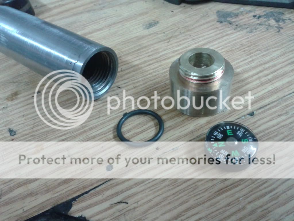

Try stainless? Although you're going to have issues with the plug potentially seizing if someone were to tighten it too much. And Anti-seize would be messy.
Do you have a gasket planned out? I would guess that a simple rubber o-ring would work well.

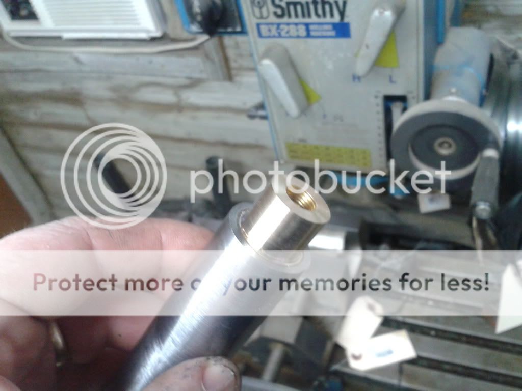

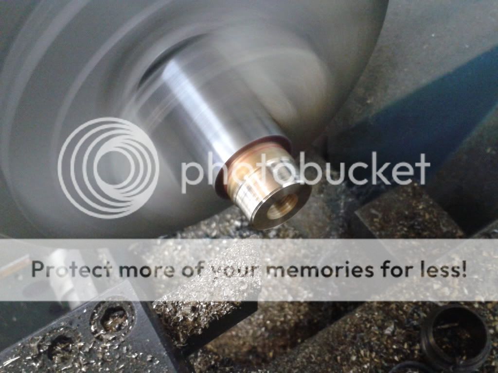

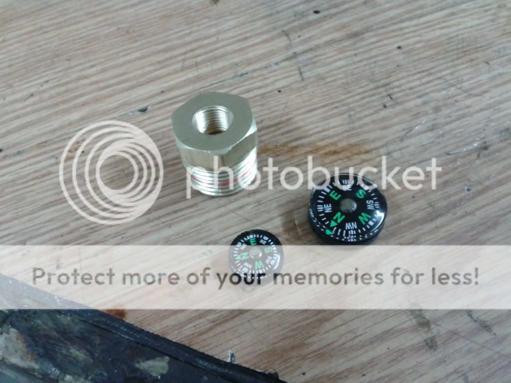

I believe I have just rectified the situation.......I just returned from the hardware store with a brass plug with matching threads, I think I can turn it down then add some stock by the threading/soldering. Then yes, take out the top thread and add a simple o-ring for a water tight seal. I got this! Thanks for your help C P! Will update the thread soon to see how it comes out.
My lathe will cut threads yes, but I don't have the cutter to do it. Don't really want to spend the $$$ and the shipping on a knife I'm giving away. (Sorry Hunter Sharp ;) )
Hey I don't blame you. My wife treats me the same way :D

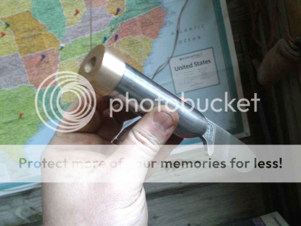

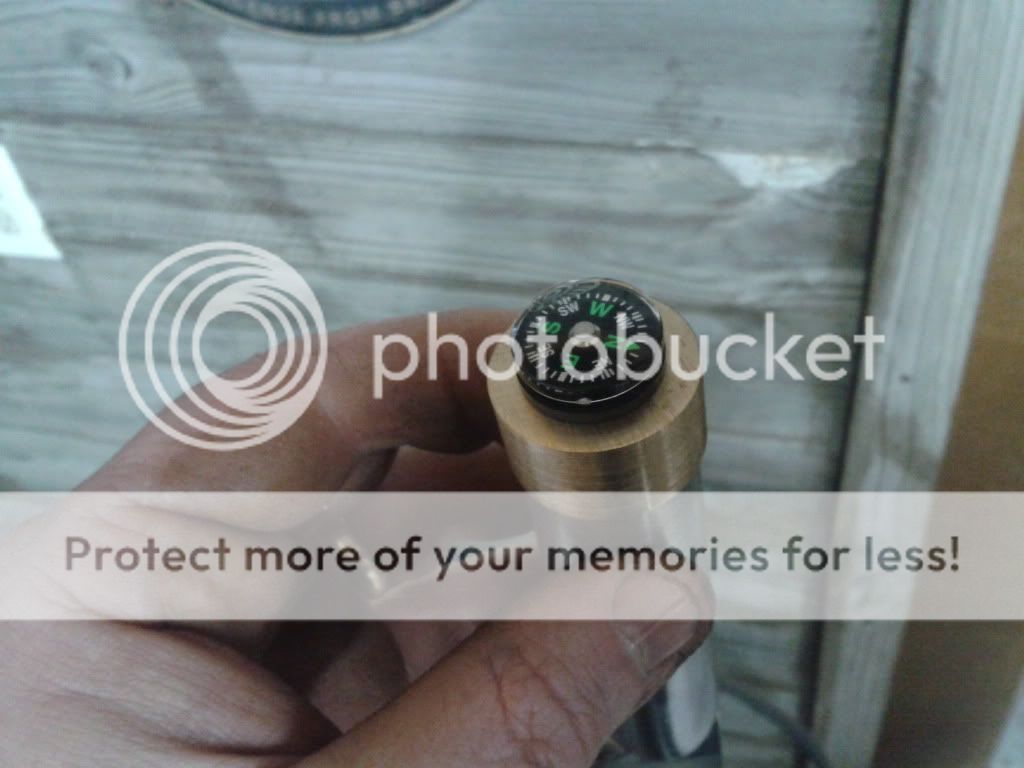

O.k. so I think I got the end cap bedded down, not finished but on the home stretch. The answer rests with a brass plumbing fitting mated with bushing bronze that I turned. Gonna use the bigger compass and recess it in the cap. Gonna make it smaller, but you guys get the idea. I think its gonna work pretty well. The non ferrous metal doesn't effect the function of the compass. The o-ring makes it water tight. Now I just gotta make it look cool. I have started multitasking. I managed to do most of this while on the phone with a very good customer tonight ;). Glad I still got all of my digits and OSHA dosent give a sh!t about me !
Progress looks good TM! After its all done maybe you could take the handle cap off and polish it up real good before its coated? Just a thought, might look good or might look bad.
