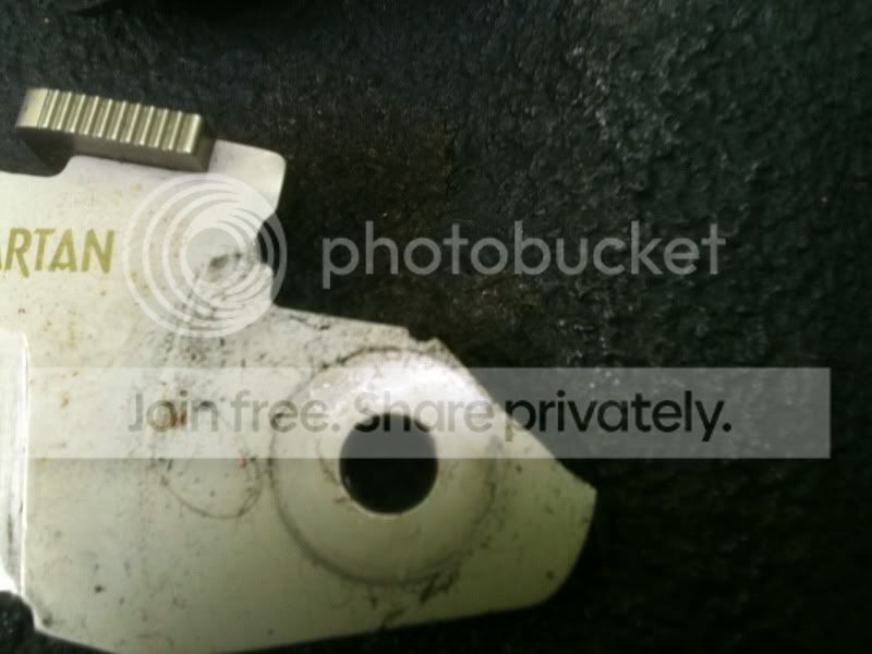

I broke my cold steel Spartan!!!!!
I'm no metallurgist but from the looks of that I'd say there was a flaw in the steel or the HT. Just what it looks like to me. If I knew what you were doing I could make a more educated guess.
Kind of tough to see but it looks like there is corrosion in the middle of the break. An inclusion in the steel, perhaps?
Got the blade off too- those pics are coming- that's when it get juicy:P

Give them a ring, my money is on a new one getting sent out, that looks like a flaw in the steel, not an inherent weakness in design.
If the tang broke before the scales buckled or the stop pin ripped out there was a flaw in the blade.
The scales should rip apart (Buckle) long before the blade would break like that in that model, no thick liners...

Long story short it got dropped very hardly- as a result of a painful trip(I don't like Brogans) it landed/bounced of of a large piece of deadwood(dense crap too, used for a tomahawk target)
Wasn't abusing the knife- was getting ready to abuse it and didn't get the chance it broke from my f'ing tumble
Sure it's been abused a bit in the past but nothing that could have any direct result with that

Stock removal blades sometimes have flaws in it, if forged I read somewhere it is not so likely. The Spartan's locking tab at the tang is bloody huge and normally would take a lot of force to shear off. I blame defects in the stock material or too high hardness from improper ht. :)
Not true.
If anything, it just adds more chance for screwing things up.
Forged or stock removal, the critical thing is the heat treating process (and not just the hardening part of it).
As has been said, forging doesn't make the steel you start with any better. The best you can really hope for is to not make it worse.;)
You tripped and fell with an open knife? :eek: That could have been much worse than a broken knife. I'm glad you're OK.
That's the funny thing- the lock is still in 100% working order- the blade failed
