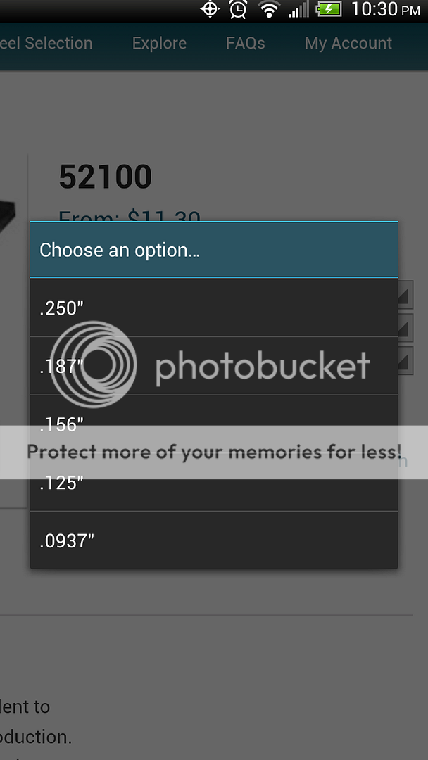

Here are the sizes available, I've only done 2- 1/2" and 1-1/4" and that was with my 1x30 and 1x42 but now I have a 2x72.
Looks like Aldo's???
Thats where i got the .265" thick piece thats 3" x 24".. I called and asked for that size... After blade show i may need to just give him another call and see if he has, or can get it thicker.
