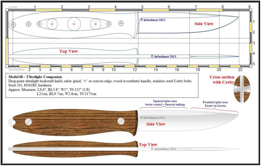

Here's my submission! I was so looking forward to this John!
My idea is to make a super comfy bushcraft knife (very smooth rounded handle, from every position), and also light so it can be brought along on long hikes. A squared area on the spine can give good control as well as being able to strike a firesteel. The front of the knife can be rounded to be easier on batons, should the need to baton wood arise. Acute point for wood working. The handle can be hollowed out in order to create a lighter package.
Questions:
1. How's the winner chosen? Poll or you choose the winner? Either way is fine by me :)
2. Would it be possible for the winner to put the handle on and make the sheath - kinda turning it into a collaboration knife?
Thanks for the contest and best of luck to everyone submitting a design :thumbup::thumbup:
1. Winner is chosen by a poll
2. I see no problem with that.

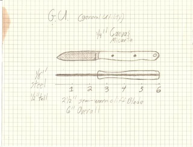

here's my entry john, email sent.
a small utility fixed blade to ride unoticed on the belt or in the pocket, i like the look of a lot of the slipjoint blades you see around. But you don't often see small blades like that on a fixed blade with enough handle for my four fingers (i have medium-large hands). enough to open your mail, dress a bird or cut a coolant hose off a jeep radiator. :thumbup:
