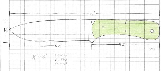

Here's what I've come up with.
1/8" or 3/16" thick, convex, flat or whatever grind you prefer, 1 1/2" at its widest, 10" oal. I'm having scanner trouble, all the info on it didn't scan. Maybe I can get a better one up later.

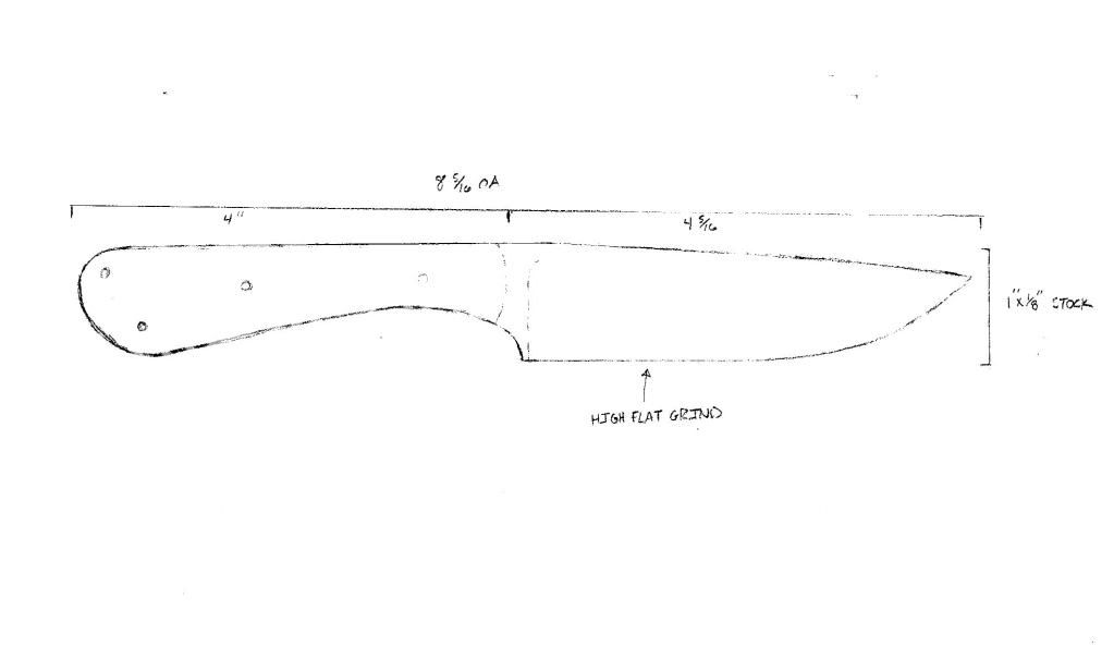

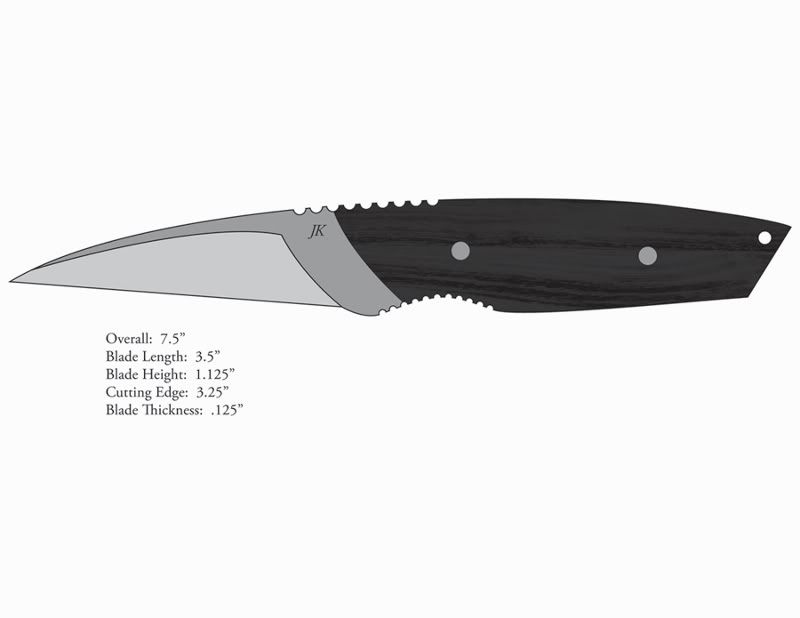

I'm thinking of a stout spearpoint type EDC.
picture.php
1 1/8" x 1/8" O1, 7" overall length
3 3/4" handle with two 1/4" pins and a 1/4" lanyard hole
3 1/4" blade length
