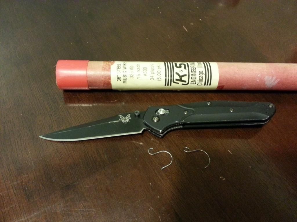

I thought about doubling up the springs, but there is not a whole lot of room in the slot they run around to have two sitting side by side. Maybe if they were one atop the other? Either way, I think it would definitely make it more difficult to open. The music wire that I used to replace the springs on my 943 might have been slightly thicker, or maybe more resistant than the stock springs because I did notice that the lock was slightly more stiff after replacing them.
I did this repair nearly a year ago, and this one has been going strong ever since:).
Here is the knife after the repair. The still-functional omega spring is on the left, and a spare DIY replacement spring is on the right. Behind the knife is the music wire that I used. I lucked out having this music wire stashed away. I think it came from a garage sale from when I bought a whole box of random stuff.
Here is the inside with the replaced spring.
It is really as simple as winding the wire around a pen to get the right shape (using some pliers), and then reassembling the knife.
Maybe for extra user-confidence, try a slightly thicker diameter of music wire than what I used. :thumbup:
As I'm not anywhere close to having any musical skills other than dirty limericks, when you say music wire, are you referring to a particular guitar string for example? If I walk into a musical instrument shop, what would I want to buy?
I am in the same boat. I just lucked out having some wire that was about the same size. I buy a lot of junk at garage sales if it looks useful, and that seemed like good quality wire. I left the tube in the picture with the sizing information on it. I would write that down and find a music repair store. They probably have some scraps laying around.
Awesome - Saved the pic. Thanks!
Never heard of "music wire" - musical strings are referenced with their instrument. eg: piano string, guitar string, cello string, harp string, violin string, etc...
IIRC it's Piano wire, and some folks call it music wire.
