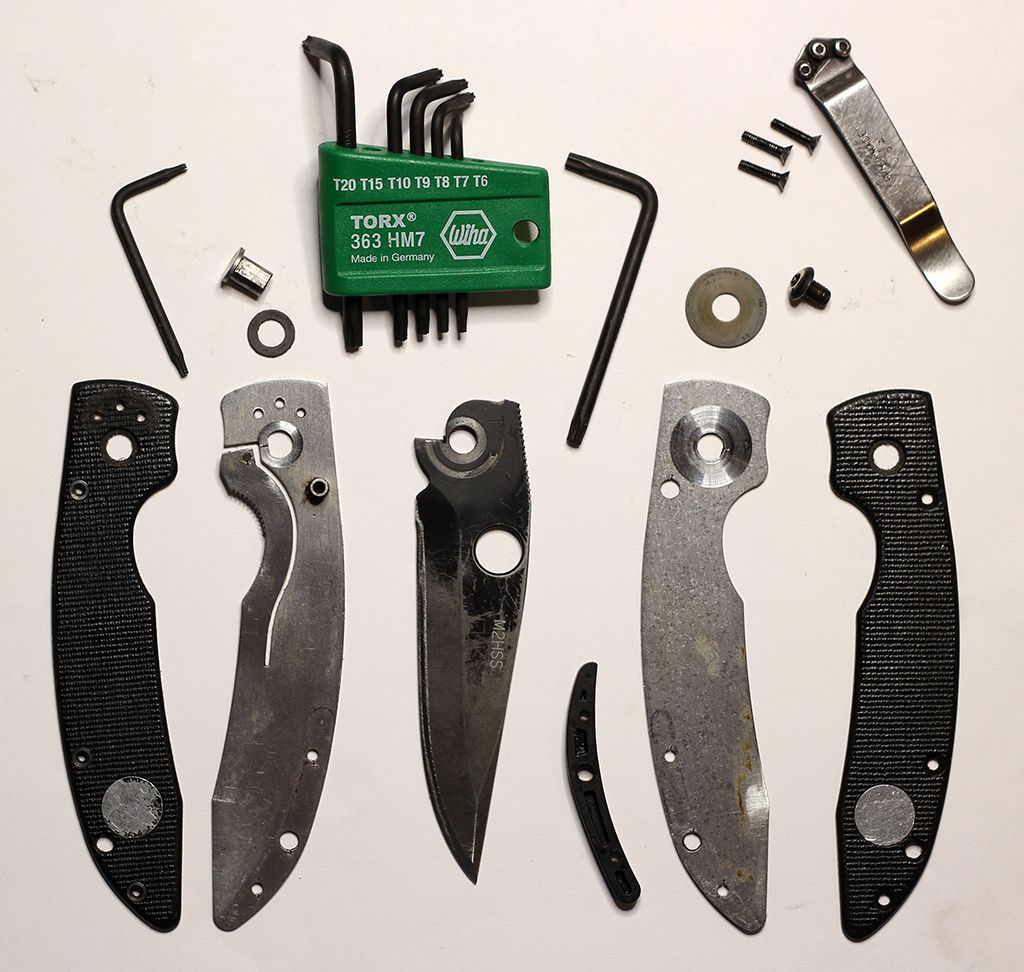

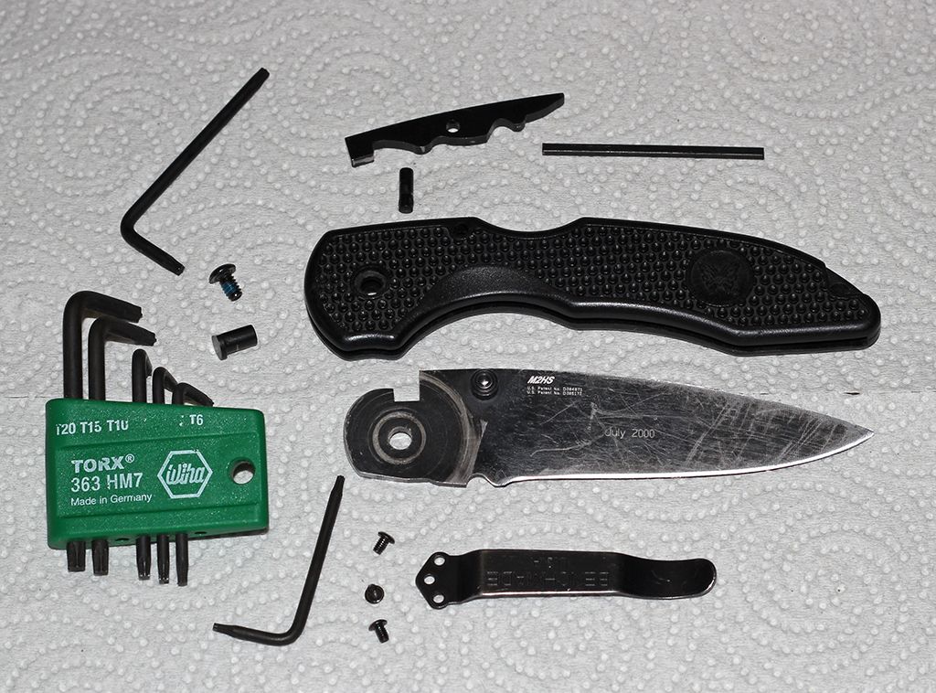

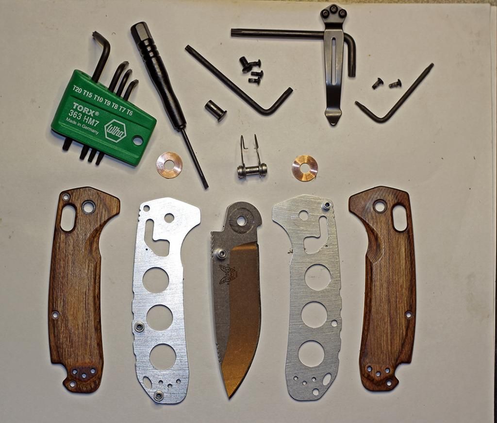

Can someone please put these back together for me? :)
Yup. In less than 5 min each. Of course that's because I have experience doing so. With each one shown. I can also change my oil, but that's only because I've done it before. Also, if you're posting those exploded views I'm sure you must know it doesn't require a complete disassembly to change the omega springs. Cheers!
