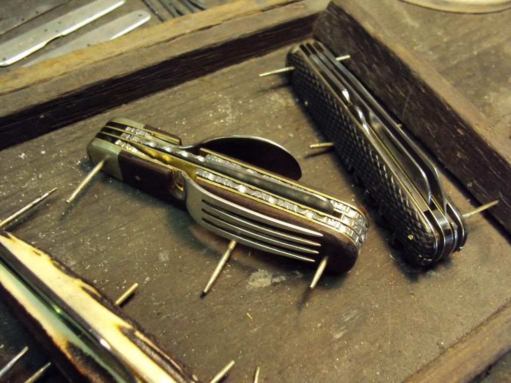

Here's a pic of a one off knife/fork/spoon..dare I say ? for eating a marmalade butty (sandwich) :D
Mick
That's a great photo Mick, The "hobo" is a cracker - but what has caught my eye is the Checkered Knife to the right! - that looks to be an awfully nice knife ( which sounds silly when describing Stans knives doesnt it? - which one doesn't?? ), and theres some mighty thick Stag going on in the left hand side as well!!

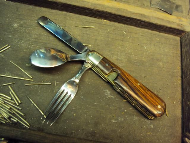

I've found a pic of that "hobo" finished..

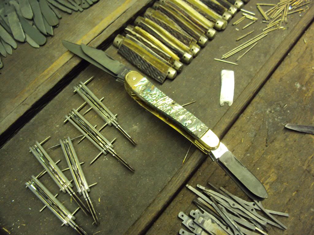

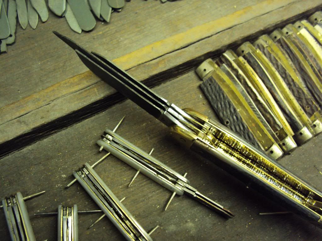

Here are a couple more pictures that show a few part made knives, the knives on the right I think were made for Sheffield Scene, they have tommied on bolsters and were made up with jigged bone, stag and horn. The large 5" knife in the centre was fabulous when finished, the thing has fantastic red abalone scales and 18K gold bolsters..a wonderful thing.
Mick
That turned out stunning, I wish I could see the Checkered knife finished as well, the big 5 inch knife would have been great to see finished!
Its interesting seeing the smaller knives with white scale being assembled as well, Both Jack and myself took many photos of Stans bench, I think that day he was working on 10 to 12 knives, and it was great listening to him tell us how he assembled the knives for fitting, then pulled them apart again before completion - basically building the knife twice!

What are "'tommied-on' bolsters" and "Sheffield Scene"?
Traditionally, bolsters were tommied (or hammered) on, rather than being soldered, the bolster being formed with a small bit (sorry, struggling to think of a more appropriate word), which fitted into the bolster hole in the liner.
Sheffield Scene is a Sheffield tourist shop, which sells everything from Sheffield tea-towels to cufflinks, books, postcards, and a few knives.
Just to add to Jack's reply. I think Stan used pre-made cast or stamped out nickel silver bolsters on those knives, the bolsters had a small pin sticking out. Stan places the liner over the bolster that sits in a special bolster die, the pin goes through the pre-drilled hole, then he rivets the thing together..
Sheffield Scene were a good customer of Stan's when he first went self employed, I guess he feels obliged to keep supplying them with a few knives now and then. I think Sheffield Scene (Nickel Blanks ?) also used to supply Stan with his nickel silver, that could be another reason..
