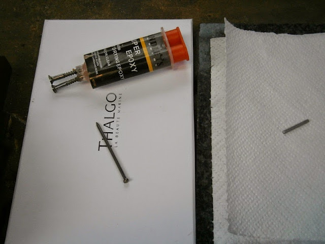

Once the glue was cured I could install a pin. I decided that a peened and domed pin would look best on this knife, and would be most suitable should the handle shrink or expand.
The fist thing I did was clean the dried epoxy from the pin hole, for this I used a 3mm drill bit.
Then I used a tapered diamond file to slightly taper the hole to allow some room for expansion of the pin.
I tried a bunch of crazy stuff to protect the handle as much as I could, but I found that it just got in the way.
This was a first for me, so I practised a fair bit before attempting the real thing.
Here is a little anvil type thing that I whipped up for this task. It has a dimple in the middle to locate one side of the pin as I worked on the other.
I use 5 minute epoxy to seal around the pin.
Cleaning the pin with acetone.
I tried to get the pin evenly peened on either side before the epoxy started to set.
Tap tap tap.
