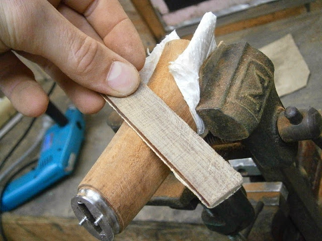

Now using 60 grit sandpaper stuck to micarta blocks, I refine the shape of the handle
I use a slightly curved piece to get into the inside curve of the handle.
The handle still felt a bit too clumsy for my liking, so I decided to sculpt it a bit.
Scooping out as much as I can with a 36 grit belt on the 10" wheel.
