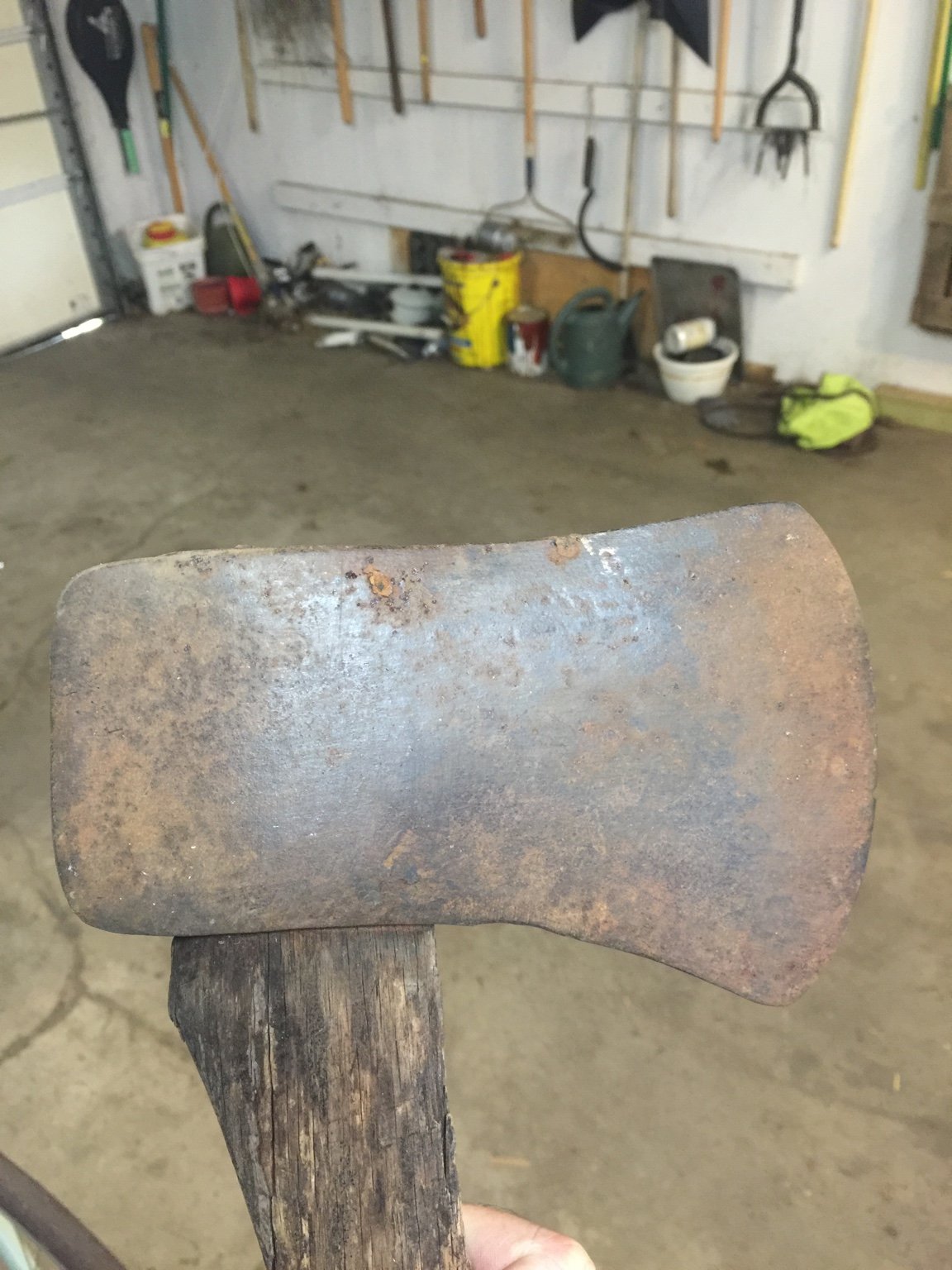

Felling axe I found all by its lonesome in a barrel at an antique store.
The handle is pretty weathered so I cut off the bit and it's currently soaking in vinegar.

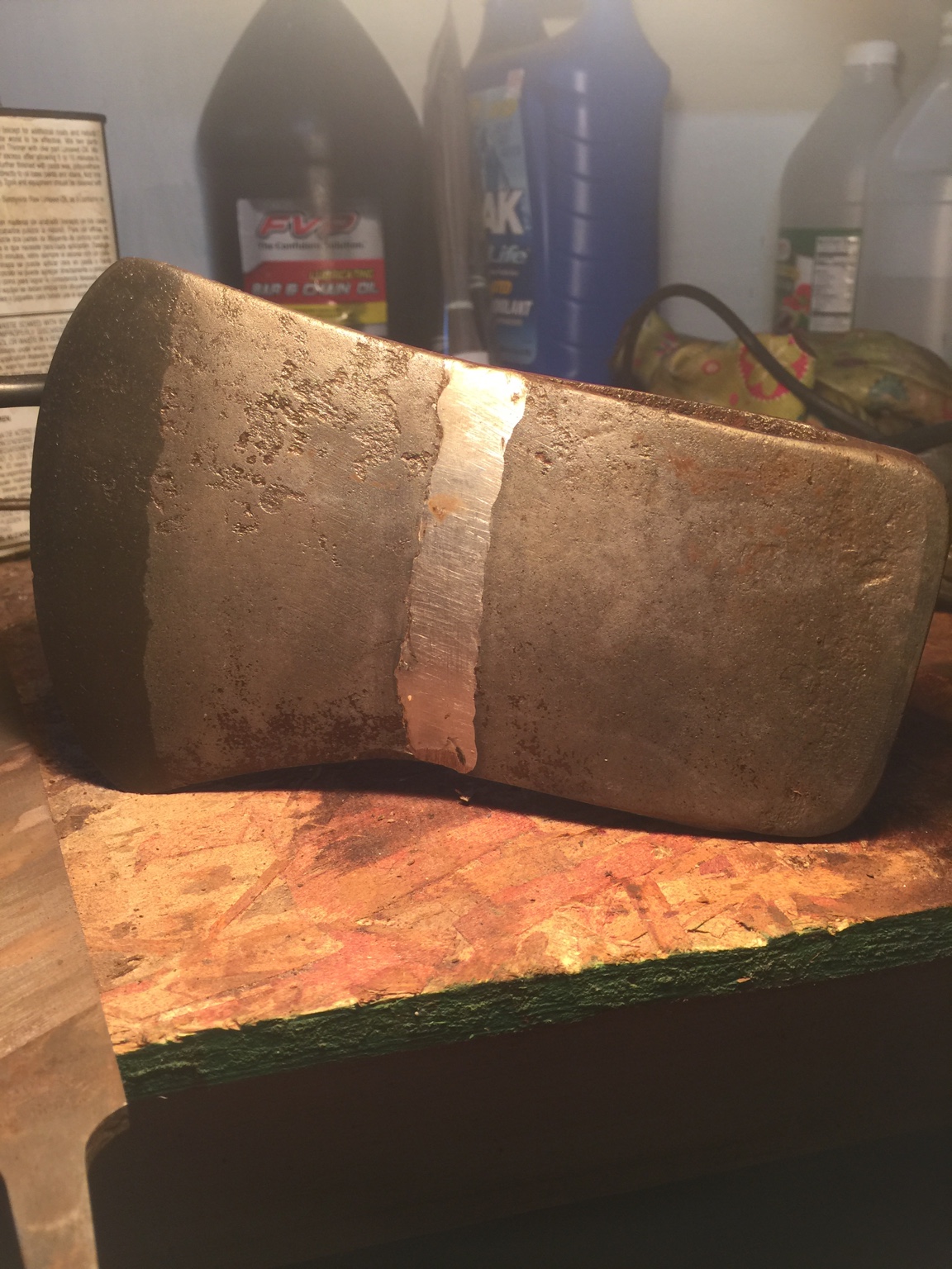

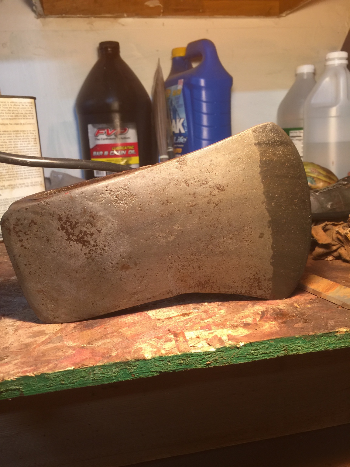

Edit: here is the bit after 24 hours in vinegar. It cleaned up well with only a little pitting. No makers mark that I can see.
Someone put a strip of metal down the side to fix damage maybe

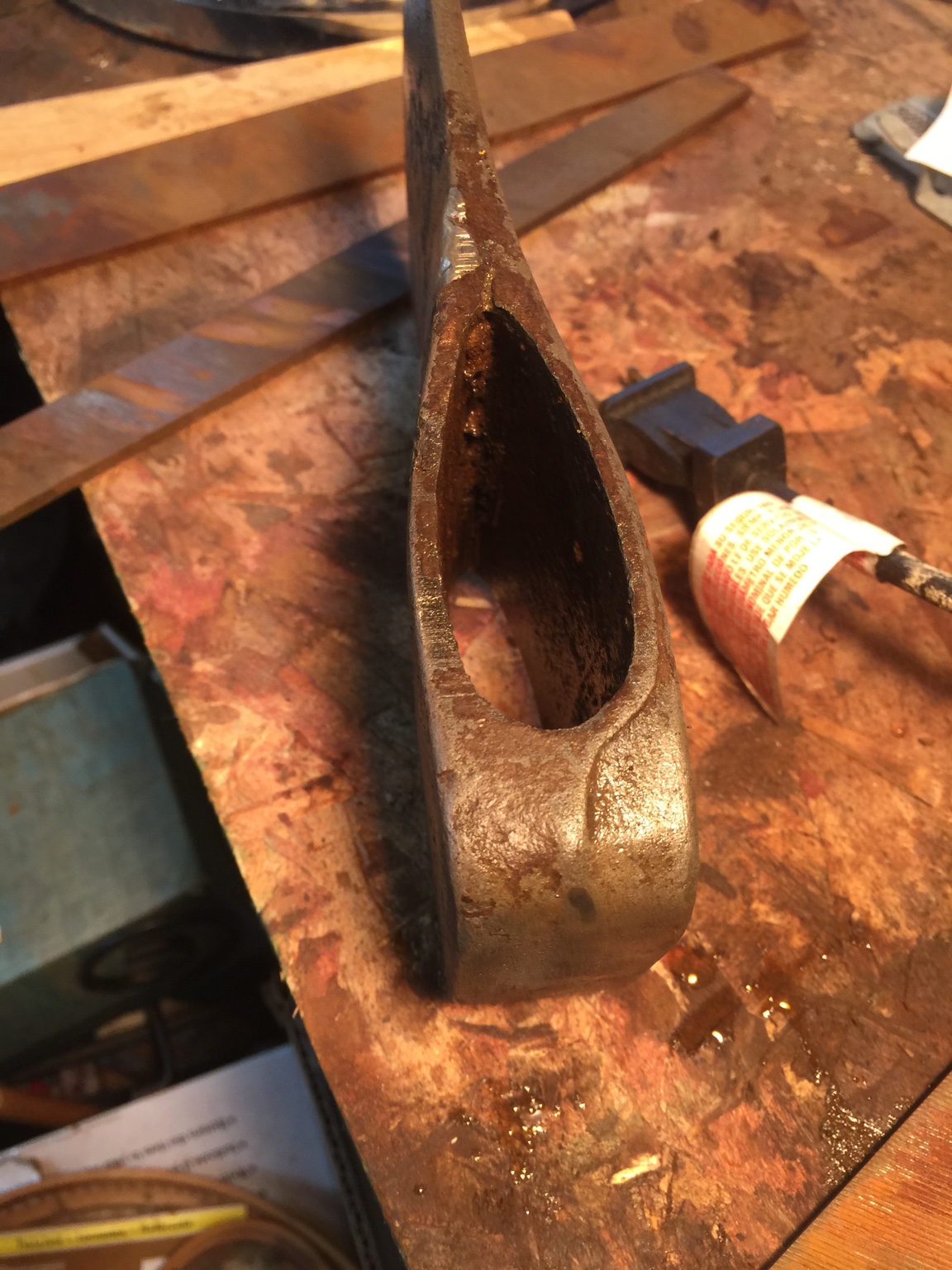

Here is the underside with a eye ridge.

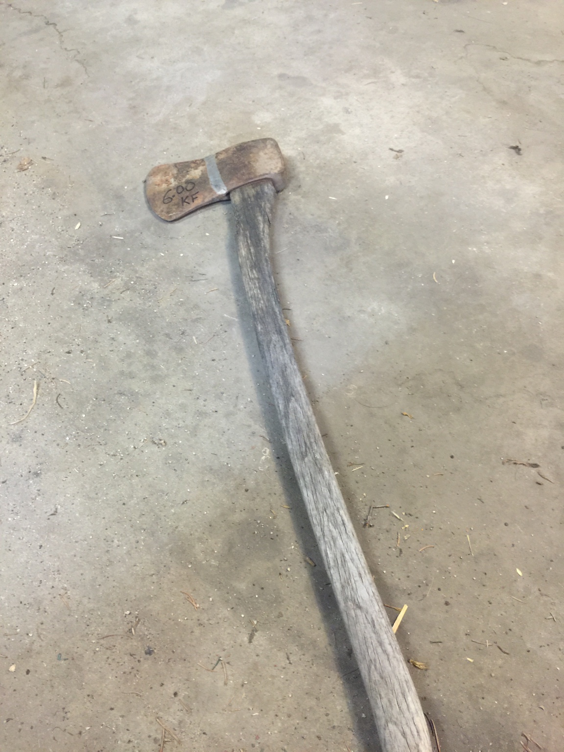

I don't know what's going on here but it looks very much as if someone tried to disguise a lethal crack with automotive epoxy (Jiffy Weld?). Were this a proper MIG or stick weld you'd see evidence of grinding in order to smooth out the weld and I don't see any sign of that.
Run a file over the joint to see how soft it is compared to the surrounding metal.
You may have learned a $7 lesson!
I second the notion of its been glued.
Unless it were stainless welded, coming out of vinegar would not left it that color.
Also see the rusty condition, its still visible.
Hope you have fun with it.
Shame it had to be welded or glued, looks like a nice design. Let us know if it is a weld or not cuz it might be worth reusing the steel as something else if it does turn out to be a bust.
