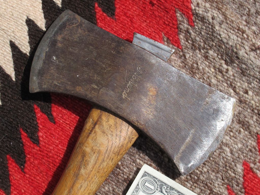

Slow day at the flea market this morning, just one little axe.
That's an interesting little axe you've got! The Norlund stamp is not overly prestigious but the Maine wedge shape of the head is quite intriguing. Makes me wonder who actually made this axe.
I believe so, I do not know a lot about Norland other than folks seem to pay a lot of money for them. I'm just going to clean it up a little, put a new wedge in it and see if I can trade it for a knife.

A fake, heck no! Norlund marketed inexpensive recreational use axes. They lowest bidder-contracted the making of these out. The current astronomical prices being achieved by Hudson Bay pattern Norlunds is entirely beyond belief.
OK, I got it. As stated previously I know nothing about Norlund, I did not know they were just a name that farmed out work. I thought they actually made products not just marketed them. Thank your for information, I just love learning new stuff. :)

I just got done fixing it up, the steel seemed very soft, I used an old file and it cut very easily. Then the emory cloth and the buffing wheel process to remove the file marks went much faster than any Plumb or True Temper axes I have experience with. I would not want to use it as I believe the steel to be too soft. It also has some uneven grind marks
Norlund hatchets, wrapped in cardboard and plastic, in the 60s and 70s used to be hung at front counter cashier displays at Mom and Pop hardware stores and Bait & Tackle shops much like beef jerky, Bic lighters and other promotional eye-catching' goodies are today. That Norlund (as a "World Famous" etc type bargain brand) didn't survive the shift over to offshore production says something about them but I really don't know what it is.
Second generation owners of the Norlund operation must have smoked/snorted/drank or peed away all the corporate funds or failed to keep up with the times?

In 1987 when I visited the Lewistown, PA. Mann factory they showed me Norland axes that had come off the line with their Collins axes. I have a number of the little Norland DB hatchets and some identical little Collins DB hatchets. In my 1970 & 1977 Collins catalogs Mann called these a "1 LB. CRUISER" They had a 16" handle from the factory and were stamped COLLINS instead of NORLAND. I also have a NORLAND stamped rafter. It is the only one I have ever seen.
Forgot to mention My 1970 & 1977 COLLINS catalogs also show marked SAGER axes stamped with "WARREN AXE AND TOOL CO. WARREN PA. The bottom of the page has COLLINS AXE, LEWISTOWN PA. So, at this time, all these came out of MANN'S Lewistown factory.
