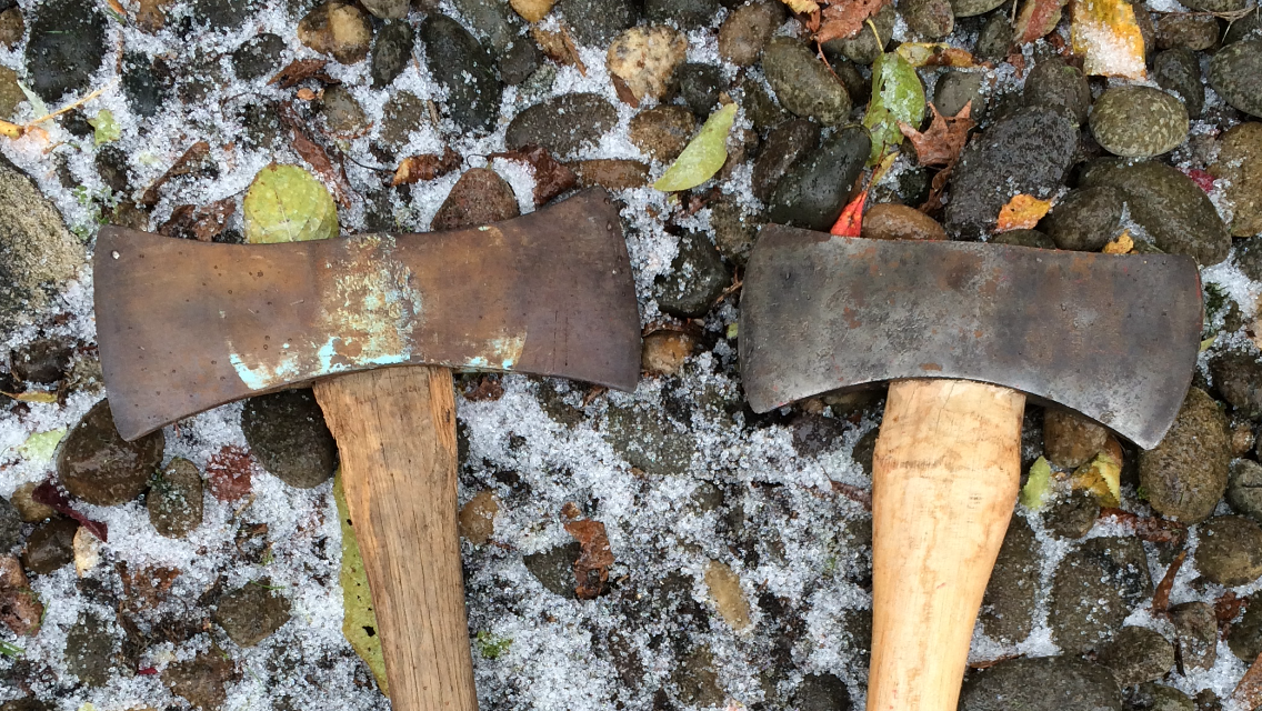

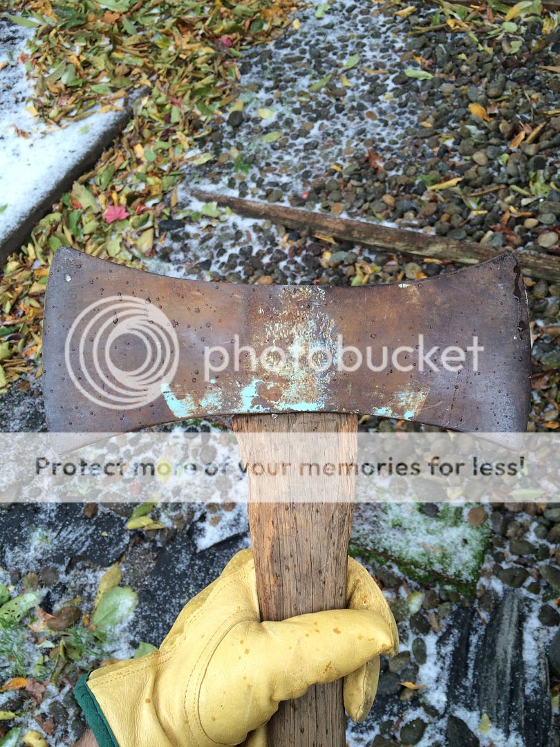

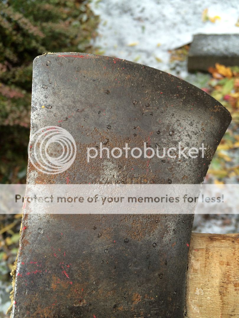

I got to work before the weather kicked in. We were sent away with safe wishes. Stopped by one of my haunts on a lark and these two followed me home
I'm not sure of the maker of the larger one. Seems to have some blue-green paint left on it. Looks quite usable after some care. Not wedged properly- just a metal one. It seems on there tightly though. Handle might be usable- it will need some thinning to get the chunk taken from it smoothed out.
The smaller of them seems to be a Walters. The handle looks decent.
I am pretty sure that large one is a Mann. Look for the stamp about were the paint ends, its small and probably light.
BTW, nice find!
I found Fulton was the only listed brand in a Sears catalog dated prior to 1900. In later years catalogs I saw the 'Razor Blade' line described as their top line axe - in their words as high of quality as was available at the time. I think those were an inserted HC steel bit design.
I like the looks of that axe. I've never liked the look of double bits with an upswept toe (peeling, swamping, reversible, etc.). Give me a Western or Pennsylvania pattern any day.

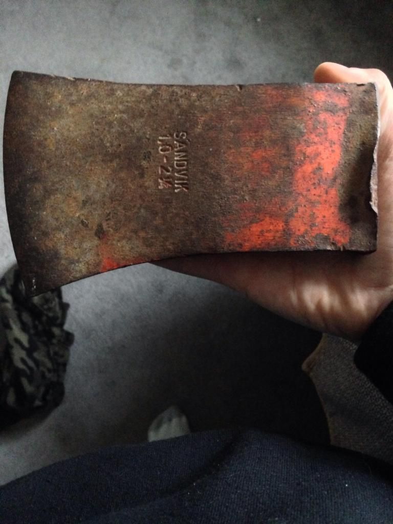

Getting back in the groove of things after Basic Training, picked this Sandvik up for 10 bucks today, no deep rust, mostly surface. Edge seems mostly factory. Not a Swedish axe buff, any info on them?
Sandvik reportedly sold off its Saws and Tools division (including axes) in 1999 to an American company -- Snap-on Tools, which re-named it Bahco. These days they mainly use the Bahco brand, but the Sandvik name is still used on some similar products (like hatchets) in Europe. I'm guessing that before 1999, they were made in Sweden, and after 1999 they could be sourced from Germany or elsewhere.
A forum search for Sandvik will bring give lots of results.
"In the mid 1990s Snap-On Incorporated, a global manufacturer and distributor of tools, entered the European market by acquiring the Spanish hand tool company Herramientas Eurotools S.A. In 1999, Snap-on acquired the business area Saws & Tools from Sandvik. The acquired business was named Bahco Group AB, a company with 2500 employees.[4]
In 2005 Bahco AB and Herramientas Eurotools S.A. merged, founding SNA Europe with Bahco as the company’s premium brand. Headquarter was established in metropolitan Paris, France."
http://en.wikipedia.org/wiki/Bahco
"1999 - Bahco Group AB is acquired by Snap-on Inc. Kenosha, Wisconsin USA. Snap-on is among the biggest tool companies in the world, founded in 1920 with the same visions as Bahco - to develop tools making the job easier, faster and safer for professionals."
http://www.bahco.com/asp/pubs/index.asp?lngMenuID=1255&lngID=1987
I happen to have the exact same one! Still some orange colour left on the head. 1 -2 1/4 stamp is weight in kg and in lbs (ie this is a boy's axe version!). I was with my dad at Beaver Lumber in Ottawa in 1960 when he bought it. The Canadian-made versions (likely Walters) were more expensive, and he always was frugal. Sweden's Bahco Industries is a competitor of Sandvik (both have been around for 120+ years) so it wouldn't surprise if one bought out (or relinquished) the other with regard to making axes due to overall declining sales during the past 40 years.
What you have is bona fide Swedish steel! Not melted down soup cans, ship rudders, engine blocks and hubcaps as to be found in a lot of recent offshore stuff.
Sandviks have a flat-side blade and are easy enough to sharpen with an axe file, especially since your's has not been used on roots and stones. The poll is mushroomed a bit but a grinder will fix that.
Likely you'll wind up doing some rasping/filing/sanding and fitting in order to get a standard US haft on to this but when you're done it'll be the best $10 you've spent on a recreational chopper.
