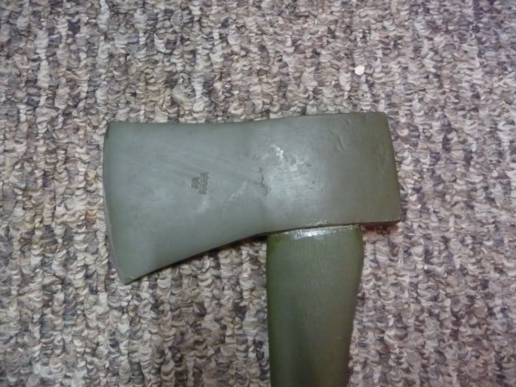

Im not sure what it is but i already removed it. It breaks like the cheapest epoxy...

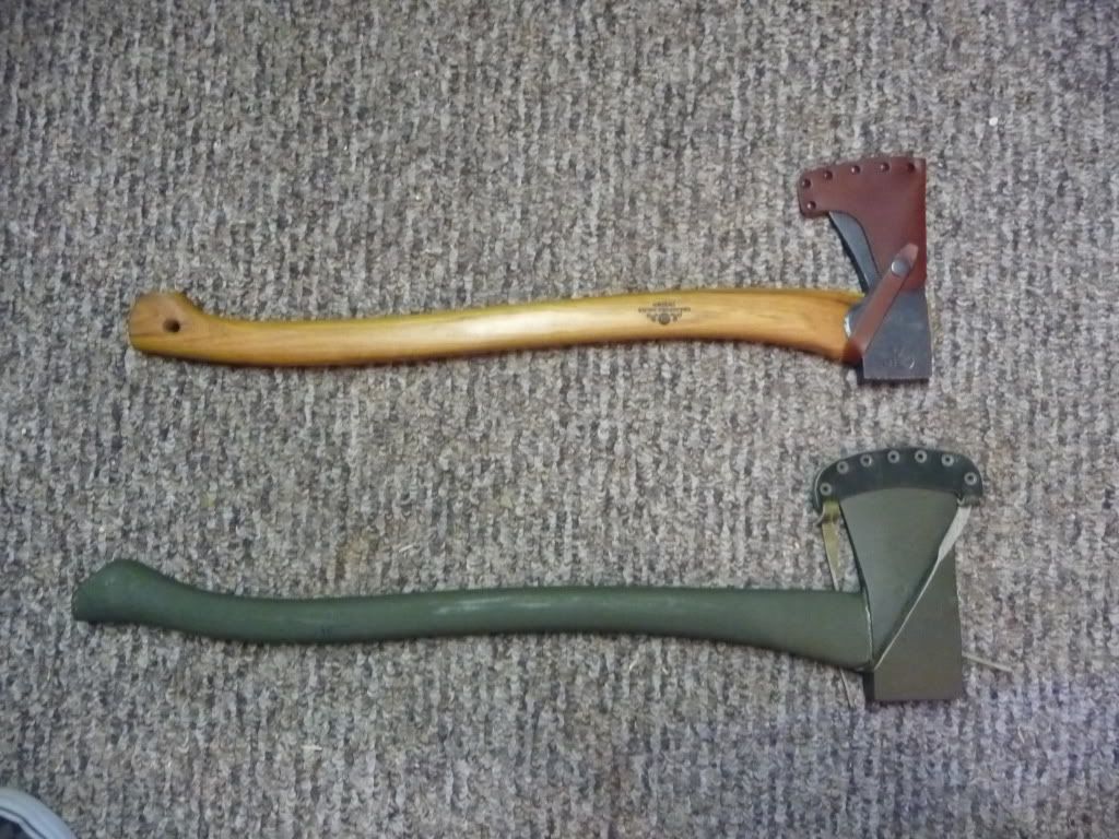

Well I guess I might as well share as well since I picked one of these up... Lucked out and got a Hults Bruk one :thumbup:
Next to the GB Scandi - slightly longer handle (28" vs 25") and with a weightier head (~2.5lbs just by feel):

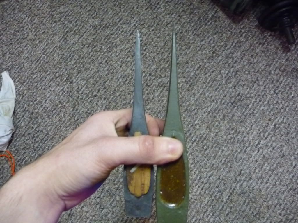

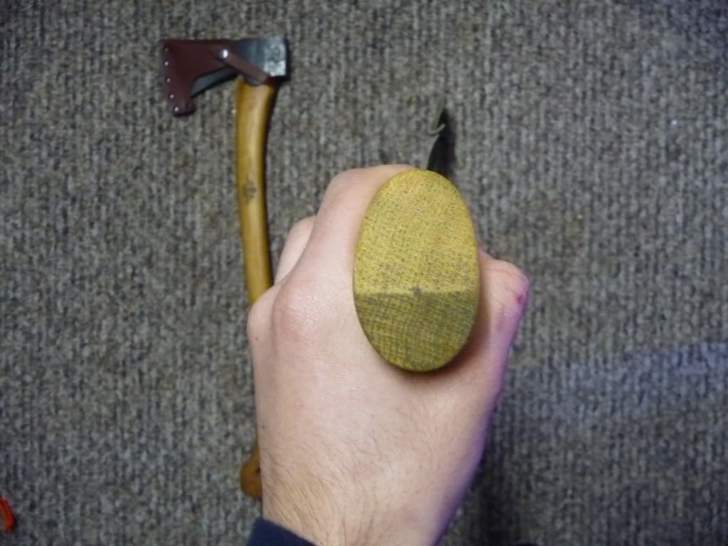

Profile comparison - definitely has a relatively thinner bit:

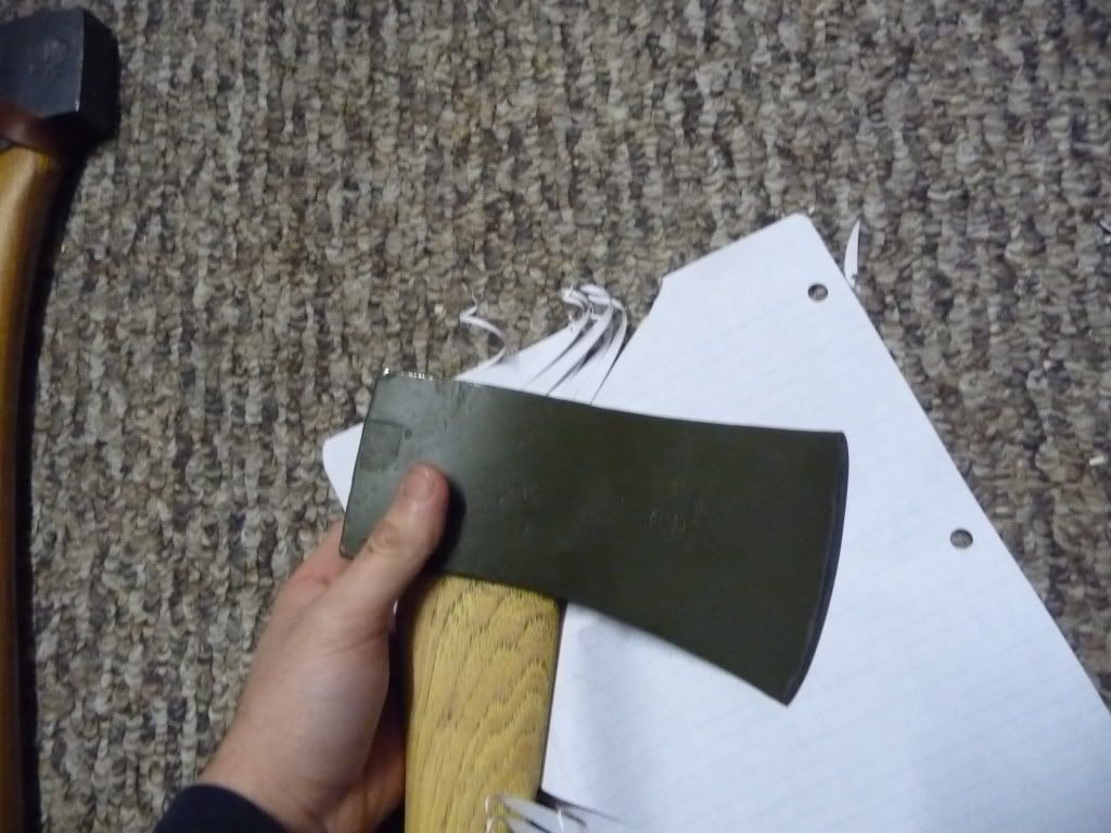

Markings "HB Made in Sweden" in the second one:

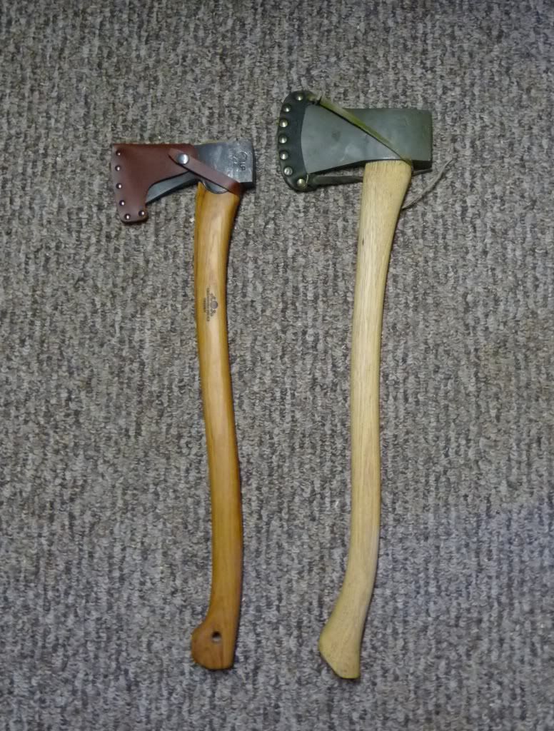

The grain orientation looks promising:
I then decided to sand off all the green paint on the handle and give it a couple coats of BLO:
This shot was meant to show the grain orientation - the blade alignment looks bad, but that's because I had the handle tilted to the side. The blade alignment is actually pretty dang spot on!
Then sharpened er up:
Steel isn't as hardened as a GB - a bit softer. Probably in the 53-55hrc range, but that's still pretty dang good...
