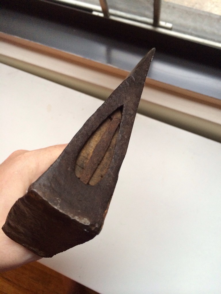

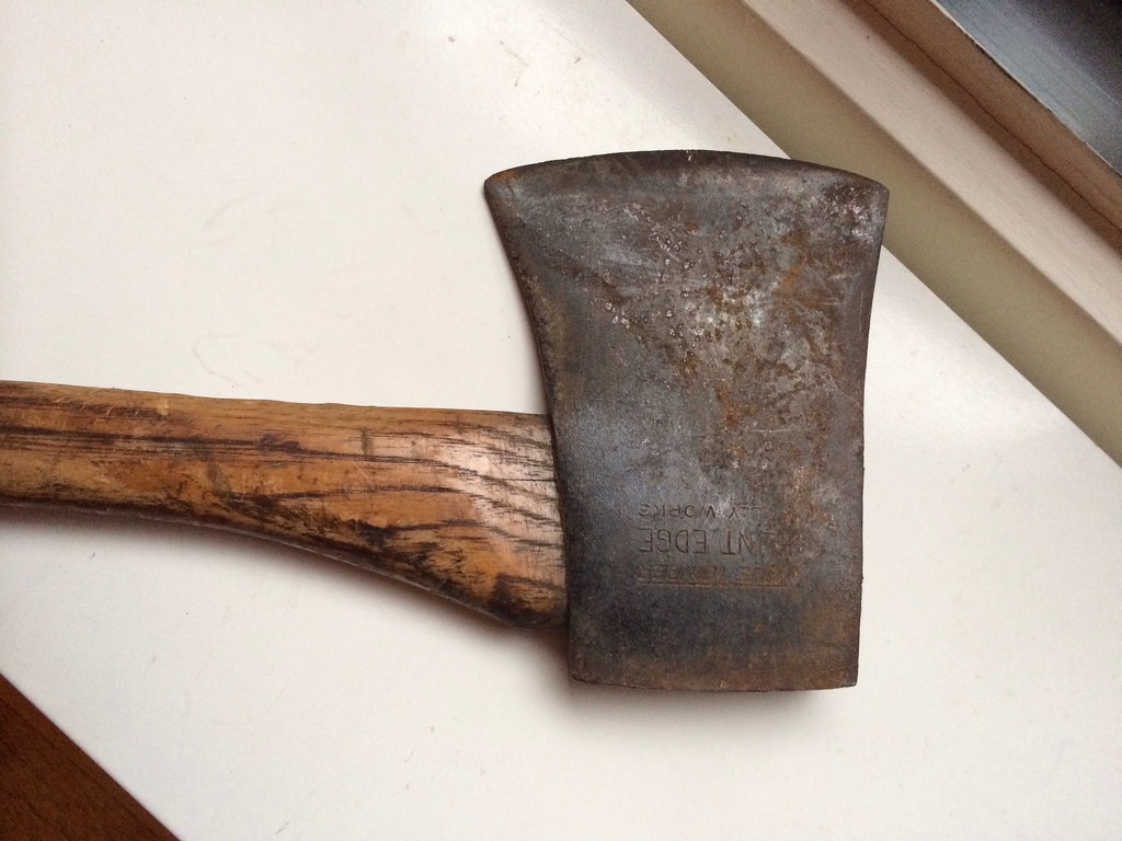

The Flint Edge currently has a really nice handle, but again a lot of metal wedging going on. I'm going to see how sound it is, but I'd love to keep this one as-is. Is there any way to properly replace/fill metal wedged heads with wood?
Yes there is and it's not difficult. Steve Tall posted a how-to.
http://www.bladeforums.com/forums/showthread.php/875111-Remove-an-axe-head-and-reuse-the-handle
I don't score like Steve did. I just shave the handle's shoulder under the head until the head can be knocked down about 1/4". Then I carefully cut the two sides of the handle protruding out the top of the head, being careful not to cut the wedge. Then pull the wedges out.
Also, metal wedges can sometimes be pulled out like this.....
http://www.bladeforums.com/forums/s...estion-Plumb-axe-head?p=11873903#post11873903

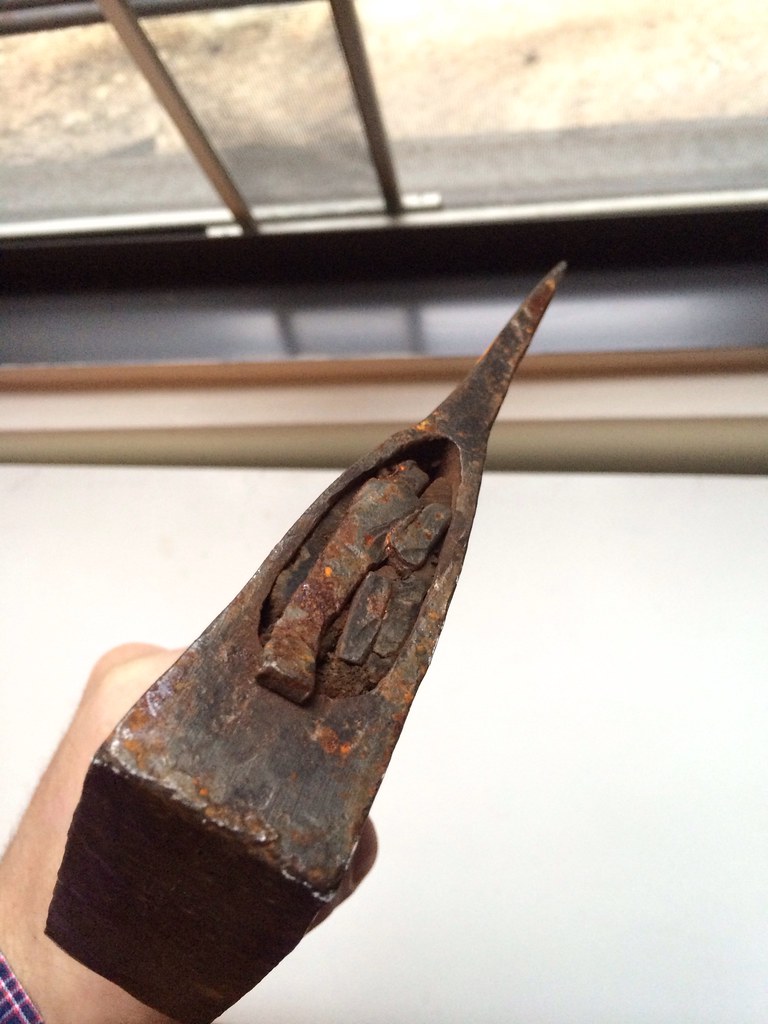

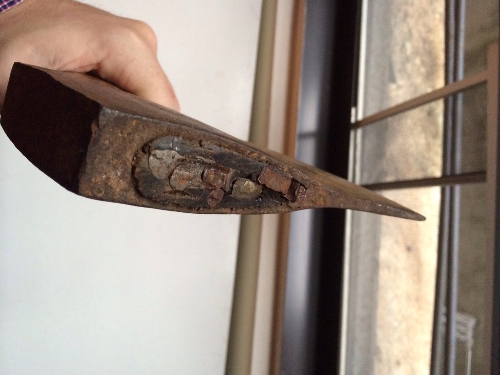

First, the Connecticut's situation. It's got two slim cracks below the head, both likely caused by the mass of metal crammed into the eye -- does this look saveable to anyone?:
Smaller crack:
Larger crack:
Metal:
It looks like I've got about 1" of shoulder or so that I could slide the head down onto if I can get the metal out, but I'm not sure if the metal in the eye has eaten up the remaining portion of the haft too much to successfully re-hang it.

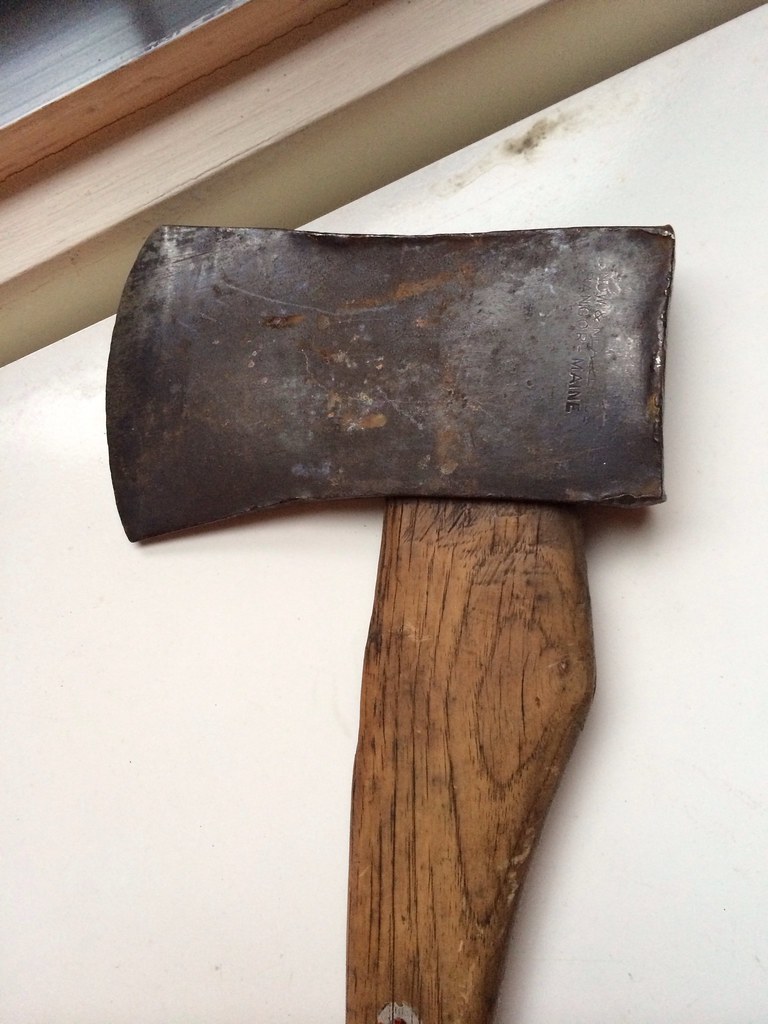

On the flip side, the Snow & Neally is on a much better condition haft that I'll be taking off, as the haft is too long for the weight/size of the head. I could potentially move the CT or the Jersey onto this haft:

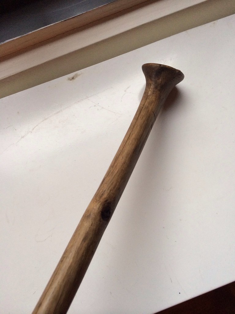

The fawn's foot is more like the knob on a baseball bat...

Sashea, Use a good quality glue on them splitts. It will hold. Stronger than the original if glued up right. The glue joint won't fail, if done right.

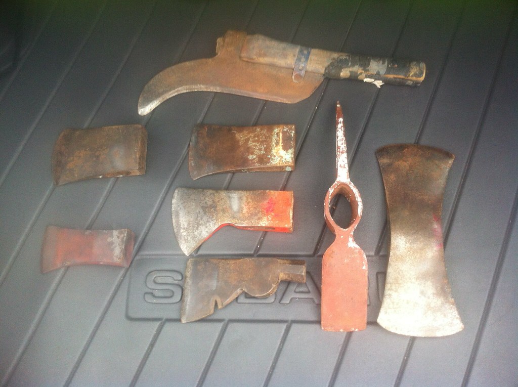

Lucked out and saw this as it came up on CL and was driving that way the following morning. Now I just need to order up some handles! The pick has US PLUMB 1943. The bottom hatchet has XLCR with an arrow through it. The DB on the right has 3 ridges in the eye an has a 3 5 (3^5) on it. Not sure what the middle hudson bay looking one is but it has ridges in the eye but no stamp.
