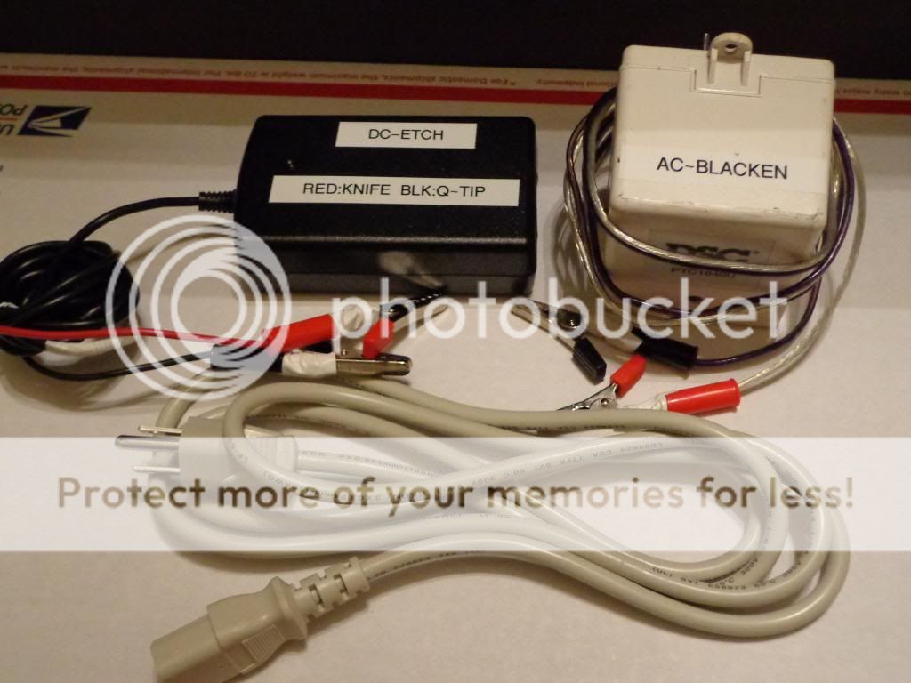

Here is a picture of the sweet etching set-up Granite sent me. Im really enjoying it. Im walking thru the house looking for stuff to etch HAHA

No problem, WW. Although..... while I was labeling the transformers, I realized that I had slipped into the country for old men without even noticing; applying the last label I suddenly had this feeling that I was doing something....out of the ordinary....and then, it hit me: nobody labels anything anymore....except for old men.

HAHA, Well im happy you did label them :D Otherwise i wouldnt know which was A/C and which was D/C!! Plus it made it so i didnt have to look up which to ground to the knife and which to clamp on the q-tip!!

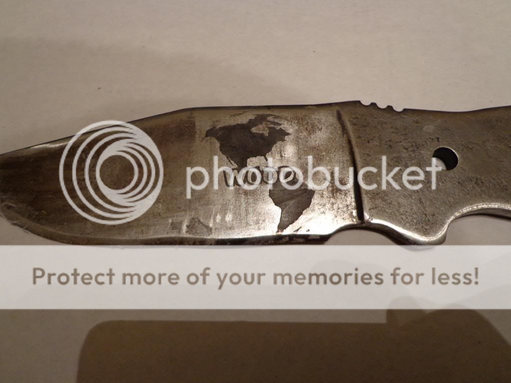

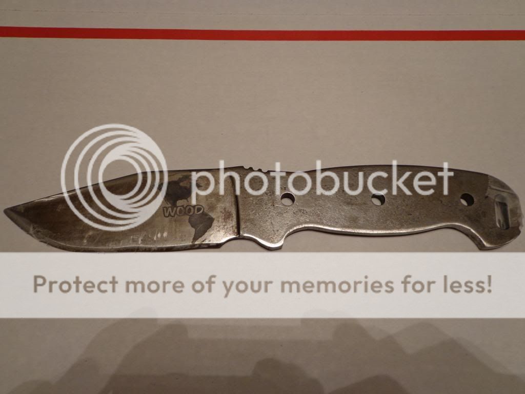

Went ahead and gave etching a try. I practiced on an ontario RD4, which is basically my test/practice/experiment knife. For a first attempt im happy with the results. I taped around the stencil and taped off the edge. I had to cut off the very bottom of south america because it ran on to the edge of the blade. And In person you can see that its lighter in a couple areas, but not by much, next time i will darken a little longer. I wasnt sure which to do first so i etched then darkened... It actually came out pretty good i think.
Got a couple more knives to practice on, but im going to make a quick and easy stencil myself for that so i dont waste the logo stencils. Ill prolly have to find some more steel to practice etching on too. I like it :D
Thanks again Mike for the sweet etching kit!!! and thanks JD for the stencils!! I may need to talk to you about buying some more of these when i run out if thats a possibility.
Hey that's great! Does it rub off with your finger or is it a deep etch?
Its a pretty deep etch. I washed it with soap and water using a scotch-brite pad and I can still feel it with my finger and my fingernail gets caught in it. The word "wood" is really deep. I went over that part a few times with the D/C etcher. next time i try this logo i will go over all of it several times with both the D/C and the A/C. But i maybe spent about 5 or 10 minutes doing that etch at most. It was pretty easy and fun. I like hearing the sizzle and watching it bubble up LMAO
I want to do the logo more RIGHT NOW lol, but i dont want to waste the stencils. They make it so so so much easier. I tried using tape to make a stencil for my initials on a machete, but it wasnt looking very even or straight so i abandoned that project LOL
Im going to play around with the logo as well to see if i can get it smaller to fit on most knives, maybe i can make the world in the background smaller but keep the word wood the same size. Maybe.
