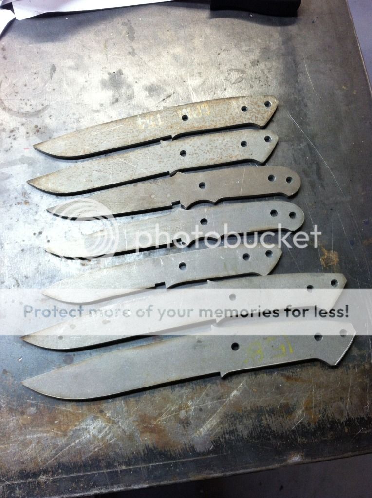

Top to Bottom: 2-Chutes, 2-Hideouts, 1-Drop Hunter, 1-Dixon, and 1-Wilderness all profiled. Mostly CPM154; one in S35VN.

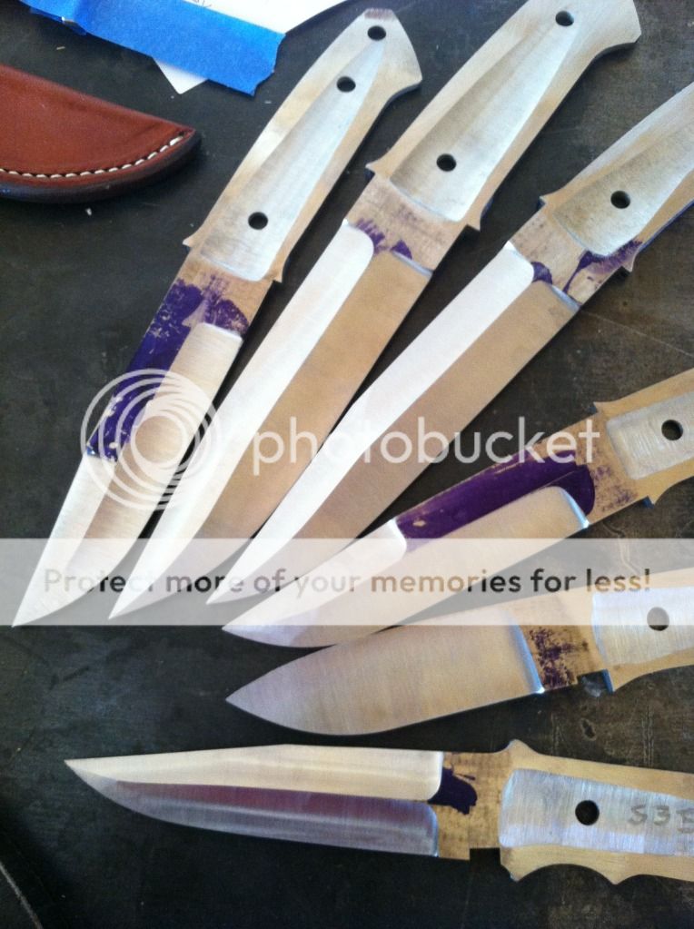

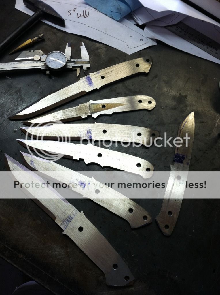

Surface ground and lead in grind done.

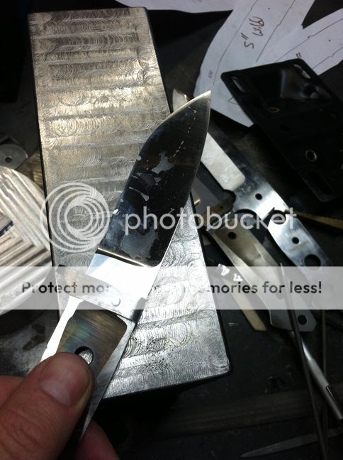

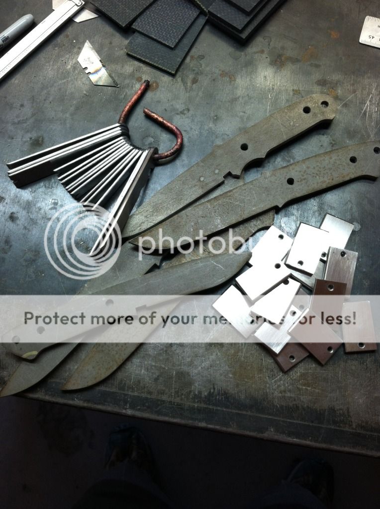

Rough ground and tangs tapered close to heat treatable; S35 is much nicer to grind than CPM154.

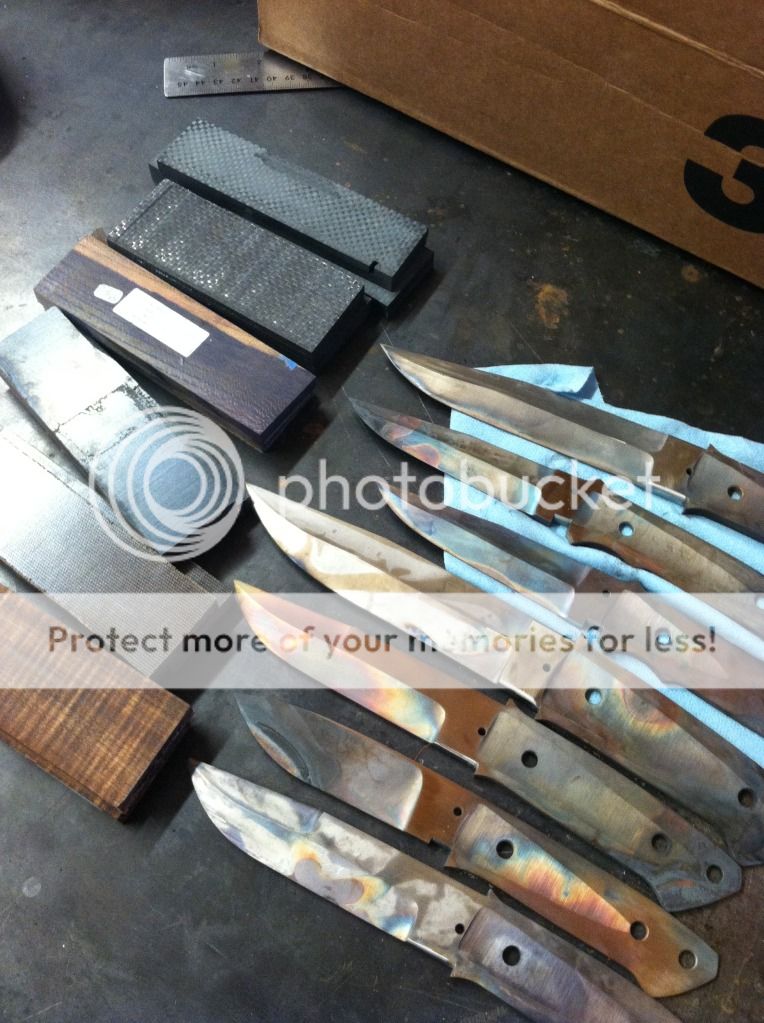

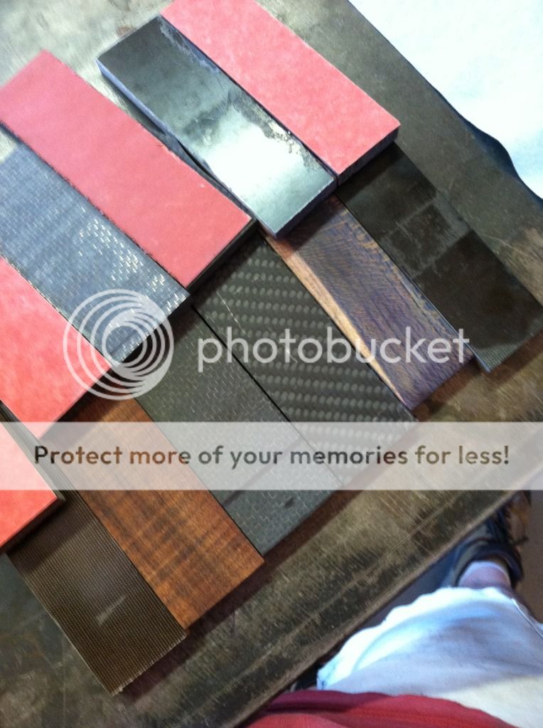

Post heat treat (all came out in the 59-60 RC range)posing with handle material: from L-R Koa from Mark, green canvas, black canvas, Sycamore from Mark, Lightning strike CF and plain CF both from Matt Diskin.

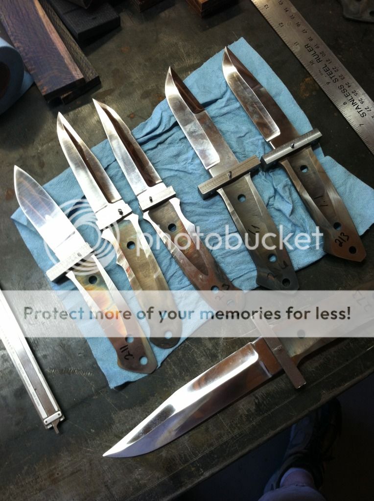

Ground to 2000P and guards ready for rough shaping, pinning and some will get solder.

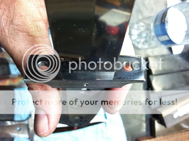

Guard/bolster fit on a:
Drop Hunter
Chute
Hideout (the very slight gap went away when pinned and peened)

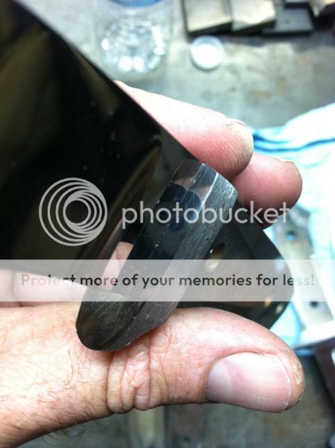

3 peened and pins ground; looks like they will be invisible (don't want to ruin my streak).

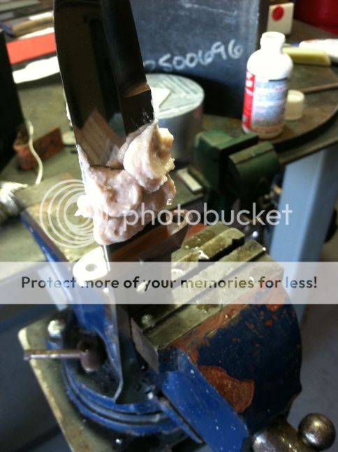

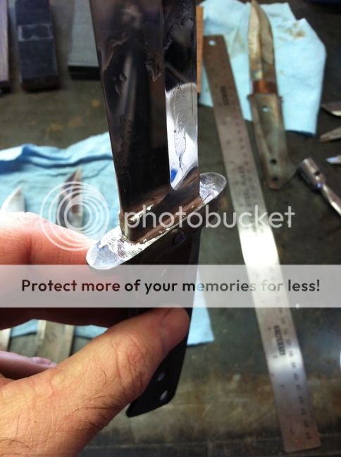

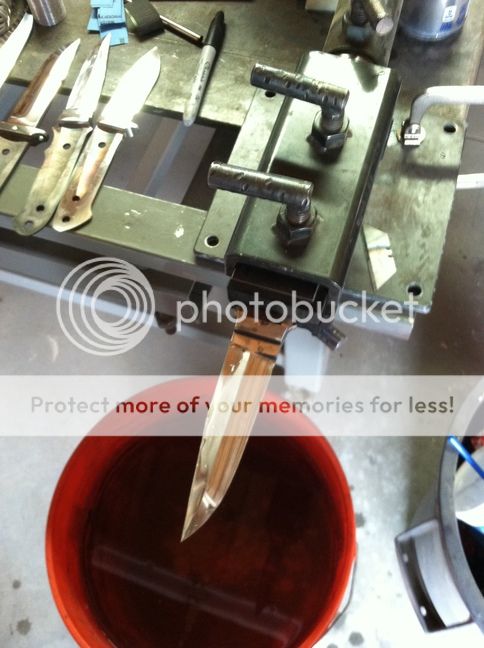

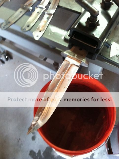

A Chute ready for solder. I use a heat block past (works well for TIG welding, works well here).
Ready for clean-up

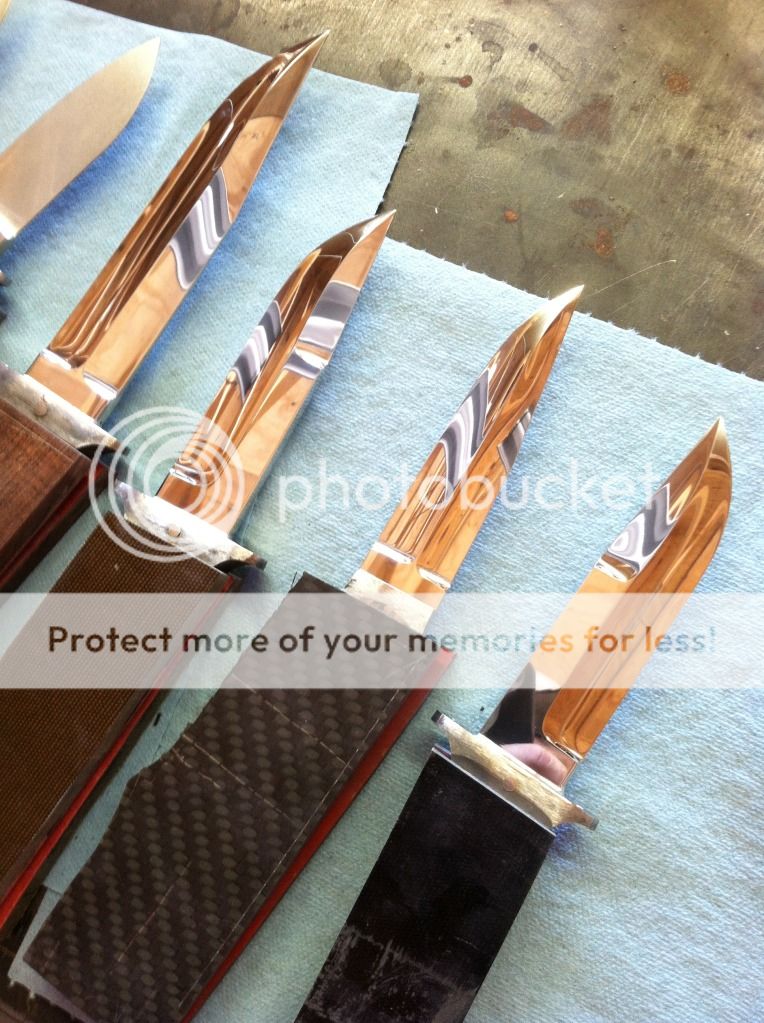

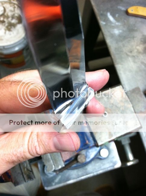

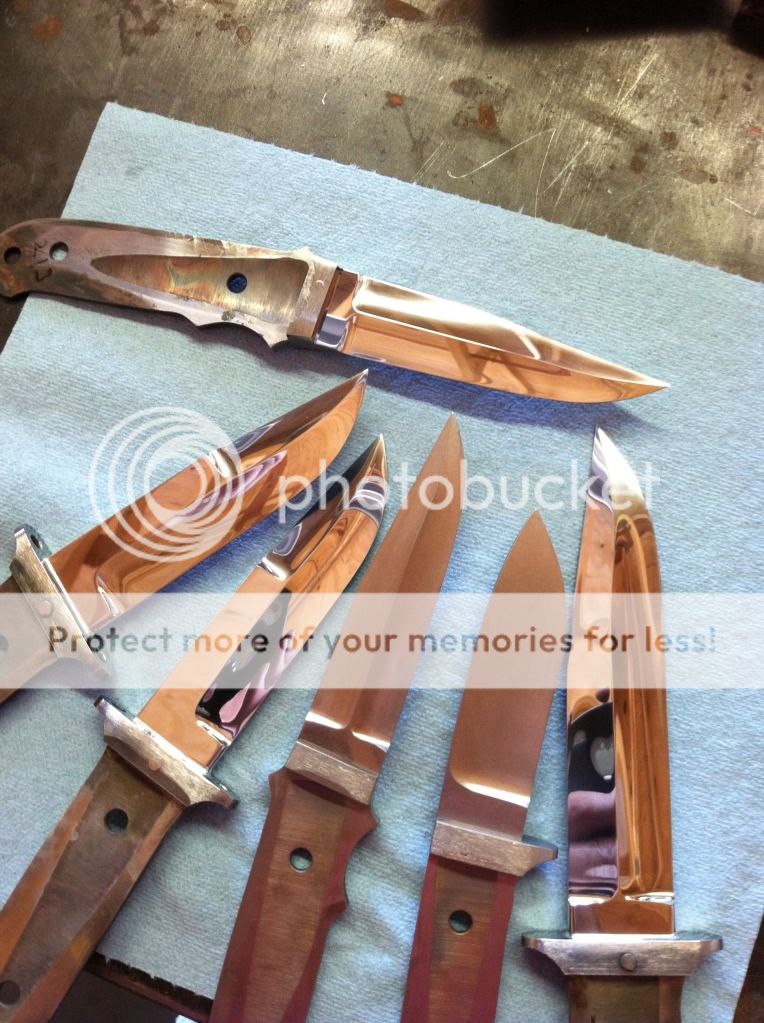

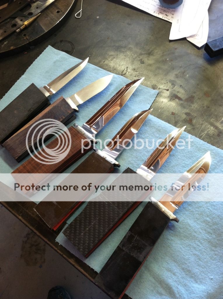

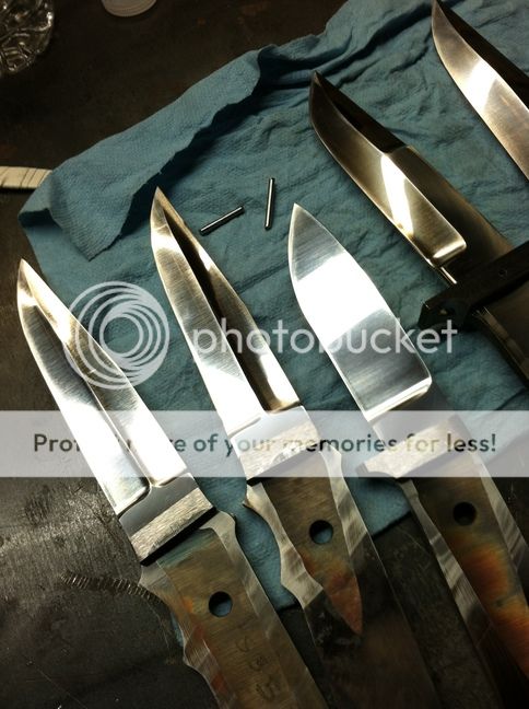

I left Saturday with blocking the blades to 2500. A few sanding blocks of G10. The radius is smaller than the grinding wheel so as not to weaken the grind lines.

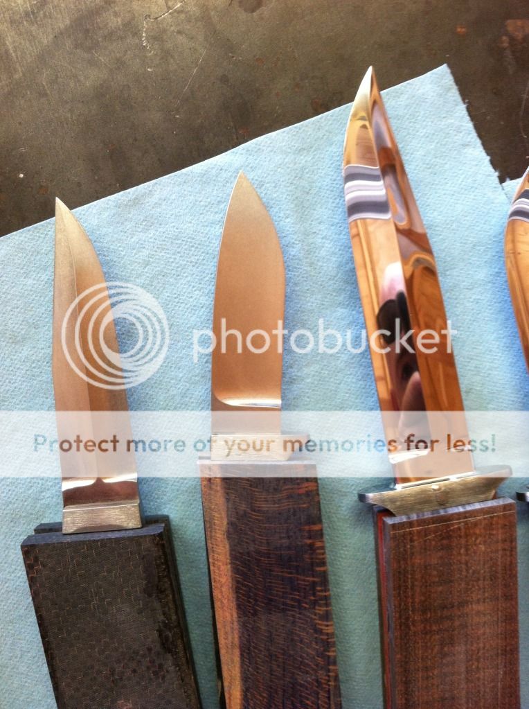

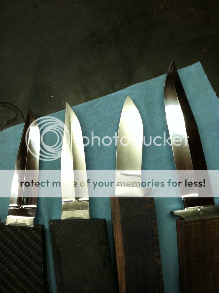

Four blades polished (pretty close to finished/ready for handle slabs) and two with an experimental finish. I call it a matte polish the blades are ground to 2000 and then tumbled. You can still see your thumbnail but definitely not the mirror polish.

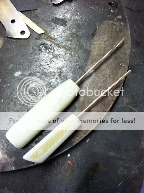

Handle material; most with liner material one without.
Handle slabs with compound angle ground in. It usually works out to 7 degrees for the guards and 4 for the tapered tang. Set up to check fit and with their prospective knives.
A better idea of the finish difference.

The user finish has me very curious. What more can you say about it ?
Thx
Not much to say it is inspired by a knife I bought from Marcus Lin.
Some people don't like the high polish and some steels don't polish so it fills the gap. The polished Hideout is CPM154, the matte Hideout is S35VN. I will never make the mistake of trying to polish S35 again!:thumbdn::eek::grumpy::( (Oh great I pulled a Wheeler with all these smilies!)
