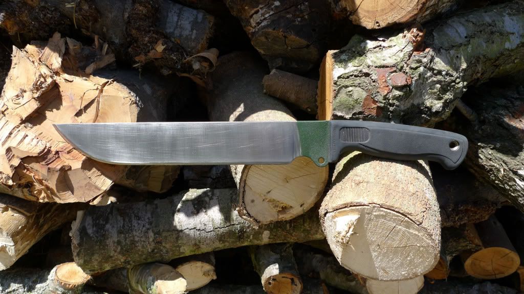

The knife looks great! I just got a desert tan esee 4 that i want to strip but it's got not even a scratch. If there are any pics of stripped knives i would love to see.
Mine was brand new, never used when I stripped it. Im just not a fan of coated knives.
I used my basic 11 to chop down a bunch of seasoned apricot limbs this week, and then used it to baton a couple of rounds until I realized how much faster it would go using my large true temper axe. In the process of batoning I really beat the crap out of it, trying to get it to go through knotted wood that is as hard as seasoned white oak. It pushed wood chips so far into the coating that I couldn't get it out with sand paper or other chunks of wood scrapping at them. If I have to take a screwdriver to a knife to get wood chunks out, I'm just going to strip it and not have to deal with it at all. Wood chips being stuck in your coating is an issue because it makes kydex sheath fit a problem and it can (theoretically, but probably not enough to be an issue) introduce moisture to a single point in the blade and keep it there for long periods of time.

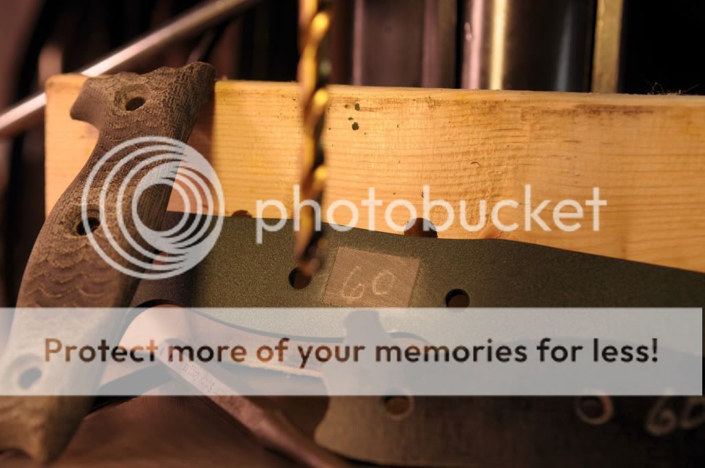

LVC - When I pulled the handle scales from my Skinny Ash there was no coating.
Not sure if this is the norm?
To clarify, here is what I found

Hmm. Interesting. So you think leaving the coating under the slabs is a better option? We're about to yank the slabs of my BJ in order to polish that too.
The shop scratches in a mark and then covers it with a piece of tape so they can powder coat it but still have an identifier for what scales go with it.
In theory, I would like to be be able to remove my handle scales and put them back on whenever I want for two reasons; it lets me sand off corrosion, and it allows me to replace the fasteners when they get damaged (skewing the scales). If I can't have that, then I want to know theres something under there preventing rust from building up.
I think the idea of having non-removable scales with uncoated INFI (besides having less moving parts and being easier to manufacture) is that INFI is very rust resistant. You could soak it in ocean water for a month, take it out and start using it again and it would take decades for the handle to lose strength because of rust build up. Even if thats the case, I don't like the idea of it, it's just something I want to avoid even if it's 'not a big issue'. By leaving the coating on the tang (even though it's not completely covered as shown by the un-coated identifier square in the pictures) rust is much less likely to occur.
If your going to reattach the scales with a set of screws and standoffs, or any fastener that lets you take the scales off then it's much less of a worry. You can take the scales off at any time and sand the handle down and then put the scales back on.

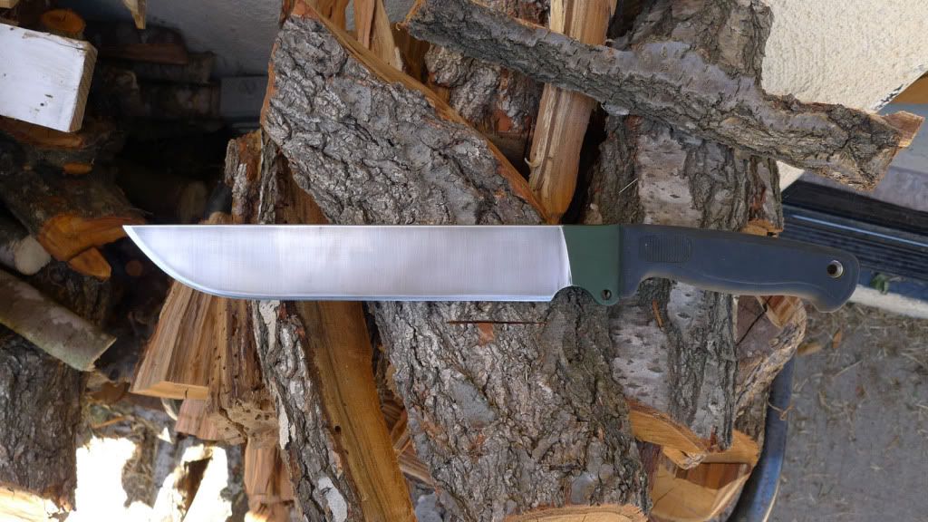

My newly stripped basic 11:
was the basic 11 pitted under the coating?
No, the classic INFI pitting is found on flat surfaces that never get hit by a belt sander/grinder, places like the ricasso or tang. If I removed the coating from the ricasso area on the basic 11 shown above there would likely be pitting there.
At least, thats how it's been in the past. I haven't seen that many newer-production pieces that have been stripped. I'm just assuming that it's a property of INFI and Busse Combat is still leaving the full stock thickness area's unground.
I like it :)
The coating keeps it from rusting on all the places that aren't getting used, and I can sand off the rust/wood chips from the places that are. :thumbup:
