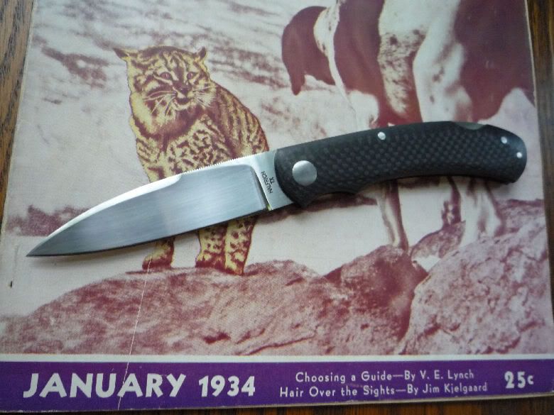

Jerry's LB-5's are great light carry folders. I don't have many lockbacks, but sure glad I have this one. This was his first with a modified spearpoint blade, and Jerry had it in his pocket when I purchased it at A.G.'s show. We were both happy. :thumbup:
Look forward to hearing about Jerry's take on the new steel. He sure does 154 right.

That's a nice one, Joe. Some months (or maybe a year or so) back I had sent Jerry some images of various modified wharncliffe and spearpoint blades and suggested that he add them to his lineup to go along with the more common blade profiles he had been employing on some of his folders and straight knives. Looks like a winner to me! :thumbup: :cool:
